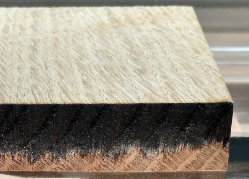

This is a 3/4" Red Oak board, and you can see the different depths the laser penetrated that correspond to the different densities of the woodgrain. Summer growth is faster and softer whereas Winter growth is slower and harder.
That is one difference that @dan84 was referring to between natural wood and a veneered core that is consistent density.
