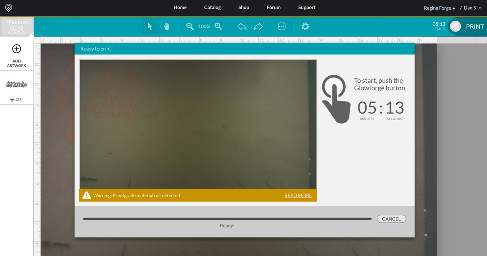

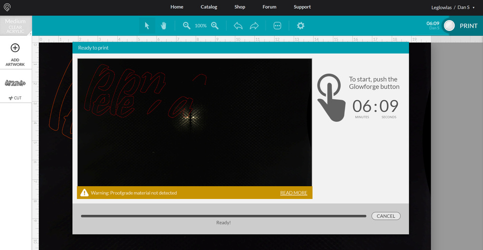

The Pro cuts faster by virtue of being higher power. (In some cases it also engraves faster, although in most cases power isn’t the limiting factor to engrave speed). Since speed and power have a nonlinear relationship that varies by material, it will be a little different from material to material, but here’s an example. I took a print my kids did last week (a sign that said ā€œpendant peopleā€ for a school project where they were selling pendants). I sent it to a basic and to a pro. You can see the cut time estimates.

I don’t understand how that works. If power less than or equal to 100 pews is the same and if speeds all the way up to 1000 zooms is the same so a 90/500 cut is reproducible for both and thus equivalent, then how does Full/500 get faster unless the zooms are not the same? For a given speed the Pro should cut deeper allowing a Pro to have a faster speed used than a basic but Full/500 shouldn’t be any faster on a Pro than a Basic, just deeper unless 500 zooms is faster on a Pro.
For any cuts at less than max speed, then I understand the Pro would be faster because you could bump up the speed since the power allows deeper cutting so for a given thickness you can use less power or more speed. I guess to some extent it’s an edge case where you’re cutting at max speed - like thin leather, paper, etc so a Pro might not even use Full power.
Or am I just confused? :slightly_smiling_face:
From what I remember of proofgrade settings, most cuts are done in ā€œfull powerā€ mode. Upping that would let you cut at a higher speed.
Agree.
I was just questioning the ā€œfull power cuts fasterā€. Really, it’s full power allows faster speeds to be used. So it’s only my edge case examples where we’re using Full power and max speed that we won’t see faster cuts - in that case it is likely we’ll need to dial down the power on the Pro because Full Pro is more pews than Full Basic. And if we do that, then the Pro will actually cut slower since 100 pews is less power than Full Basic.
So generally Pro cuts can be faster but there is a use case where the Pro will cut slower.
