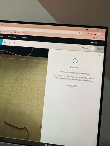

Its been 2 days and my passthrough stops working after the first cut. I’ve lost over $200 in material and orders trying to get my projects done. It even resulted in my printer head burning out while trying to figure out the issue. What is going on?!

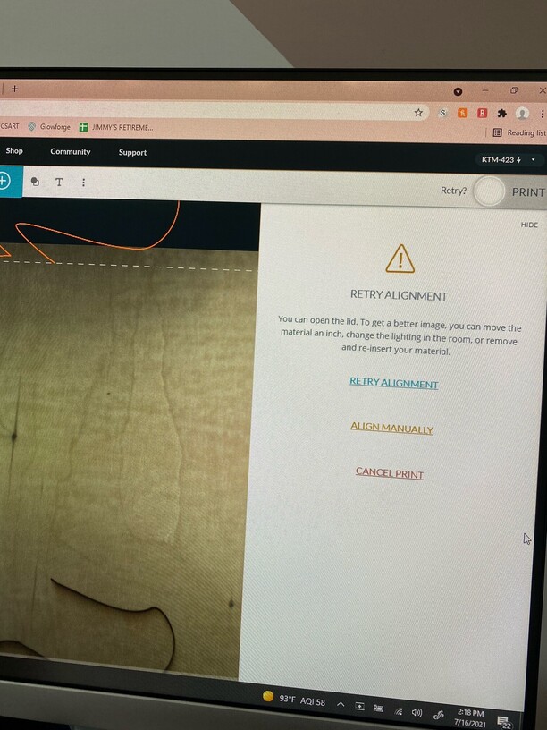

Printer head is fine and the mirror has been replaced, the issue is the alignment after the cuts are done.
See attached error messages I continue to receive

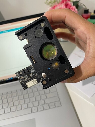

Hello @jess2 My apologies for any confusion. I reviewed the logs of your Glowforge printer and the errors I am seeing relates to an issue with the printer head itself. I do need to inspect the bottom of the printer head to move forward with the next steps.
I’d greatly appreciate it if you could send in a photo of the bottom of the printer head so I can rule this out for you.

Sure , bottom one seems foggy but not sure if that’s normal or not
Hello @jess2 That foggy lens could definitely be the cause of our problems. I just wanted to confirm that you already attempted cleaning this lens?
Yes, numerous times :pensive:

@jess2 Thank you so much for your photos and troubleshooting. I sent you an email with our next steps. I’m going to ahead and close the forum post and continue to follow up with you there.
