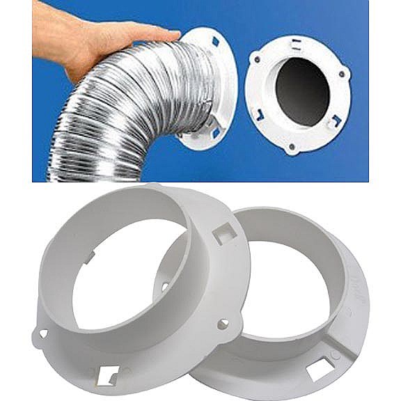

Not the option I am taking. I’m working on an idea for a semi-elaborate venting notion that allows me to vent outside the apartment without knocking holes in the wall/etc while I wait for the filter. I’m mostly thinking along the lines of a connector similar to going through the wall, but mount it where I can use magnetic clamping to pass through the screen without a hole and run a hose 4-6’ away from the slider. If I figure it out, will share photos.
I plan to create a device as pictured only I’ll use acrylic sandwiching the window screen and the the vent will attach with magnets. That way I can cut the screen from the center. I’ll have an additional piece to block the hole when the GF isn’t in use and it will also attach with magnets.
I’m thinking something similar, but I can’t actually cut the screen, so I was planning to have the magnets hold it so it vents through an intact screen, then through a hose on the other end.
Based on my experience with close dryer venting, if there is a mesh screen downstream from the GF, it is possible that crud is going to accumulate and interfere with the airflow. Depends on the size and quantity of particulates exhaled by the GF
Good to know. Venting through the screen will only be temporary. (That is why I got the filter.) The way I figure it, since I can detach the magnetic grip from an intact screen, I can clean the screen (after every use, if needed) until I get my filter and don’t need outside venting anymore.
Since Im working with a sliding door as well, my plan is to cut a spacer out of MDF that can be held in place by closing the door against it, then putting the vent through that. Pretty much how a window fan would be put into place. This way it avoids gunking up the screen. Plus, it’s really hot here now (100+ degrees) and the MDF will block slightly more airflow than having the screen open.
