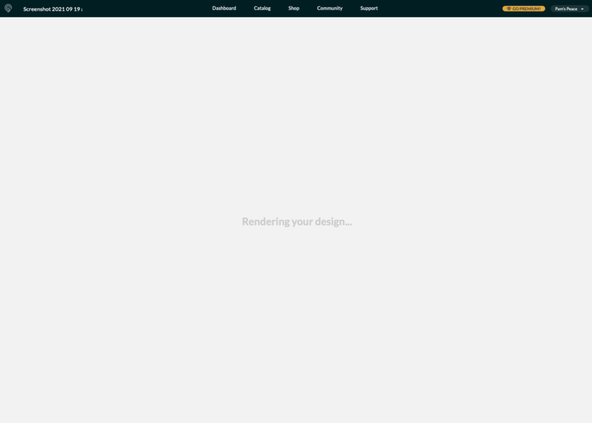

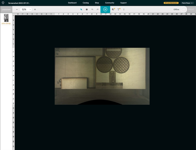

Well this is new one of many. Opened file in Glowforge software and the image shows up in the left list to program the machine but it doesn’t show up on the camera image for the machine.
Where’s my file. Opened this up many times. Restarted Safari, restarted my iMac. File is still not there.

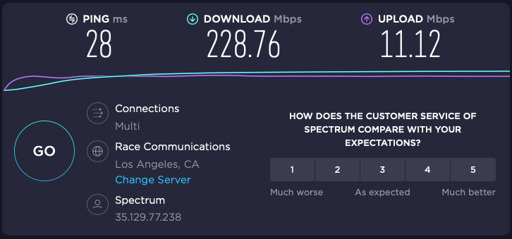

Speed of connection is fine.
It’s likely off to one of the sides. Click Ctl/Cmd + a - it should create a box around anything there, and then you can drag the box to your work area.
Also, for future reference, the speed of your connection doesn’t matter to the :glowforge: - it’s the stability. There’s no “buffering” in the laser so if it drops a packet then it’s gone and it has to start again from the beginning.
Isn’t it right between the circle images?
dog
I think that’s a previous run
Previous test. My file should be highlighted red and somewhere in the camera view window.

Zoom out and you should find it. I don’t know what software you use to create with but I do know with inkscape if you design outside the art box it will appear off to the side when you import it into the GF.
Why. I have 220+ download and 11+download.

That has little to do with it. GF needs a stable signal, not necessarily a strong one. Try the hotspot, if it works then you can be reasonably sure your wifi is spiky.

I send my image to GF to process and return the image on my screen in their internet software and the image does not appear on the camera image from the machine that is connected to viable Wifi, 220+mpbs down, 11+mpbs up, is not an issue on my side. Matters not what google says. This is GF on all accounts.
