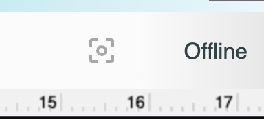

Unfortunately the focus button is grey. If I tried to set focus, it said ‘your Glowforge is Busy or offline’.

While waiting, if this happens again, try a different browser. What have you got to lose?
Hi,
Have you been able to figure out a fix? I am having the same problem and am extremely frustrated. I cleaned my machine, unplugged, restarted, reconnected to wifi … nothing!
I saw the comment about trying a new browser .. that worked! I just got a new computer and was using Safari. I downloaded Google Chrome and that seemed to do the trick.
