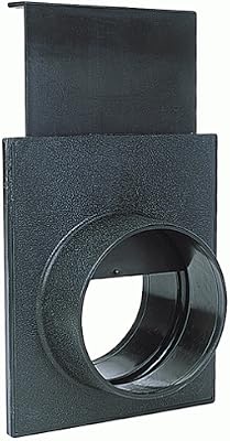

I hadn’t thought of back draft in the vent hose. Some type of back flow or blast gate will be useful in the setup. In my mind I just think of putting the hose into some type of fixture that fits the window opening and I can remove it when I’m not using it. But say if I am operating for a long session, would make sense.

Unfortunately insulating the tubing will actually prevent the air inside it from being warmed up just as much as it will prevent the air outside the pipe from being cooled off. It might take some creativity to come up with a system that prevents -30 air from making it to the Glowforge (or cooling off the room too much, or creating a big puddle of condensation on the floor below the pipe), while not also requiring an explicit action by the operator before lasering something (like a manual blast gate would). The always-on low pressure fan would work, but my inner tree-hugger cringes at not trying to find a more passive method first! :slight_smile:
Agreed… I didn’t mean to suggest that the tubing itself be insulated. Most dryer hose is not insulated at all. What I meant was in having a properly closing vent flap with proper seals around the hatch itself to block cold air. And when I commented about an always-on low-pressure, I really mean very low pressure. We’re talking about a night-light worth of electricity. :slight_smile:

We haven’t tested for freezing cold air migrating back up the hose - while the GF is cutting you’ll be fine, but when it’s off, you may want a blast door to seal it off or dryer flap or somesuch.
Sounds simple enough. Something like this should work if you want an extra in line damper in addition to the dryer flap.
Or if you want something more robust…
Blast gate–$2.99 with free prime shipping as an add-on…
