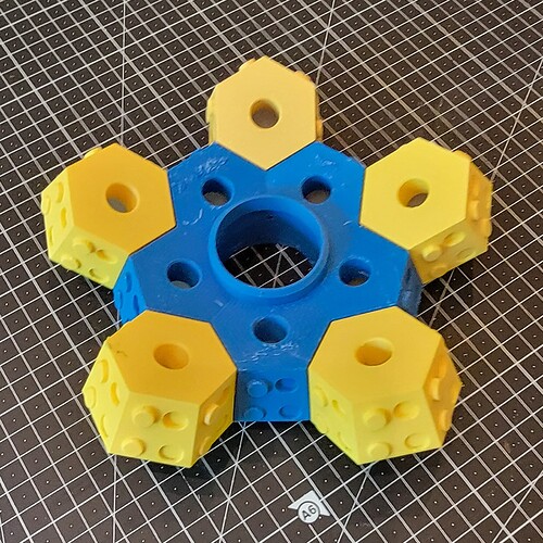

Each part uses 3 colors of PLA filament and has a 1/8" indentation to house the laser cut faces. The LED pixel bulb pressure fit into hole from behind.
Assembly:
The bottom 5 blue faces are a single 3D printed part that rests on lamp light socket. The only parts that are glued together are the first 5 connectors on the bottom lamp base. Everything else is pressure and fits together with much satisfaction.

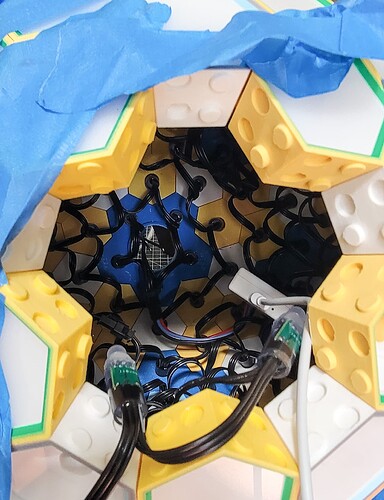

Lights added in circular pattern from the bottom. 161 pixel lights.

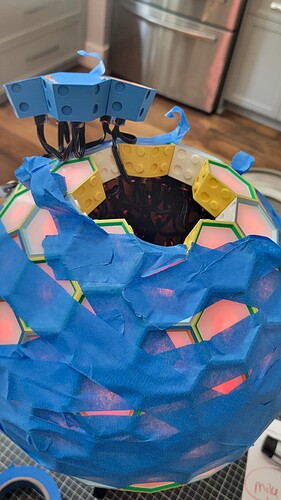

Last 6 pieces were 3D printed with flat external faces to make it easier to snap into place. Tape used to keep shape together during assembly.

Yes, there is a bulb socket adapter that I plug in a USB-C power brick which then goes via a 6-in USB-C cable to the WLED controller. From there, the bulbs are wired in a circular pattern all the way to the top. I thought about wiring it so that all of the different color faces are in sequence, but that would require some splicing and it would probably break a lot of the built-in effects. To get custom colors on the different faces you can use segments in WLED, but mine has too many faces for that to work properly so I gave up on the idea of lighting each face based upon the color that it was.
The Pixel bulbs that I bought come pre-wired in strings of 50 that already have the appropriate wire connectors at the ends. I think most people use these types of lights for outdoor Christmas lights and light shows because they’re meant to be outside. The individually addressable pixel lights work great for these custom polyhedrals that I’ve made. This is only my second one
