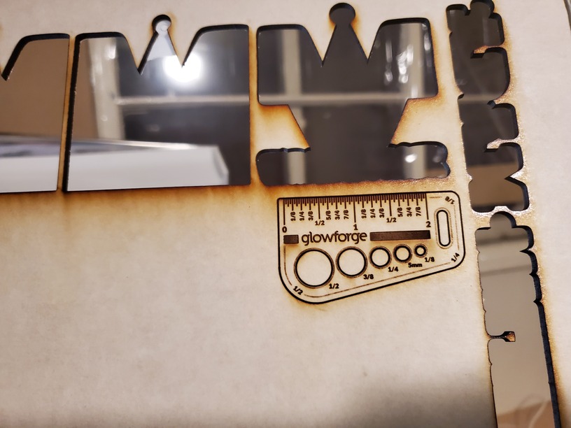

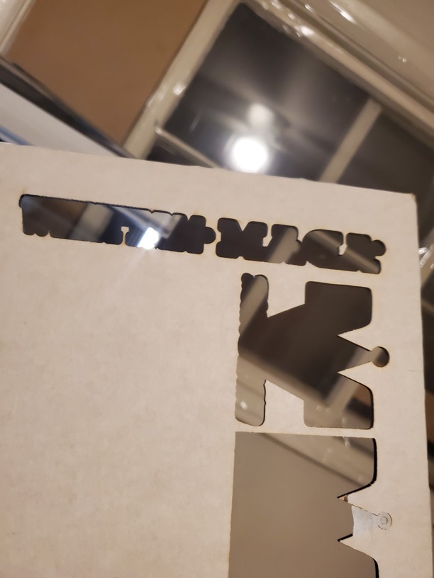

Got my pro on the 22nd and first few cuts were great and then stopping cutting all the way through medium draftboard. I’ve cleaned all the lenses and mirrors and they are in correctly, I checked twice, nothing on the crumb tray, and board in not warped. The engraving is fine but cutting all the way through is the problem. To get it to cut all the way through I’ve had to lower the speed and cut it twice and even then some spots dont cut all the way through. What could be causing this?

Unshielded magnets hold the work in place very well but the magnetic field above them wrecks havoc with electrical currents and especially the head fan leading to looking like this…
If the fan gets gummed up it will not blow strong enough which causes the smoke to occasionally ignite and when that happens it blocks the cut and makes a lot of burned mess above. If you are getting any smoke ignition where that happens will cut badly.

Support will need pics of the front and back of the GoGM printed on medium draftboard using default settings.

On your very first cut, were the engravings any more legible? It looks like you are out of focus.
When the issue started it was like the 6th thing I ever cut on the machine, the same day I unboxed it. First 5 cuts were perfect then it stopped cutting all the way through. The issue started before I ever removed the lenses to clean it.
