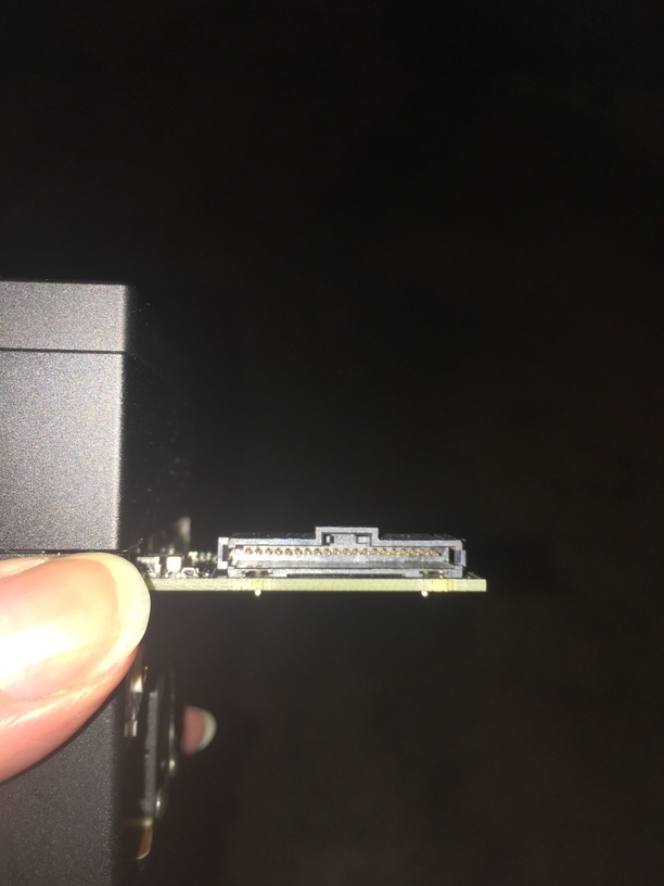

I’m so sorry for the trouble. The logs are currently indicating that the unit can’t communicate with the head properly. Can you try the following steps:
Turn off your Glowforge.
Holding only the finished black surfaces, grasp the printer head as shown. Pull gently up and back to disengage the magnets and remove the head.
There is a small tab in the center of the wire ribbon. Push down fully on the tab to release it, and gently pull the wire ribbon plug from the printer head.
Take a clear photo of the gold pins inside the printer head where you just unplugged the wire ribbon. It should look like this.
Pick up the printer head and wire ribbon. Make sure the tab on the wire ribbon is facing up. Slide the ribbon back into the head until it clicks.
As shown, lower the printer head over the metal plate so that it rests next to the two round posts. Then push it gently away from you – you’ll feel a “click” as magnets pull the printer head until it sits snugly atop the metal plate.
Turn your Glowforge back on.
Send us the photo of the gold pins from step 4.
Then give it another try, and please let us know the results.
I tried to run another test of the “gift of good measure” and still the laser is not firing. Tried running at 7:05pm CST. I have video of the unit trying to work…everything looks like it thinks it’s working, just no laser.
Thanks so much for taking the time to do those tests and post the photos. Unfortunately, it looks like your unit is experiencing an issue that we can’t resolve remotely. I want you to have a reliable unit, so I’m recommending we replace this one. I’ll be in touch via email to sort out the details. I’m so sorry about the bad news.
