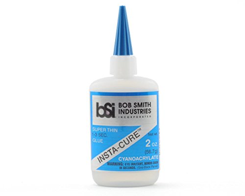

Whoops! Put the wrong link in there…that one is for gap filling…
As i was saying before I deleted the post…don’t use the little tubes - they’re too wasteful. This stuff is thin enough to flow down into the woodfill and bond it:
Also, if you don’t use a lot of CA glue you can extend its shelf life by keeping it in the refrigerator. It is also something to be careful with, as some people can develop a sensitivity to it which is no fun at all.
Also is very important to keep the nozzle clean of glue, or the next time you need it…
Does the CA need to be brought to room temperature to set properly or have you noticed no difference when using it directly from the fridge?
Agreed!
Yes, probably for the best :grin: Also, make sure the bottle is free of condensation, as moisture will act as a catalyst and speed up the set time.
