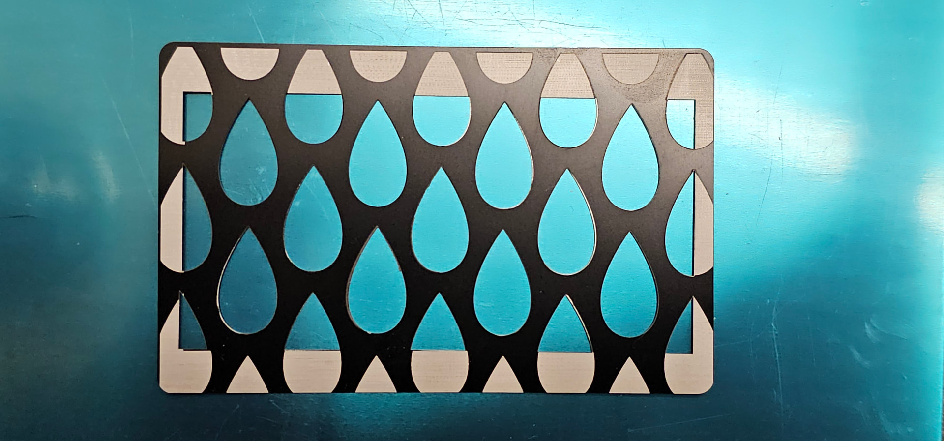

This is an anodized aluminum business card that I engraved (the border) and cut.

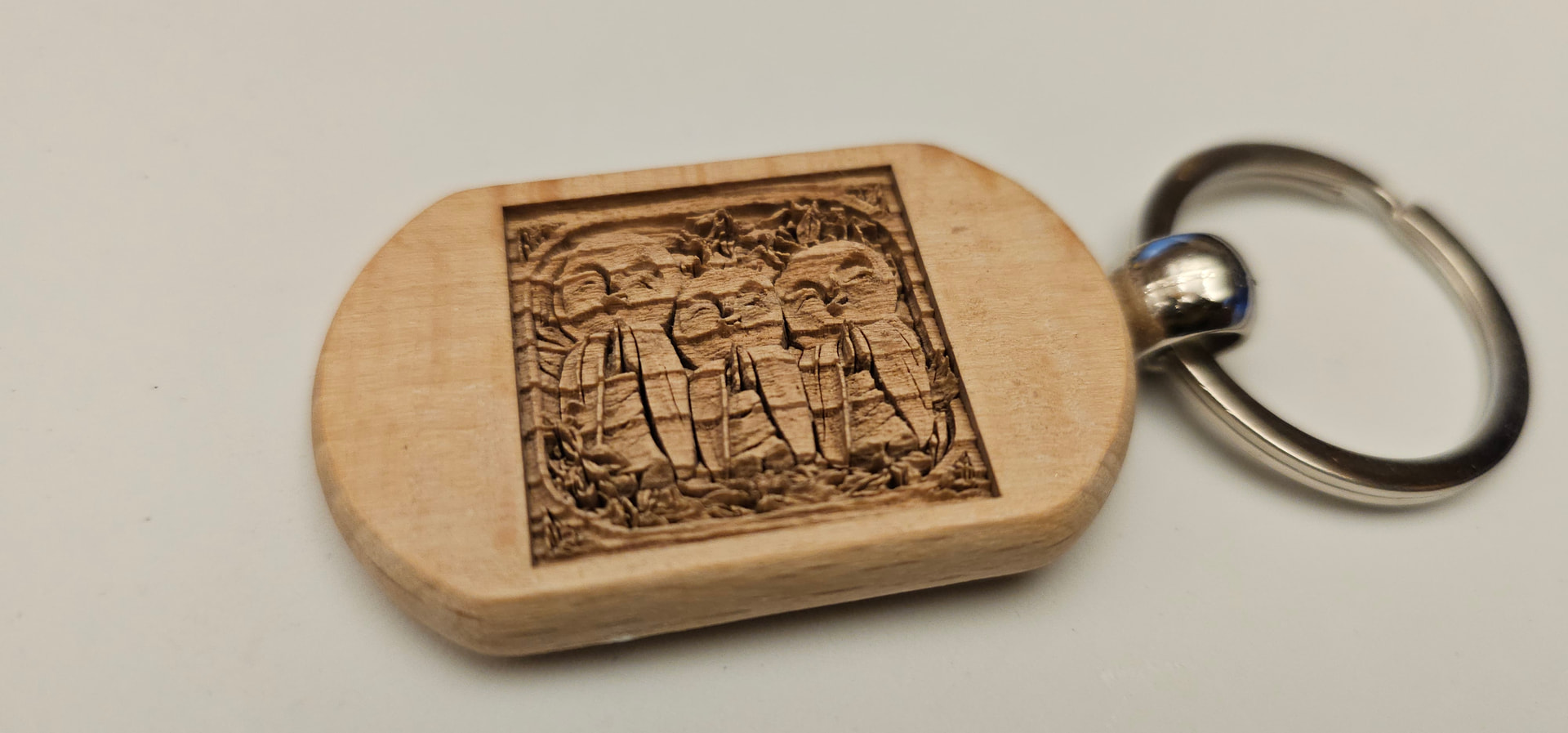

A keychain with a detail emboss. I need to get my hands on better wood, but the detail on this is insane, without a bit of char.

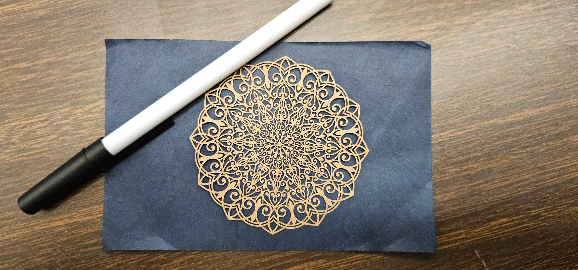

A mandala on kraft paper. It’s about 2.7” in diameter. I taped the paper onto a piece of wood and started lasering. All the little bits shifted around and I was sure it was a fire waiting to happen, but nope.

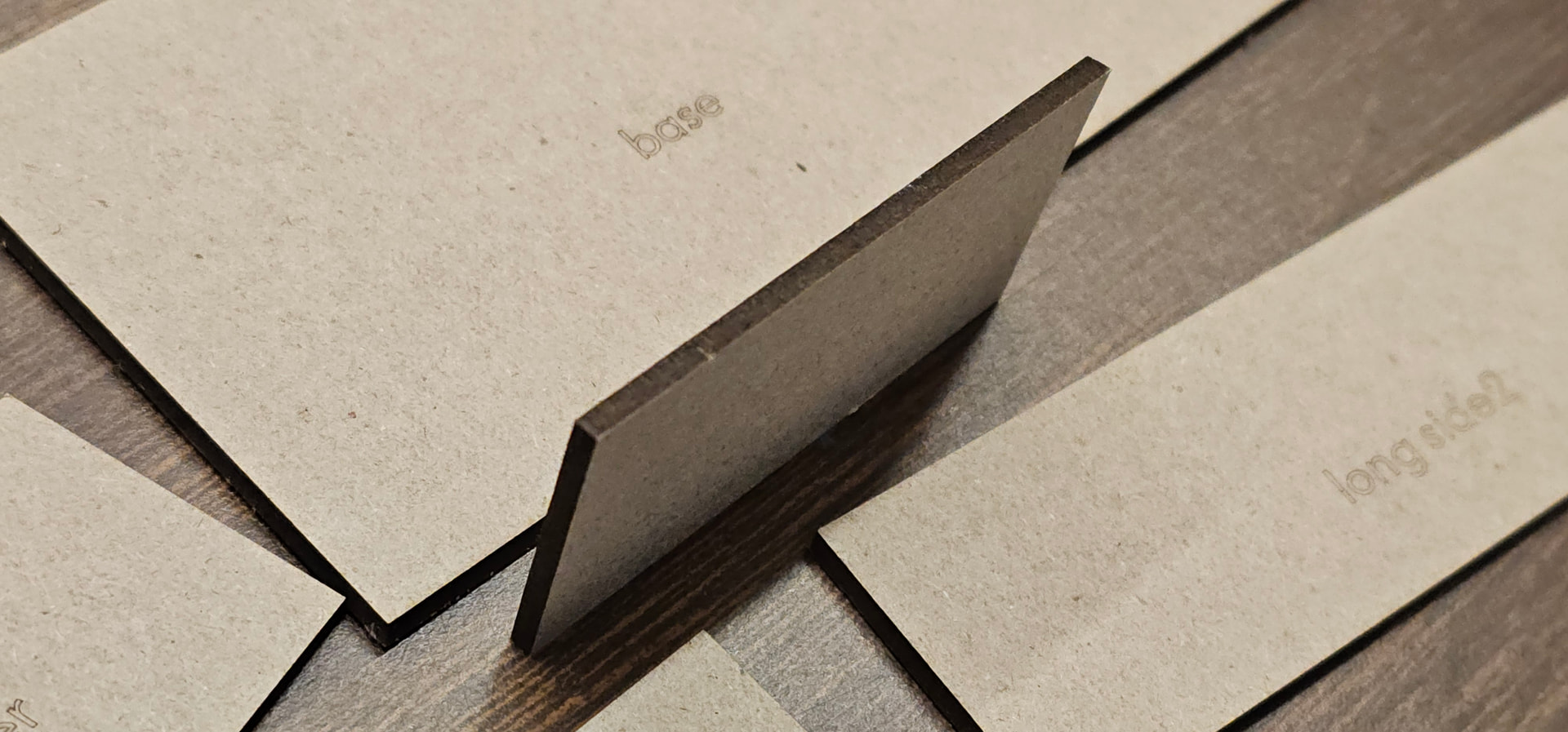

And… bookboard. This is the reason I got a laser in the first place, but it was too hard to cut without charring. These cut beautifully, without any char at all.

It cuts aluminum?
This is a 5W uv laser yeah? If that’s right the tech must be so different from co2 lasers. It must be an efficiency/wavelength thing?
I think it’s pretty easy, especially for laser people, but I suppose it depends on what you’re trying to do. It’s defininitely not a machine that needs tinkering.
@evansd2 This is very thin aluminum, but yes, the technology is very different. It has a frequency setting, which I have yet to touch. Basically, the lower frequencies are better for hacking away at a deep engrave/cut, while the higher frequencies are better for fine engraves. The whole concept of a “cold laser” is a mindset shift. People are lasering feathers. I’m going to do some rice paper later and see how it goes.

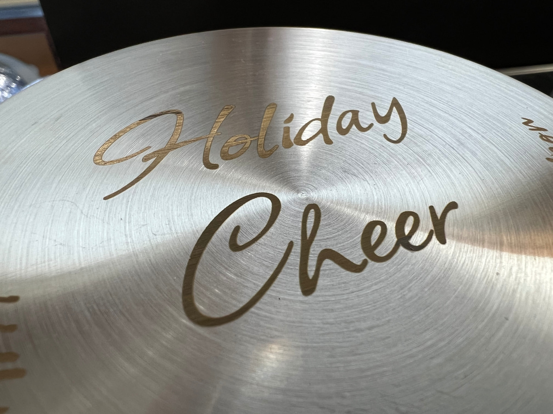

Within days of unpacking mine, the very first thing I attempted was to see what it’d do with stainless steel. Honestly had zero idea what a UV laser could do here given the posts I’ve poured through on all the steps needed to prepare a metal surface for marking with the Glowforge.
With a dollar-store gift jar, I took its stainless steel cap and centered it on the platform. Just used the default power setting for stainless steel. The laser sizzled its way through and within a minute or two there was some proper no-fuss engraving on metal! It was definitely engraving as the original brushed texture went bye-bye.

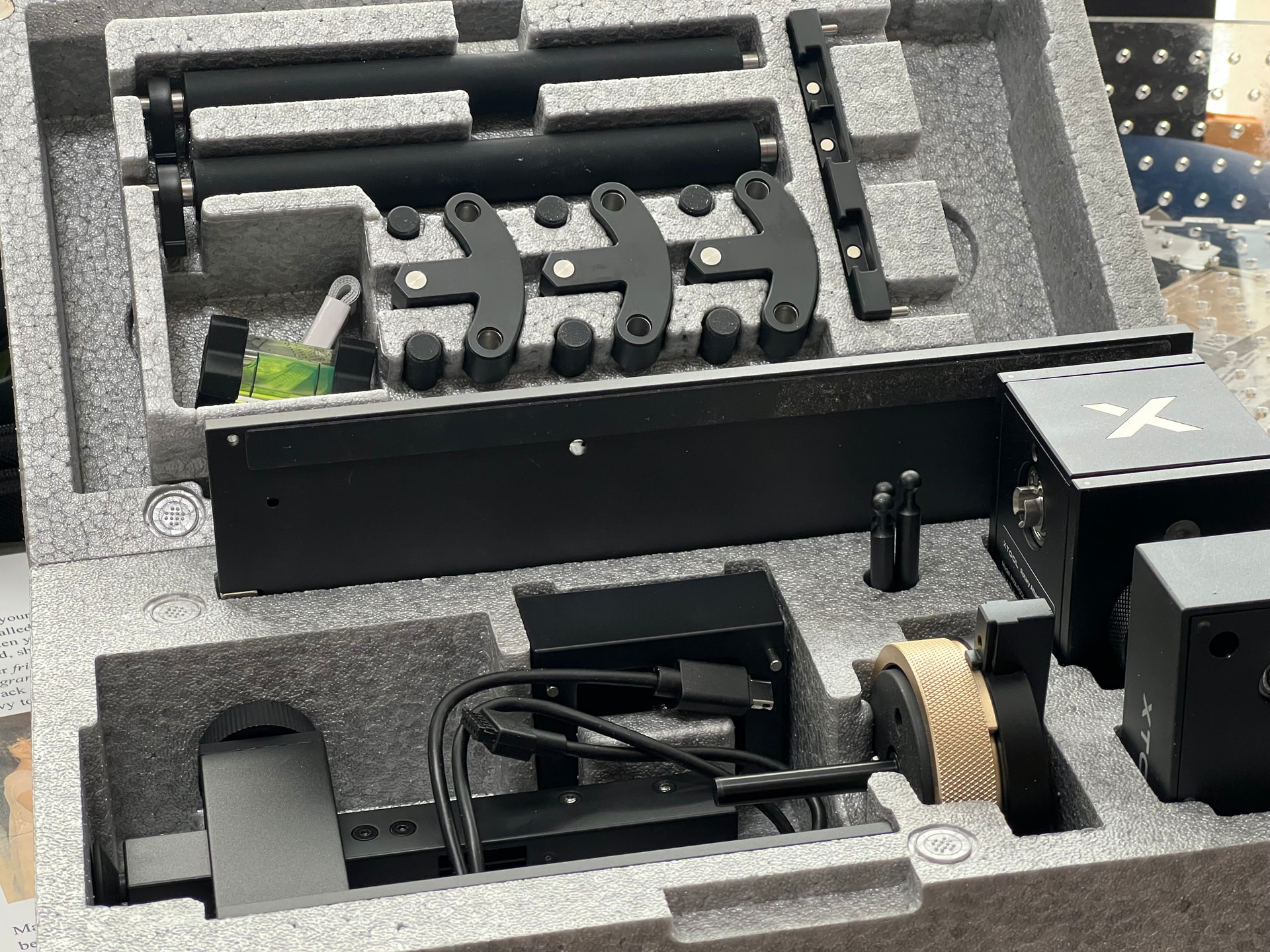

I chucked the glass jar onto the RA3 Rotary Accessory. This add-on itself is a nice piece of gear. Cleverly modular to shape-shift into a myriad of configurations. Capable of holding a variety of things from its inside or the outside; tumblers, mugs, drinking glasses, rings. Many of its parts slot-in and locked into place with a captive magnet instead of endless thumbscrews. Shown here disassembled in a foam storage case. Did a 70% wrap-around engrave on the soda-lime glass and was equally astonished for a first-time attempt.

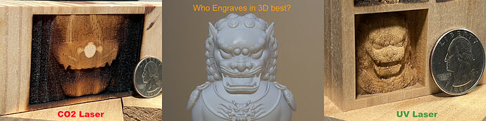

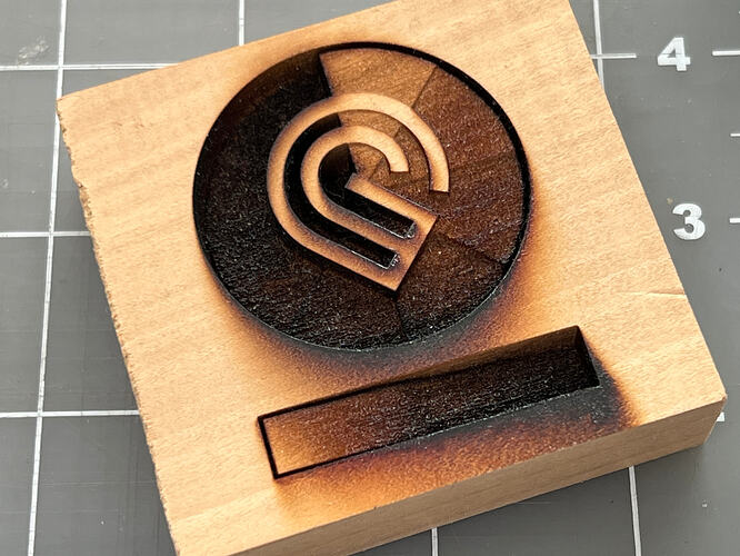

A bit later on when time permitted, I investigated its supposed ability to do “3D Engraving”. Years ago, I ran through a Glowforge session trying all sorts of settings with this goal in mind. The old-timers here all remember the original marketing showing 3D depth engraved pieces. That huge delay following the launch of the Glowforge was partially due to the effort perfecting their power supply… presumably for the variable power planned for 3D engraving. A controlled test using graduated greyscales got me to this result:
With my Glowforge Pro’s max power and duration, it engraved down to 4.5mm with a propensity to catch fire at that point. Despite all that charring I pressed on and tested two height maps several times trying to dial-in a better setting. Never got anywhere near the marketing hype.

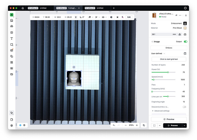

With the F2 Ultra UV, their approach with a height map image was to peel away material layers at a time instead of trying to blast it into oblivion in one go. This screenshot shows it planning for 250 layers and the other settings based on one of their pine presets.
The end result and comparison? XTool delivered. Keep in mind this test is based on a POSTAGE-STAMP sized engrave. Despite the macro shot of the wood grain; teeth, fang, furrow bumps are visible. That final layer reached a 5.9mm depth. And yes, all this without a hint of charring. Zero processing/clean-up needed. “Cold laser” indeed. CAN I make the UV laser char? Yes, crank the power and duration numbers high enough and it starts to look like the mid-point of the Glowforge controlled test. Had I done a larger 3D engrave, the wood grain would be less detectable.

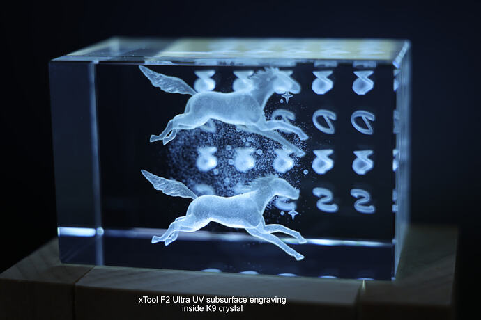

Those who watched to the very end of the sculpting vid posted the other day saw the XTool F2 Ultra UV doing it’s subsurface engraving thing.
A number of things was learned in sacrificing a block of K9 glass for testing.. whether detail or engraving time changed comparing a decimated 3D mesh versus its full-fat original.. and on the backside, a comparative study on the effects of different subsurface settings.

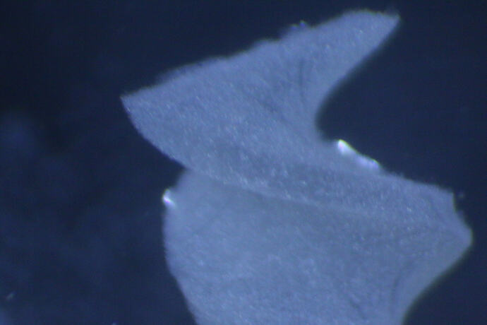

Subsurface engraving works by precision-focusing the laser on a certain volumetric spot and creating a micro-fracture. My testing showed the laser offering a cushioned range of leniency and the engraves stayed mostly the same. Under the stereo zoom microscope, only the highest UV power setting I was willing to go showed signs of over-fracturing…
YouTubers who have pushed their subsurface settings far more than I was willing to go ended up fracturing (destroying) the ENTIRE block… so to anyone who’s eager to chime in about NEEDING a 20 watt version; spare me. The XTool F2 Ultra UV’s 5 watts can already do plenty damage enough when misused.
