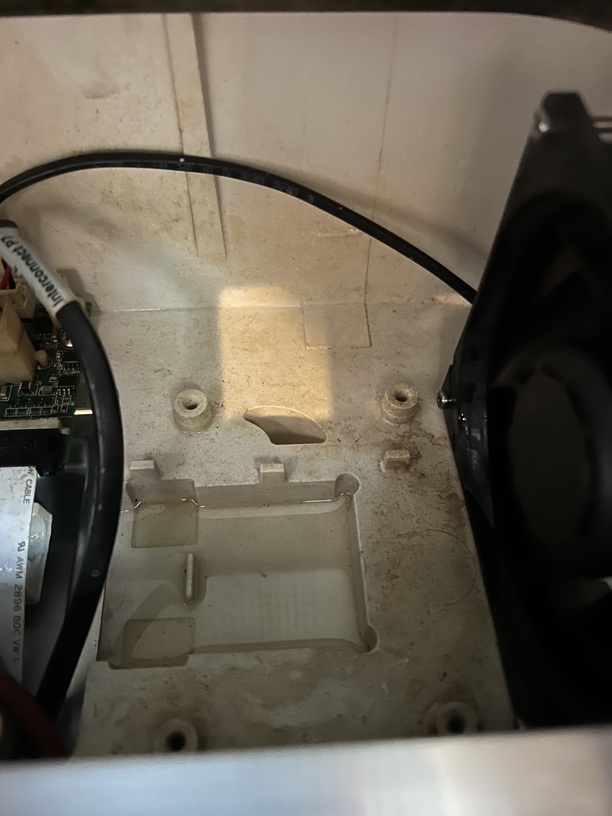

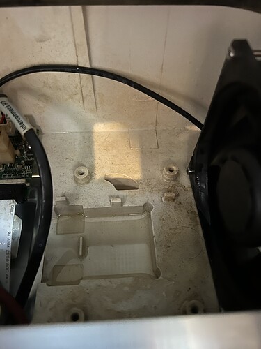

Yellow light came on yesterday and the machine said home. Was able to get it working again. Turned it on today and started cutting. Within a few seconds yellow light came back on, says cooling and in this little reservoir in front of the exhaust fan there is clear liquid pooling. Could it be the laser tube coolant?

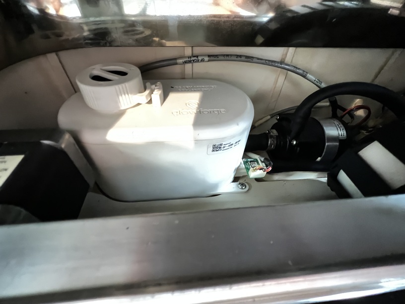

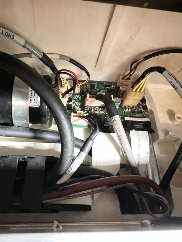

Take a close look around the pump that connects to the tank. Where the hose leaves the pump would be my suspect, because the pump slightly pressurizes the flow there. Mine doesn’t have it, but I have seen a picture of a newer machine that had a band clamp on the coolant hose. There would be a reason for that modification.
See any tiny bubbles in the tube? That would indicate a low level in the tank.
I’ll have to look and see if I can figure it out. We just got this one as a replacement because I had a problem with the last one. This is the 3rd machine in 2 years. I did notice bubbles on the beginning when I first used the machine but I thought that was just from it having been shipped and moved around so much.
That’s right. They all have air in the tube at first, and it purges in the first minute of powering on. If the tank is low there will be a stream of tiny bubbles that don’t go away.

The vent is not connected to the outside when the machine isn’t running. It isn’t condensation all over. There is just fluid in the one spot in the picture.
