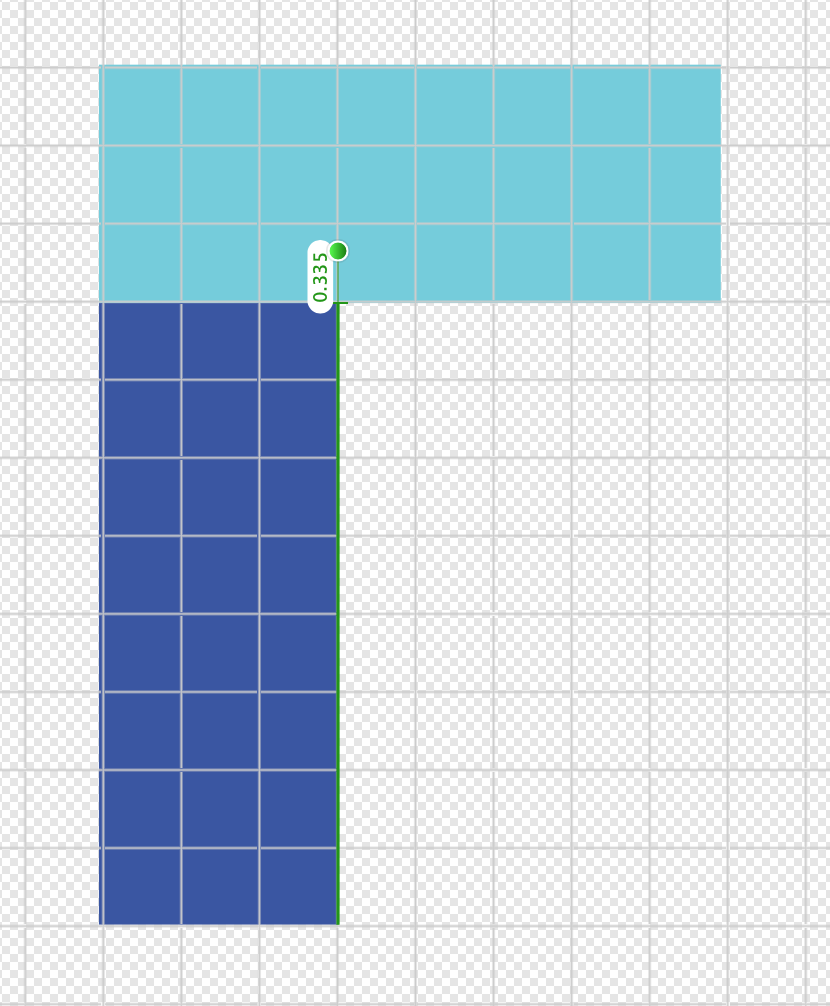

You have to choose each rectangle in AD and ‘add’ them together first. Then export as a PDF. Here is one I just made, showing it on the GF bed.
Here are two rectangles…two different colors.
highlight both of them and ADD them
Screen Shot 2021-11-19 at 10.11.43 PM
They will be combined into one thing

I just tried this but its still filling the square in the middle. I kept adding each rectangle then just saved and then exported did the checkmark on export and it still did this. What am I missing?
Thanks. I’ll keep trying
ok got it thanks it finally works! I reread your instructions and exported as pdf. Appreciate you taking time to help me! Trying to learn as I go.
