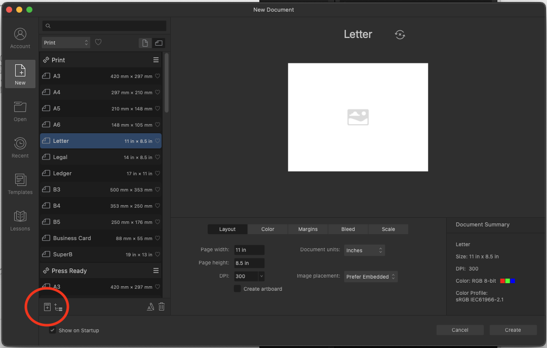

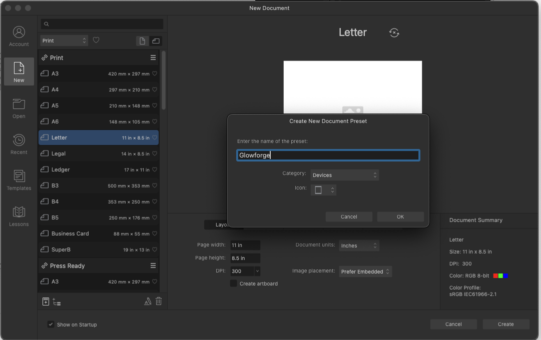

On all the devices I’ve installed Affinity products to, I’ve added a Glowforge Preset. If not already opened, select File > New and be sure the left column is on the New tab. (not Open, Recent or Templates) On that dialog, bottom left has a button to Add a New Preset
After giving it a Glowforge name, I like putting mine in the Devices Category…

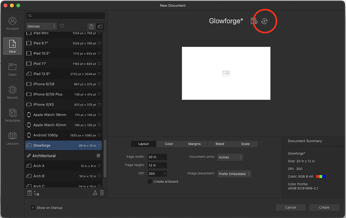

For my preset, I set the Page width to 20 and height to 12 inches. I don’t believe DPI matters. Margins set to unselected. Artboard unselected. That’s all that’s needed. Find the circular icon next to the preset’s name, that’s the Save and Overwrite icon.
Anytime I’m starting a new Glowforge item, this preset opens a document that gives me a rough bed size to work from. YES, the actual machine’s bed size is marginally smaller than this, but visually it’s served as a very reliable canvas for me. (Pro and Basic machines, not sure ‘bout you Spark and Aura users)

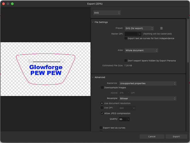

When I’m finished and ready to make the Glowforge vector object, in Designer it’s just a matter of going to File > Export to bring up this dialog. In the top pull-down select SVG. I don’t think I’ve altered much else under the SVG for export Preset pull-down. Raster is left blank. Export text as curves is activated.
I’ll save my SVGs in a organized Glowforge Prints folder and when loading them into the browser interface, there has been ZERO need to ever fiddle with its scale. A 1-inch rectangle I’ve created in Designer ultimately cuts as a 1-inch rectangle on the Glowforge.

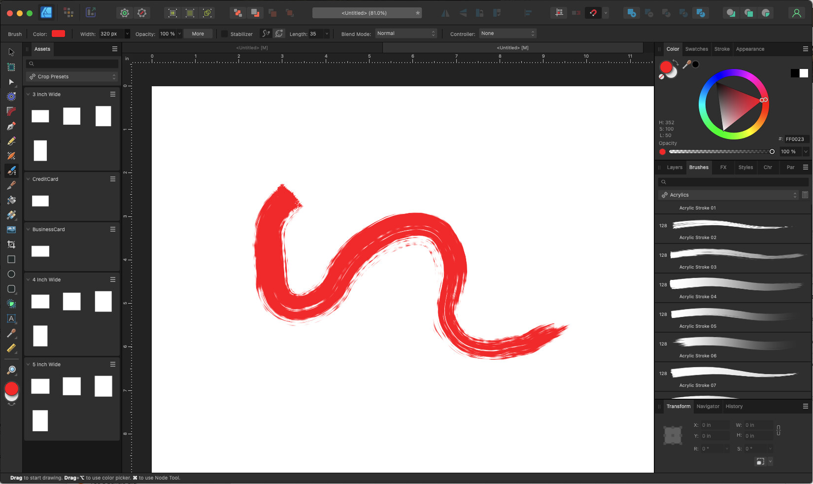

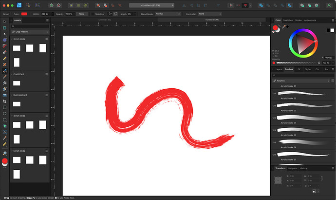

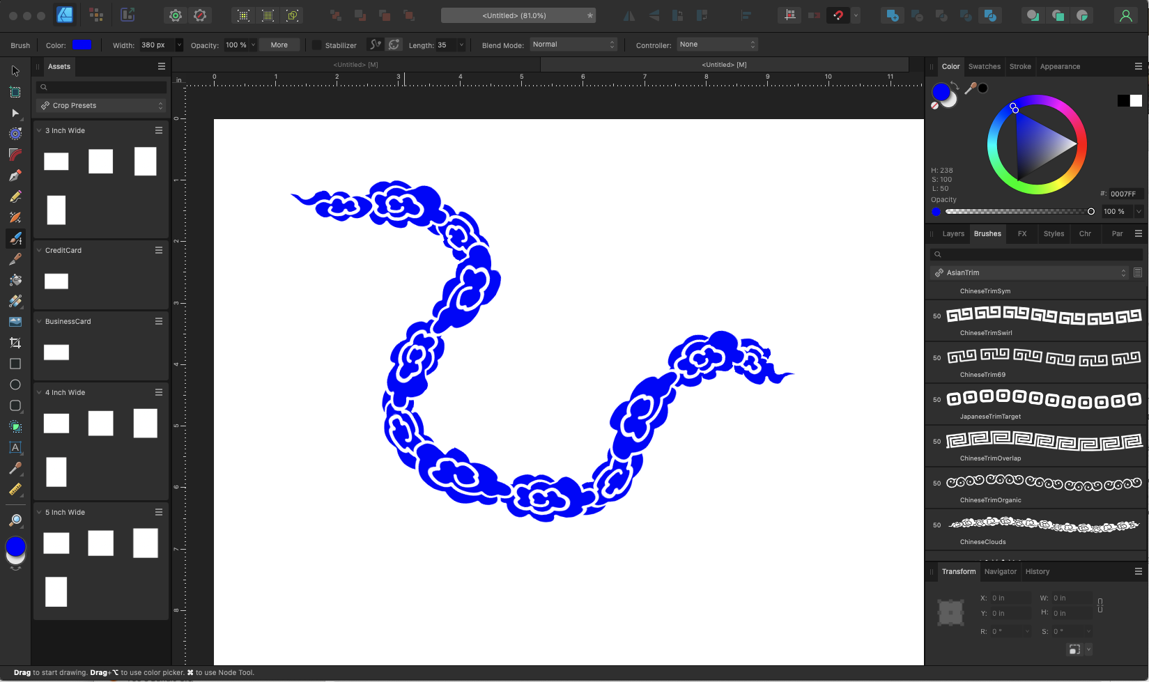

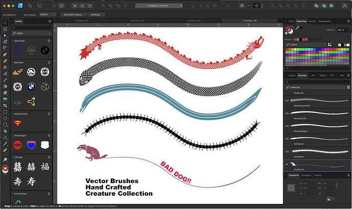

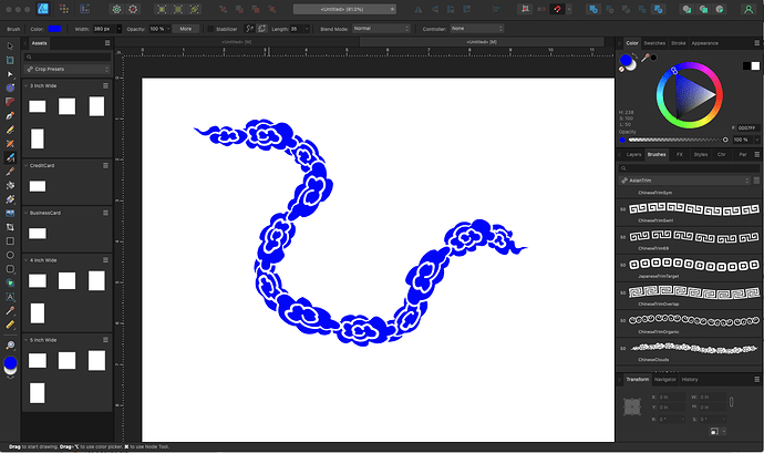

As to stuff I found cool about Affinity, one of them was Vector Brushes. Laying down a brush stroke in traditional pixel-based apps (ie, Photoshop) meant the stroke was fulled baked. In Affinity Designer’s Vector Brush, what looks like a stylized stroke (ie, loaded with acrylic paint) actually remains as a CURVE with NODES that’s re-adjustable… exactly like any other Bézier curve.

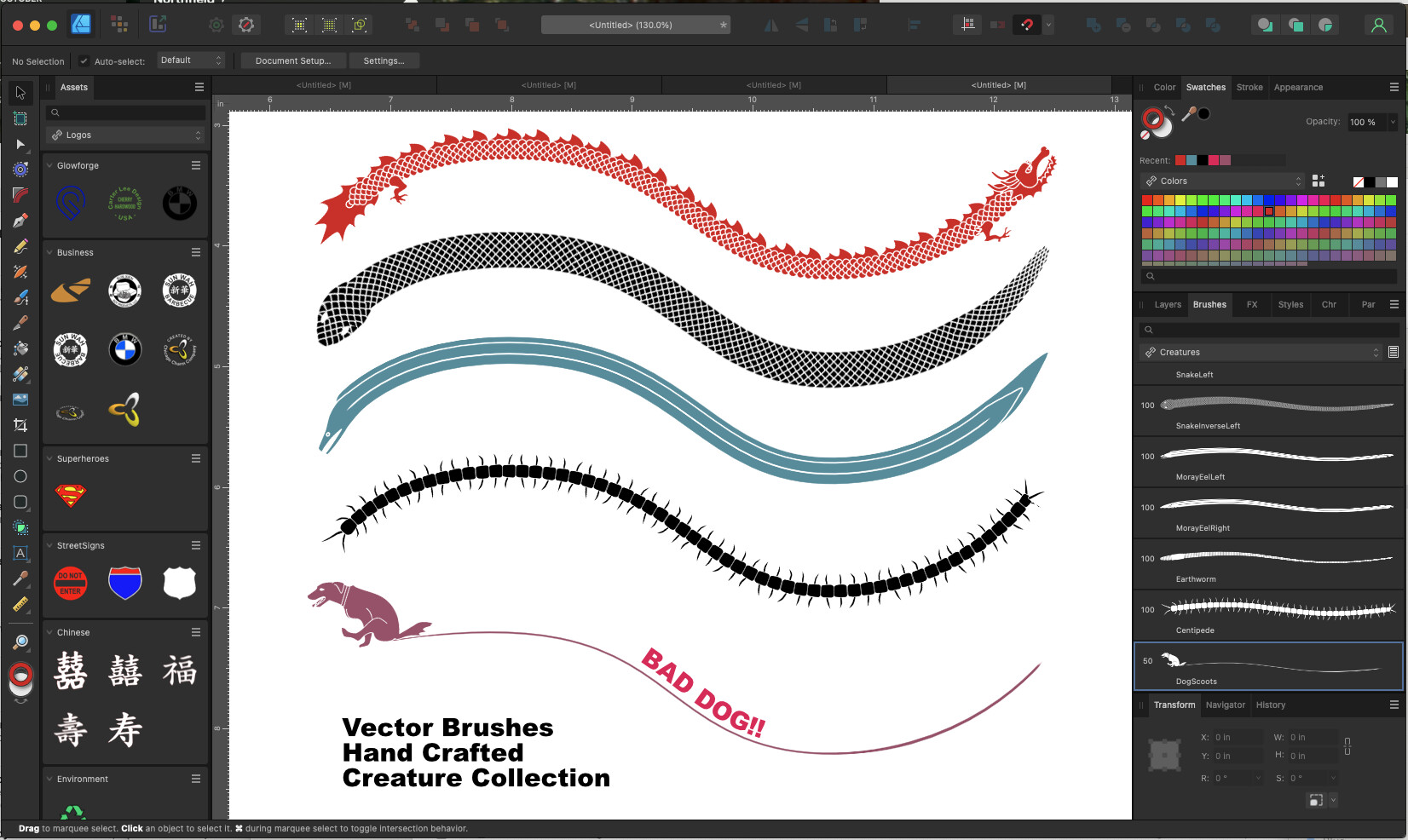

While there’s a large included library of these Vector Brushes subcategorized into Acrylics, Oils, Pencil, Engravings, Patterns, Watercolors, etc… the REAL power of this is the ability to create my OWN set of custom Vector Brushes like this new self-made category of Asian Trim:
In this “stroke”, I hit the Node tool (or tap “A”) where the underlying bezier skeleton is revealed allowing me to change the curve in any possible way and even it’s “thickness”
It’s been a great way to make engravable borders (because it saved as a bitmap) but with Affinity’s announcement today, they finally have vector tracing, so this final stroke ought to be convert-able back to a true vector for cutting/scoring as an SVG.
For the faithful Affinity Designer users, I give to the community… Asian Trim Brushes:

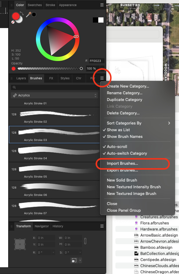

Unzip it into the file “AsianTrim.afbrushes”. To install it in Designer, find the “hamburger icon” located in the Brushes panel. You’ll find the ability to Import Brushes there. To use it, Affinity Designer invokes it with the “B” keyboard shortcut.

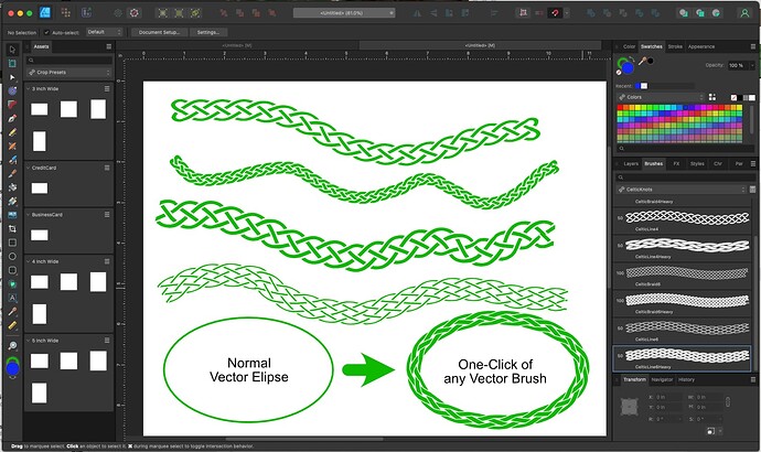

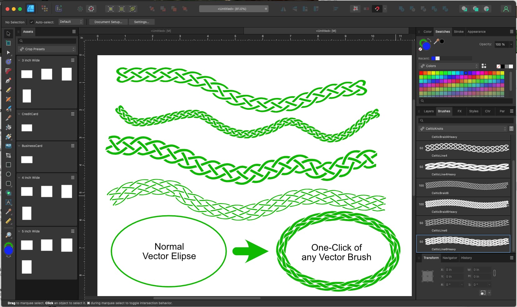

Doesn’t have to be an open free-hand curve stroke either. Drag out a standard Elipse shape, with it selected, click on the Vector Brush… or another Vector Brush… or another Vector Brush. Fancy and instantaneous border trim all day long…
