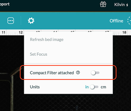

I have no toggle, maybe if it had a way to set it it wouldn’t to blowing smoke out at me.

Click on this setting to switch it on, like this:
That disables the exhaust fan that’s built into the Glowforge, allowing the fan in the filter to do the work instead. (If you ever detach the compact filter, be sure to change this back!)

Thanks, Tim…I was just going to post the same screen shot. :slightly_smiling_face:
