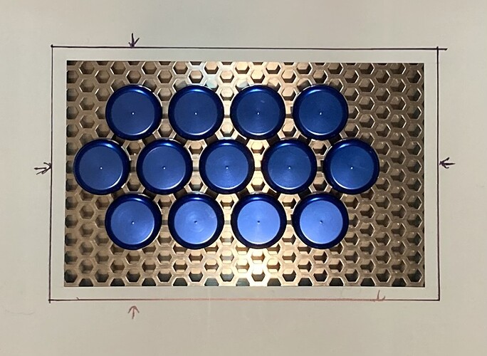

Just starting out with a Glowforge Aura. . . I am trying to optimize both a simple design, and the process for accurately engraving customized emblems with a high degree of repeatability. Is there anyone near SW Ohio who is proficient in both Inkscape & Aura and might be willing to help me onsite for a fee? Alternatively, we could interface via Zoom if necessary. - Dan Bailey

Don’t need a jig, as the emblems lock perfectly into the honeycomb. I want to engrave 13 of them in a run, and text is different for each but art is the same. A template for the run is needed, but one in which I can easily customize the text for each emblem.

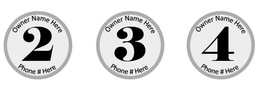

Attached are pictures of the emblems situated in the Aura, as well as the sample graphics to be engraved. The number on each emblem would vary in a given run, while the name & phone number would be the same.
Just out of curiosity, what are those emblems made of? They look like plastic or anodized aluminum. From looking at what you want to do, I think you DO need a jig for alignment.
They are anodized aluminum and used to indicate the loft and ownership of individual golf clubs at the grip end. (patent pending) They do not move once their posts are inserted into the honeycomb and can be placed in the exact same spots with each run. Unfortunately, aligning the graphics quickly & easily has been a problem so far; although I just learned how to position by metric (instead of eyeball) on the Aura, and that should prove helpful.

This is just about the same project as one I did with my Glowforge a couple of years ago as I personalized golf ball markers. The reason a jig works, is because you align the artwork in Inkscape and never have to worry about it being centered when you engrave. The jig is simply circles the size of the club finders with the text centered.
Do you have the Premium subscription? If so, draw circles around your emblems as they are placed in the bed. Export the file. Open the file in Inkscape and add your text, utilizing the alignment tools.
The reason for a jig is not to hold the material, but to enable precise placement of the material and the design in a repeatable manner. It is great that the emblems fit perfectly into the honeycomb, but that is only useful if you can create your file to accommodate that exact placement.
