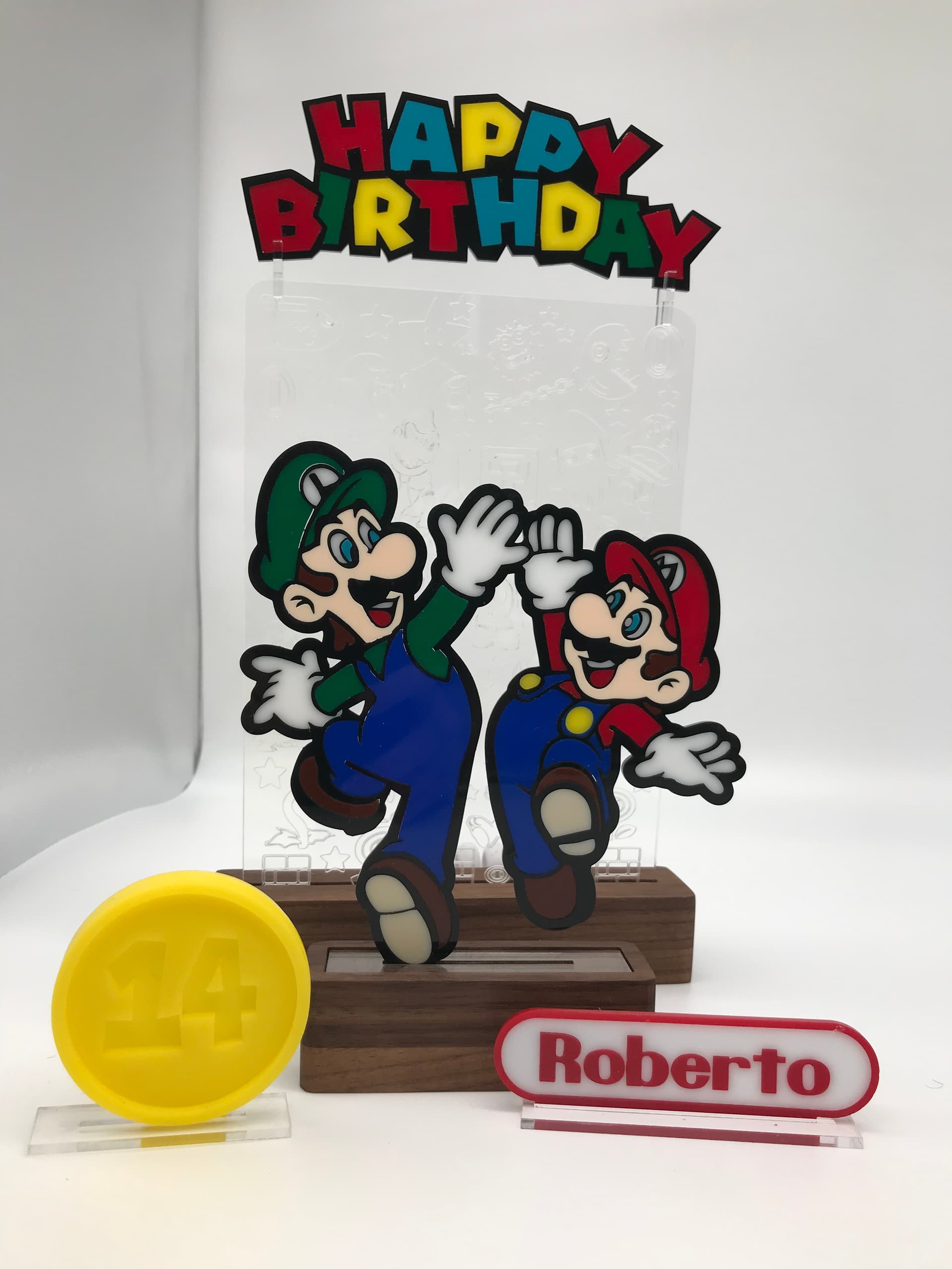

A counterpoint here is that I do very intricate cuts with kerf adjusted inlay that snap in, and I have found that often more anchor points help especially on “long stretches” or around curves. The added anchor points appear to help the machine cut very specifically on the line, so that the inlay slots in well. I haven’t done a full science on this. It might be related to how quickly the laser cuts on straight vs curved paths, and the colors of acrylic I inlay (I think some colors cut hotter, ergo more melt?) so for now, it’s been a lot of trial and error, and at some point, I’ll try do a science on it all and figure out if there’s a more organized way for me to get the inlay to cut precisely correctly the first time - based on colors and charts. :slight_smile:

Glad to share a few. Here are some random things I made - used as cake toppers for friend’s kids usually. :slight_smile:
I assume those are acrylic in lace? That’s inlay on hard mode because the material is so unforgiving, so good job. I also don’t see any marks of glue which is also impressive.
Yes. 1/8" acrylic. Thanks. I get a little bit more insane each time. How miniscule can I get a cut. I have to put a bit of card below the acrylic when cutting as some pieces are so small they fall through the grate. :slight_smile: I’m having so much fun with this. Specially making cake toppers for friends. I do actually glue the inlay bits in, although they usually snap into place tightly. But as these are going on a cake, I don’t want something to accidentally fall out and a child swallow it. :slight_smile: Right now my project for neighbor boy is a mash up of spiderman and Link from Zelda. Having fun with that, and am working on curves and that’s why I looked up this topic on Glowforge, as I decided I really needed to sort out for once and for all the science of this. :slight_smile:
