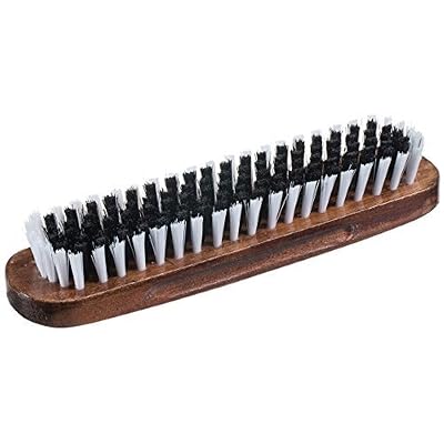

A medium bristle clothes brush is good for larger pieces - this is the one I use. It’s not available on Amazon anymore but something similar would work:
