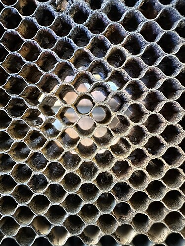

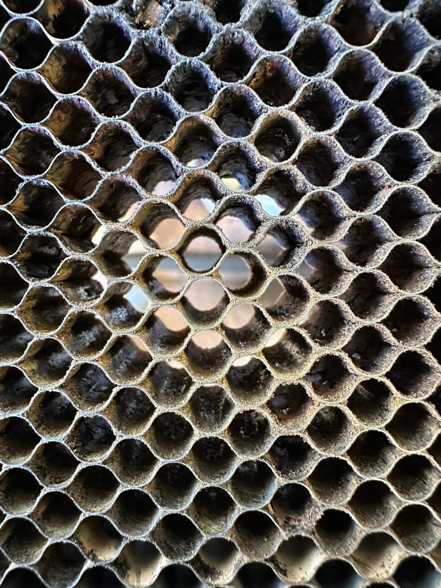

So, I have 2 GF’s and 5 crumb trays… The materials I cut have lots of resins and junk and several of the crumb trays had been retired because they were lost causes. The honeycomb was hopelessly clogged up, creating lots of flashback.
I had tried everything posted on these forums for cleaning crumb trays… soaking, power washing, etc, etc. Nothing really worked on these.

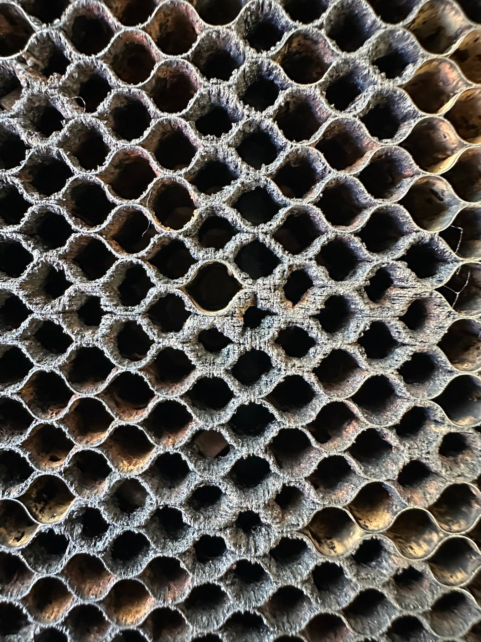

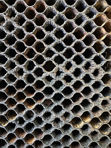

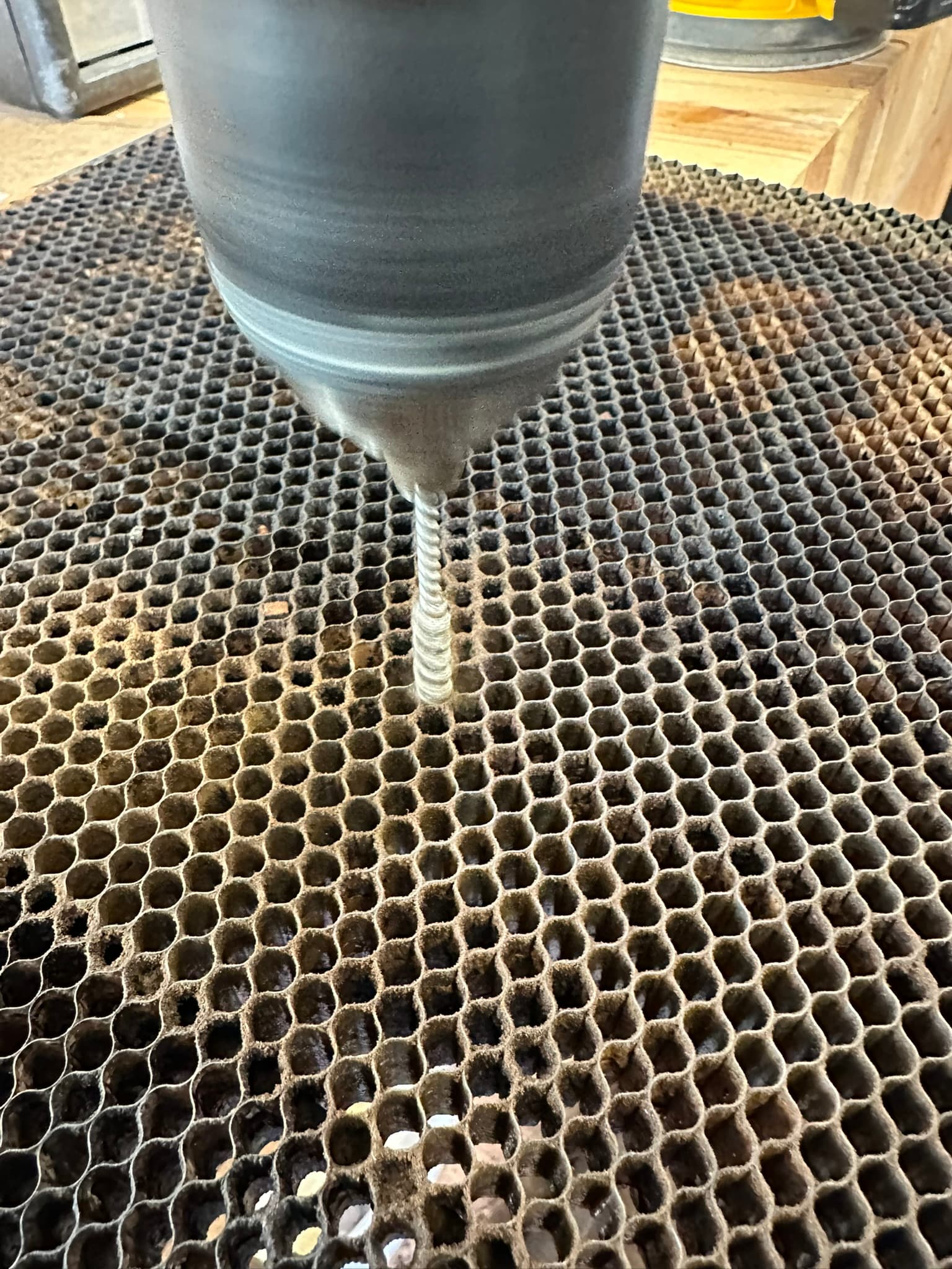

However, it looks like I have a pretty reasonable solution! There are small metal brushes (Amazon link below) roughly in the shape of a drill bit that you can put into a drill and bore out the junky bits. Works really well! (see photos).
A couple things on this process…
  1. The bristles on the bits tend to flatten down after a few minutes. If you reverse the drill periodically, it helps them regain their shape.
  2. Early GF crumb trays had smaller honeycombs… The bits below are 1/4" in diameter and it is problematic using those on the really old crumb trays. However, all my recent ones are larger holes, so the 1/4" brush bit works perfectly.
  3. It might seem really tedious (it is a bit), but I was able to clean all the holes on one tray in about an hour. Seeing as how the trays are about $150 to replace, I figure that is a good return on investment!
  4. The ones I used on Amazon are: Stainless Steel Power Tube Brushes. There are 10 in a $18 pack.
  5. Don’t get brushes with nylon bristles… won’t work.
Interested to hear if this works for anyone!!

Okay, perhaps I misused the reference to flashback. Back of cut material looks way worse with a dirty crumb tray regardless of what is the technical cause.
Everyone seems to have issue with my use of “flashback”. :thinking: Perhaps I misused the word. My point is that the back of cut material looks way worse with a dirty crumb tray regardless of what is the technical cause.

Never tried the engrave approach, but I will! I use a hex key (allen wrench) or an ice pick to push out any stuck bits.
About an hour for one crumb tray, so not that bad. Mostly using plywoods with MDF cores (but not Proofgrade stuff anymore… way too expensive).
