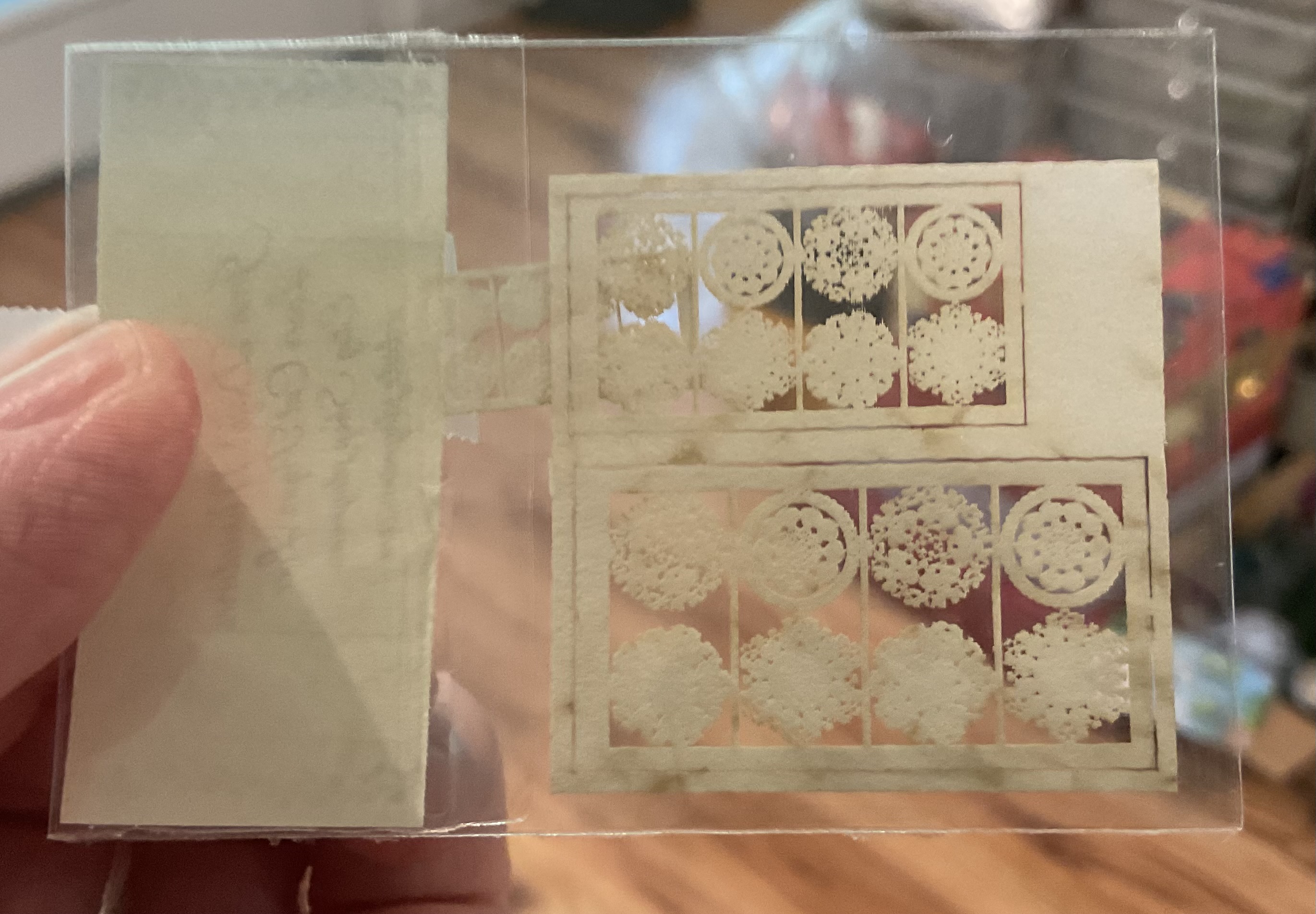

This really stuck out to me. On your plus machine, you’re going to have a heck of a time cutting anything that small out of paper without the fan blowing it away. Their newer diode machine, the Aura, does an excellent job with paper because the fan is so much less.
Also…I have no clue what this means " I want to put the little “arms” on them to keep them from just falling into the crumb tray when I lift off the wood; they need to stay attached to the master/mother board"
I do understand ‘nesting’ frames to utilize all of your material.
We’ll get you figured out in time… :slightly_smiling_face:
So everyone knows what I’m talking about, here are a couple of pictures.
See, can’t get what I want to say out of my head to my mouth! :rofl:
OK…I understand, now. What thickness wood is that? And, how do you get the pieces out without tearing or making a mess of the edges of the pieces? Like that piece right above your thumb in the photo…there’s that small space where there’s no cut.
The wood is of varying thickness, but anywhere from 1/32” up to 3/8” or so; very, very rarely 1/2”. To get items out, you just take an Xacto knife and cut the very small piece that wasn’t cut by the laser. This is how most of the miniaturists I know (& I know quite a few) laser cut their kits. The paper or cardstock is the same, you just take a sharp Xacto knife and cut the little tabs.

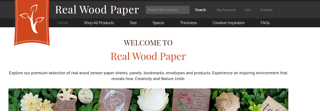

You might find this interesting…
Thank you! This is PERFECT and I can use if for multiple project ideas (flooring, inlay, doilies, shingles, siding, etc). I’m going to order some sample packs to try out and see which woods/grains work best for me.

FYI: The link was dead at the time I tried. Probably site maintenance. It´s working now.
it’s not a dead link for me.
you can get similar products here (i’ve used cards of wood a few times)
Weird. It works for me also. But if you search for “wood paper” there are more folks selling similar. I have a stack of samples waiting for a reason to focus there.
Probably under maintenance at the time. Thanks for the reference.
