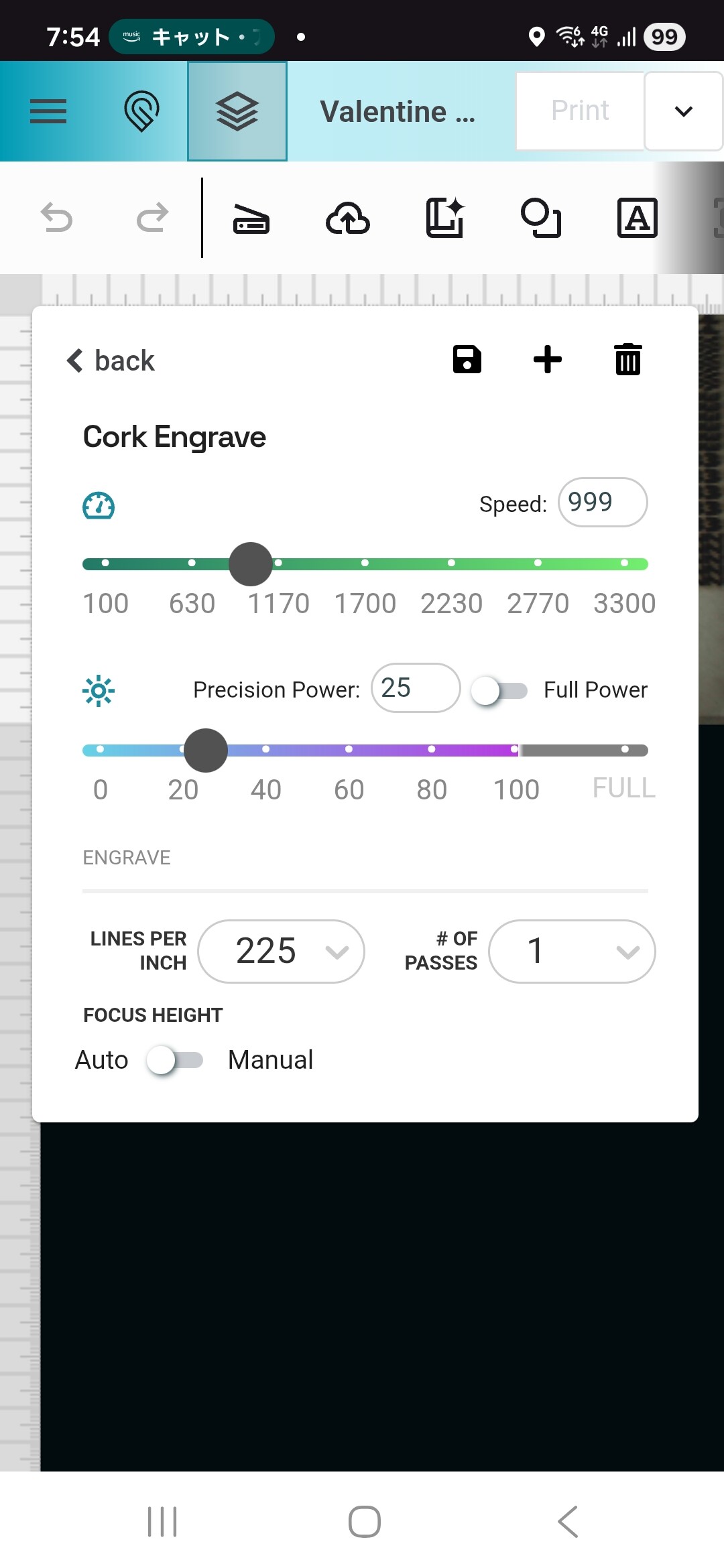

Hey guy! So starting a project for a friend and he wants cork coasters. Anyone have the setting used for cork? Thank you so much in advance!
How thick is the cork? Are you cutting it or just engraving it? Settings that are not proofgrade are usually found in the beyond the manual section of the forum. They might already have some there if you search, but if not, I’ll have to move this post to another section and it can be discussed in this thread. I have some saved, but I’m on my phone right now. I buy cork sheets in different thicknesses though, which is why I asked if you’re cutting.

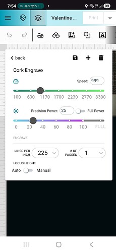

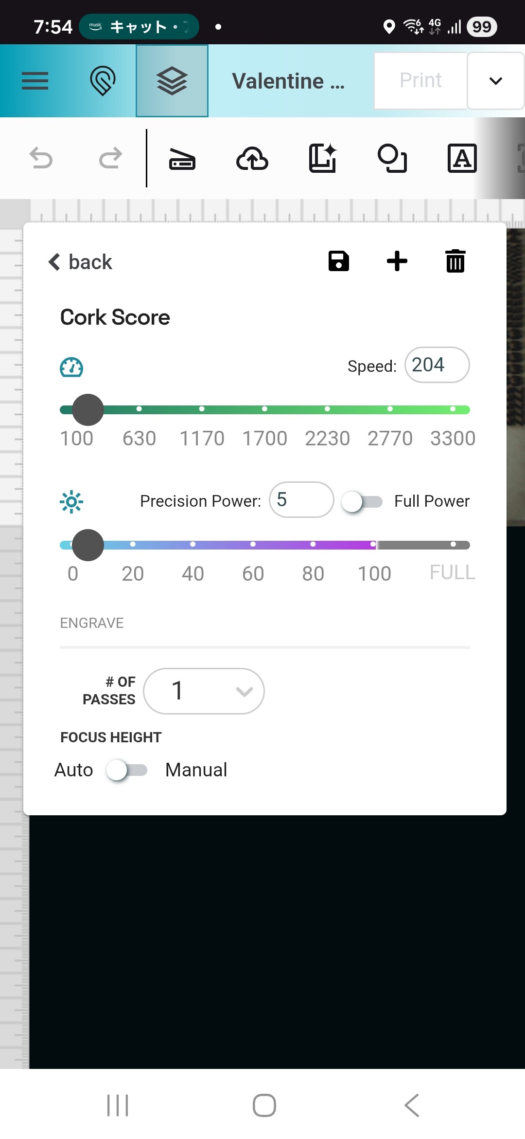

These are my old setting I had saved for cork, you’ll want to test them on some scrap because I haven’t used them in a while and I think some were adjusted when glowforge made some updates, because I’ve never set any speed to 204 or 999.

I had some 1/8” coasters that I bought in bulk from Amazon. I am pretty sure I used Engrave 1000/10/1/270 and they came out pretty good. But the design was pretty clear, simple, and contrasty. Your mileage may vary.

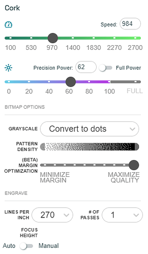

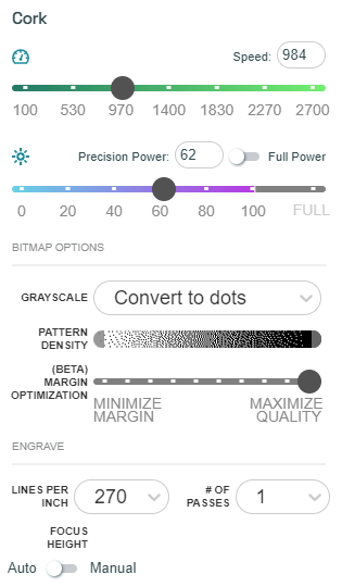

I use these settings for engraving on cork with good results. Good luck
