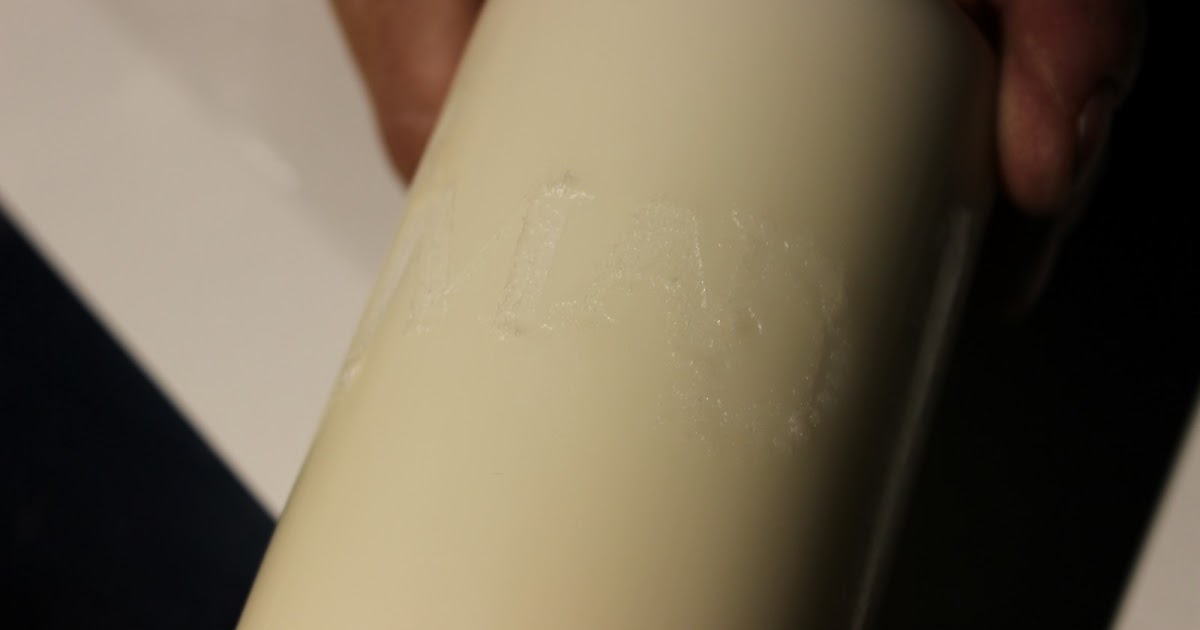

I just saw on @m_raynsford’s blog that he tried to engrave wax. It didn’t work…
I took a look, and he was trying to engrave on a candle, which is likely some variety of paraffin wax. The highest melting temperature I’ve seen for paraffin is around 145 degrees F. Jeweler’s wax has a melting point around 225-230 degrees F, so it’s possible it would stand up better to the laser.

If you’re after a machine to cut casting wax, a laser is not the machine for you… A Cnc mill or even a printer designed for it will/does produce much better results… (From experience) even sending a file to shape ways will get you a much better result.

I definitely second the CNC mill approach, I’ve cut a lot of things over the years and that wax wasn’t even close to cutting. The edges were a mess and the laser just didn’t penetrate for any depth.

True, I would make sure I had a metal pan underneath the wax though, I imagine it’ll make a fair mess… The extra hard wax is what we use for milling, it gets all of the detail nicely… Melting temp is still quite low (for complete burnout) cutting/engraving acrylic to make a master model would be a better/cleaner finish I would think…
