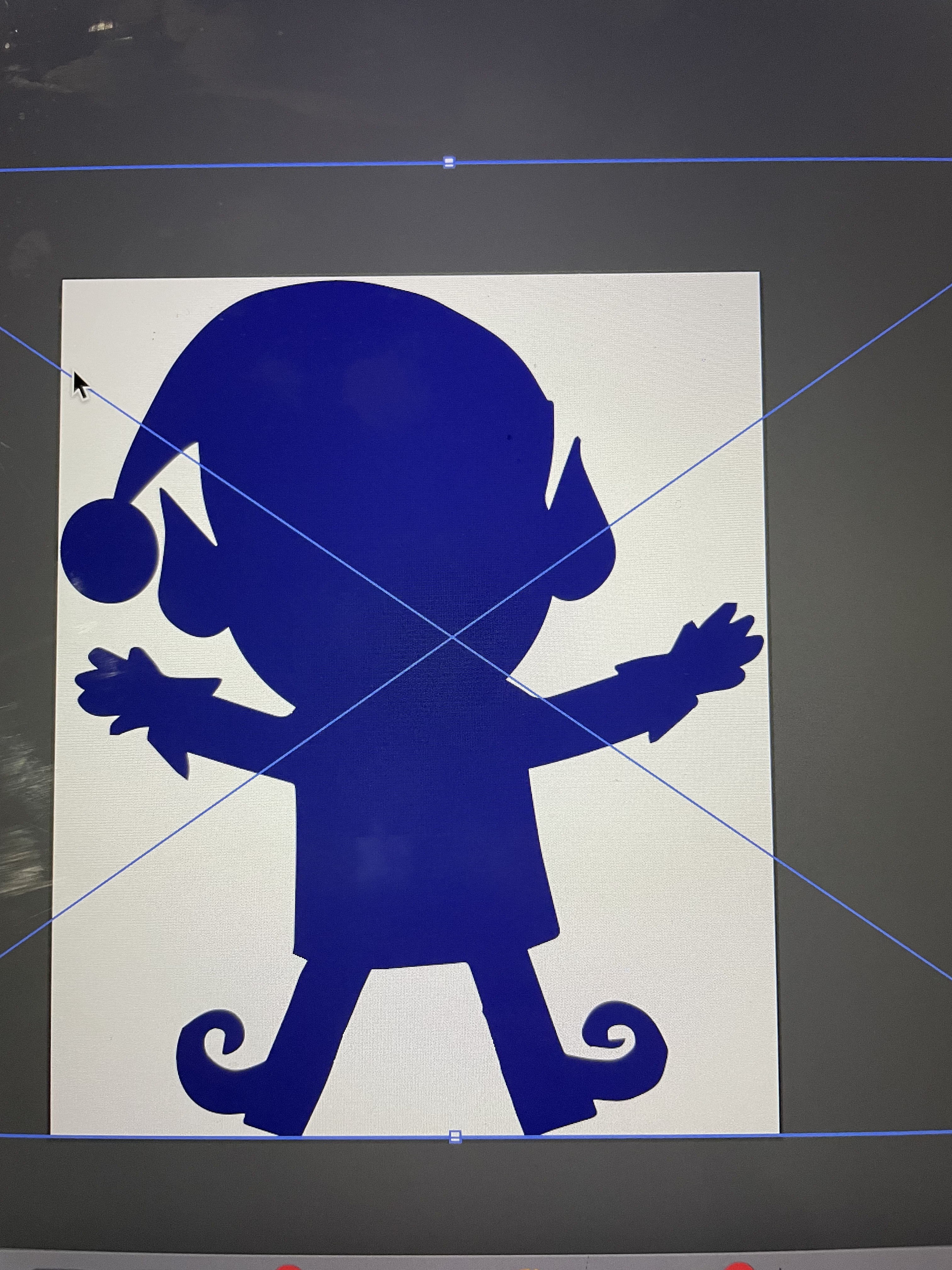

I have managed to get the outline as a cut svg using a solid shape but that has created new cut lines that I cannot get rid of see images below
On the legs.

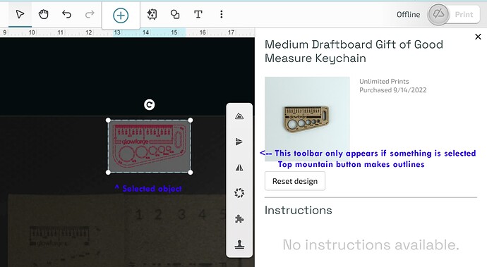

The outline button appears whenever you have something selected in the workspace. So you’d upload your jpeg picture to the GF app, click on it to select the elf, and you’ll see the floating toolbar with the outline button appear to the right.
ty i did manage to work the outline tool in the end :), unfortunately my premium is now over and I use this machine as a hobby with not as much time as I would like, so cannot really justify the premium cost :(. I think I may have to outline everything in photoshop and accept a double line with a thin rim of discarded material! Thank you
