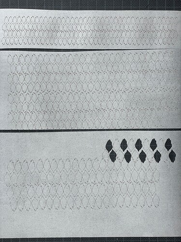

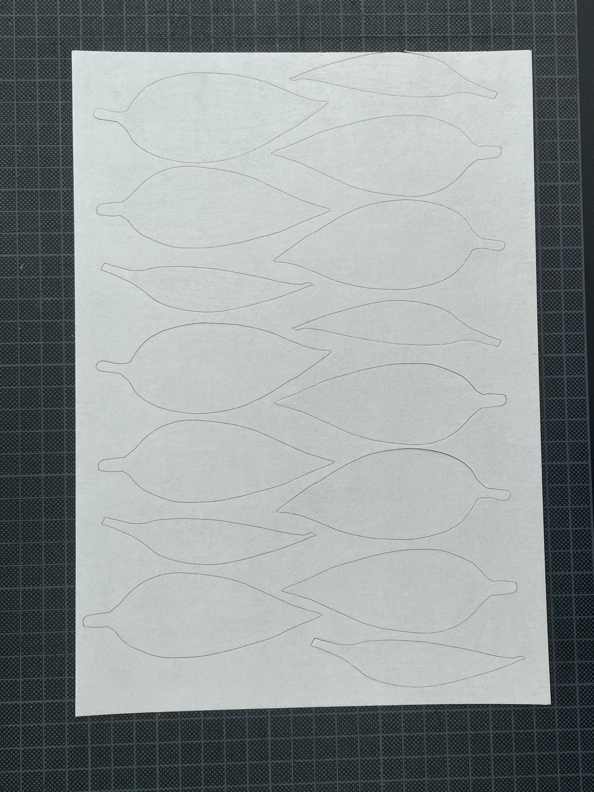

My Recommended Settings & Tips for Cutting Wafer Paper on a Glowforge
Thickness Speed Power Range* Mode
0.3 mm 518 20–25 Cut
0.6 mm 500 45–50 Cut
Additional Tips:
  • Secure wafer paper with magnets
  • Store wafer paper in a cool, dry place as humidity can affect cutting quality.
Result on 0.6mm
Result on 0.3mm
