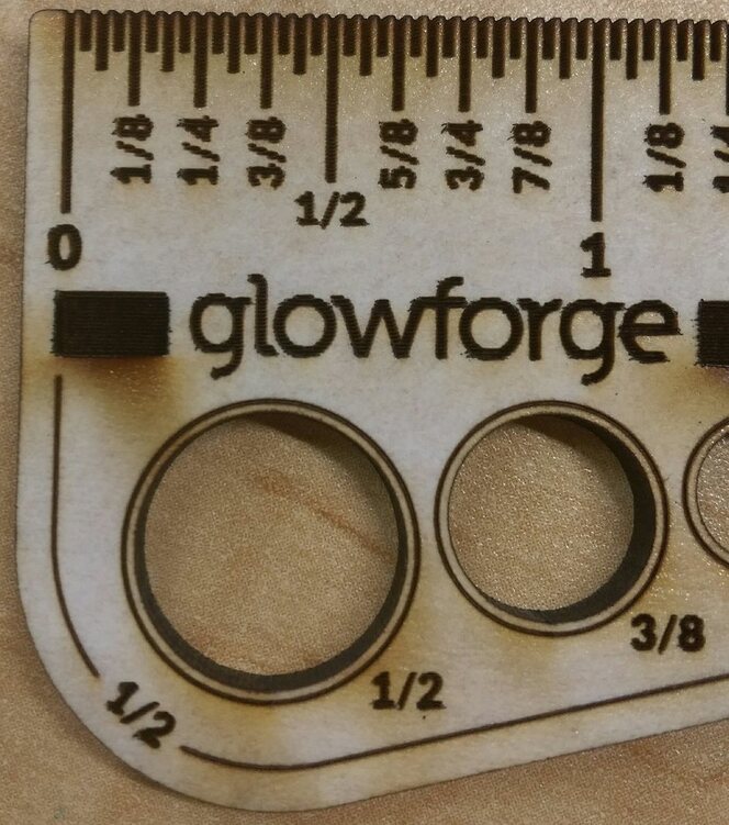

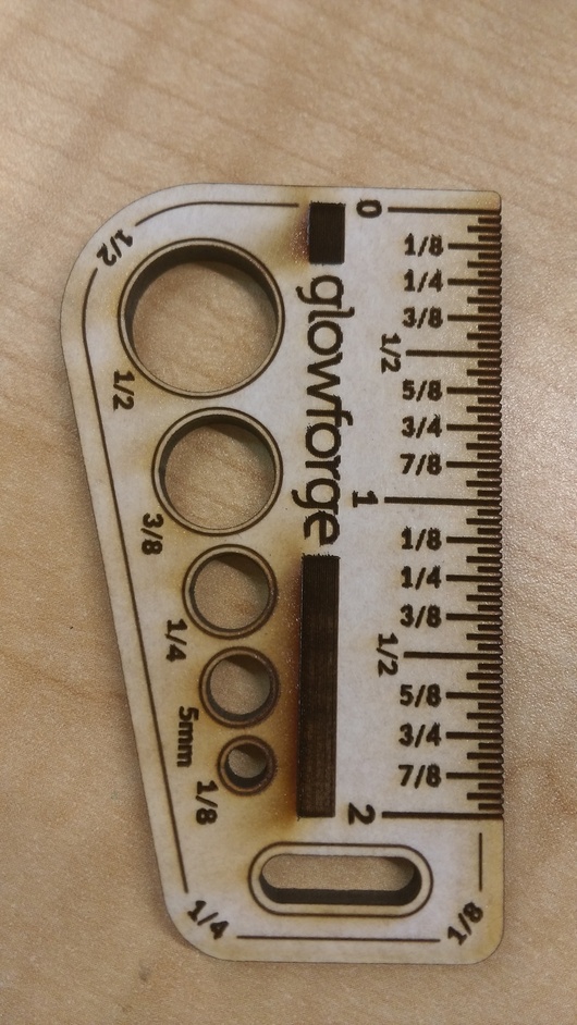

Actually wait…I just printed the gift of good measure, in the bottom right corner (since that’s where my old machine had problems)…alignment was spot on, however, why did it engrave like this? Was that somehow the new uploaded file, or my machine? I printed it on proofgrade draftboard, with stock settings. It’s not smooth like the old file.
Hmm… I’ll take a look. I’ll update the thread when I have more information.
