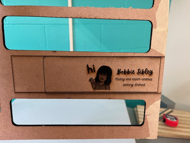

The wood where you can see cut out shapes is from a scrap that I found here in the office- obviously from the previous employee here. For me, I did have luck in the beginning, and that was when there was a trial period with the glow forge account, but now without that account, it simply will not cut.
