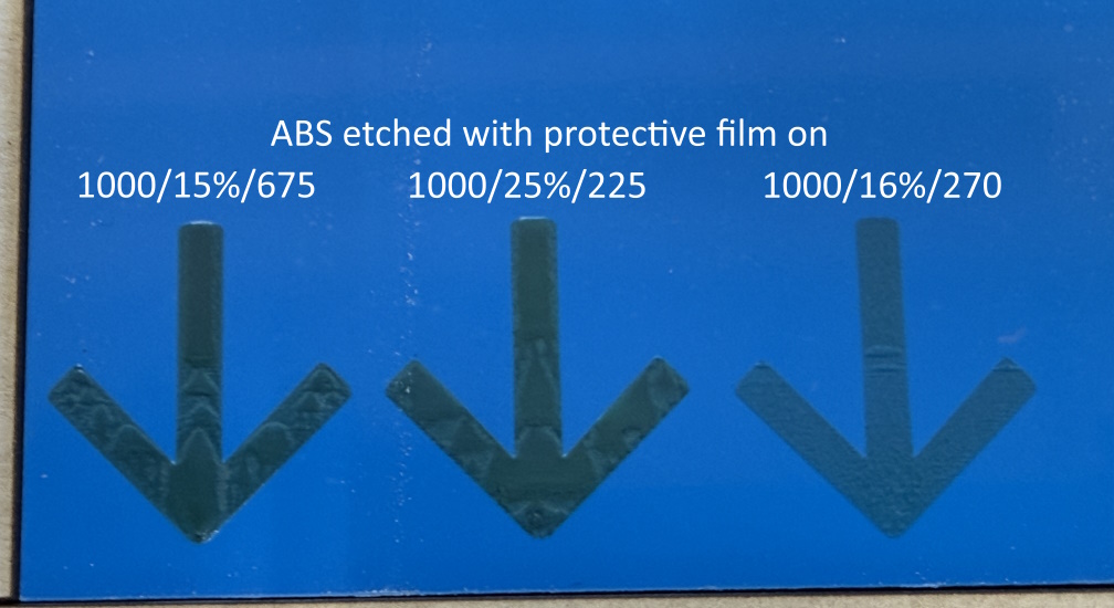

I’ve been trying to create some signs using two-layer plastic (not a Proofgrade product) on a Glowforge Pro. The plastic has a white core with a thin colored layer on top. The top layer is designed to be etched away, producing a white design and leaving the colored layer as the background.
My problem is: As the etching proceeds, some residue seems to be left behind on the etched (white) areas, leaving it with a dark (and uneven) tinge. The wider the etched area, the worse the problem becomes.
I’ve experimented with a variety of settings (for example: speed 250 with 12% power, speed 115 with 1% power, and many combinations in between) and various engraving resolutions. But no combination has given me a clean etch. I have found that slower speed and higher resolution gives better results than higher speed and lower resolution, but it’s still not great.
I have tried multiple passes, but that just seems to melt the dark residue in place, rather than removing it.
Is this a material that just won’t work on Glowforge? Should I be investing in a CNC machine instead?

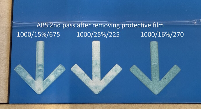

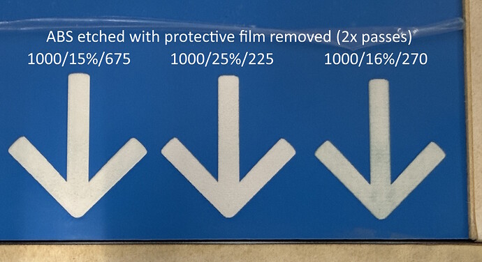

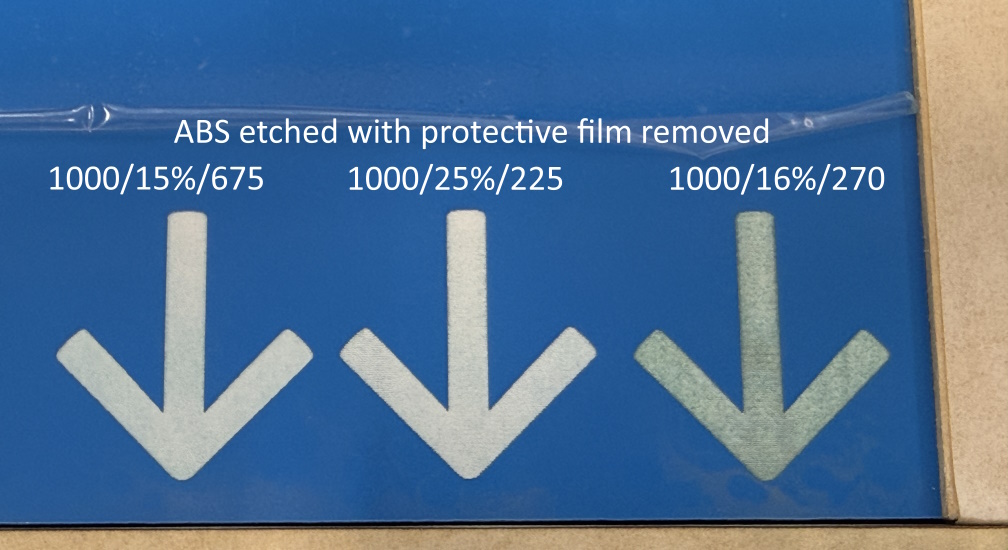

Thank you for your suggestions! My latest experiments are bearing good results.
It seems the mistakes I was making were:
  • Etching with the protective film on. The film seems to be the main contributing factor to the discoloration I was seeing.
  • Etching too slowly/deeply. With the settings you recommended, I see that the laser barely scratches the surface, so to speak. This produces a much more consistent and even result on the etched area. In my earlier attempts, I was really cutting a fairly deep groove into the plastic.

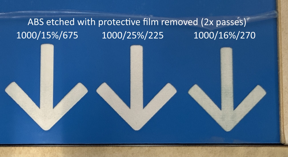

My test cuts on ABS sheets:
That middle one on my last test (1000/25%/225/2x) looks darn near perfect! Thank you again!
On my other material (acrylic), I’m finding I need 1000/25%/225/4x to get similar results. But it’s looking great!
