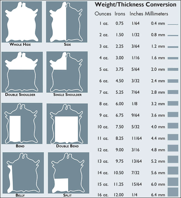

Yea, in the US ounces are still used, most of the rest of the world switched to thickness in mm. You can find plenty of places online that show you the ounce/mm conversion. here’s a chart Tandy posts on their website.
I think Glowforge is probably topping out at about 3mm leather, (7.5 ounce) which would make that their “think” product.
My (admittedly cheap) caliper reads their “thick” leather as 2.25 mm. The GF shop says the thick leather is 5/6 oz - which seems about right based on your chart/my measurement. There’s no way it’s 7+ oz - even without measurements and charts, I can tell that just by feel. That’s why I’m saying that “thick” is a misnomer here.

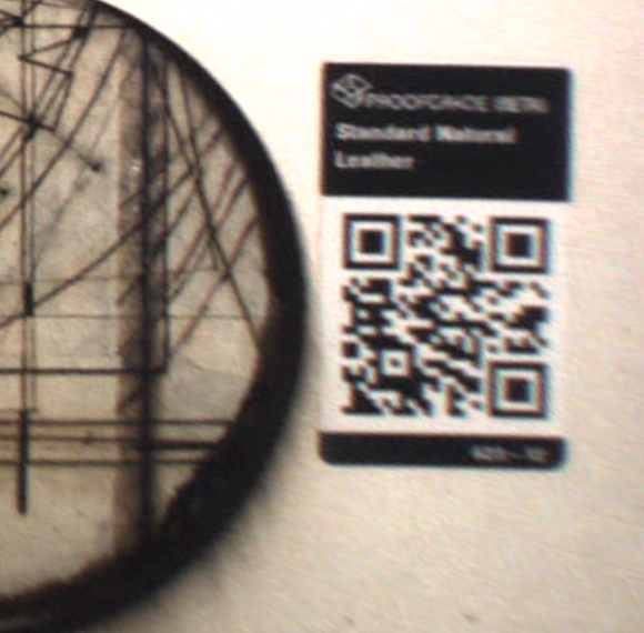

I’m pretty sure what happened is they just changed the naming convention to remove measurements on the stickers. I just got this leather last week.
They gave me a 5-6oz piece marked standard. It appears they just put the wrong sticker on it, based on what popped up in the UI when the gf scanned it.
This is what the sticker looks like. It says “standard natural leather”.

Oh yep, that’s different than what I see on my 5-6 oz PG
