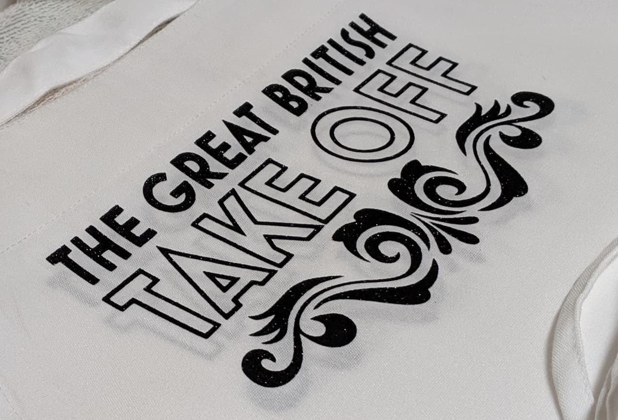

  • Heat transfer vinyl, cut with a vinyl cutter or laser. Many colors/textures available. Some material feels stiff and gross, some is fine, and stretchy material is available for really nice hand feel.
    • You need to know your materials and create appropriate designs. Any design with a giant patch of solid color will feel not awesome in this process. Bigger solid patches age in teh wash faster, too.

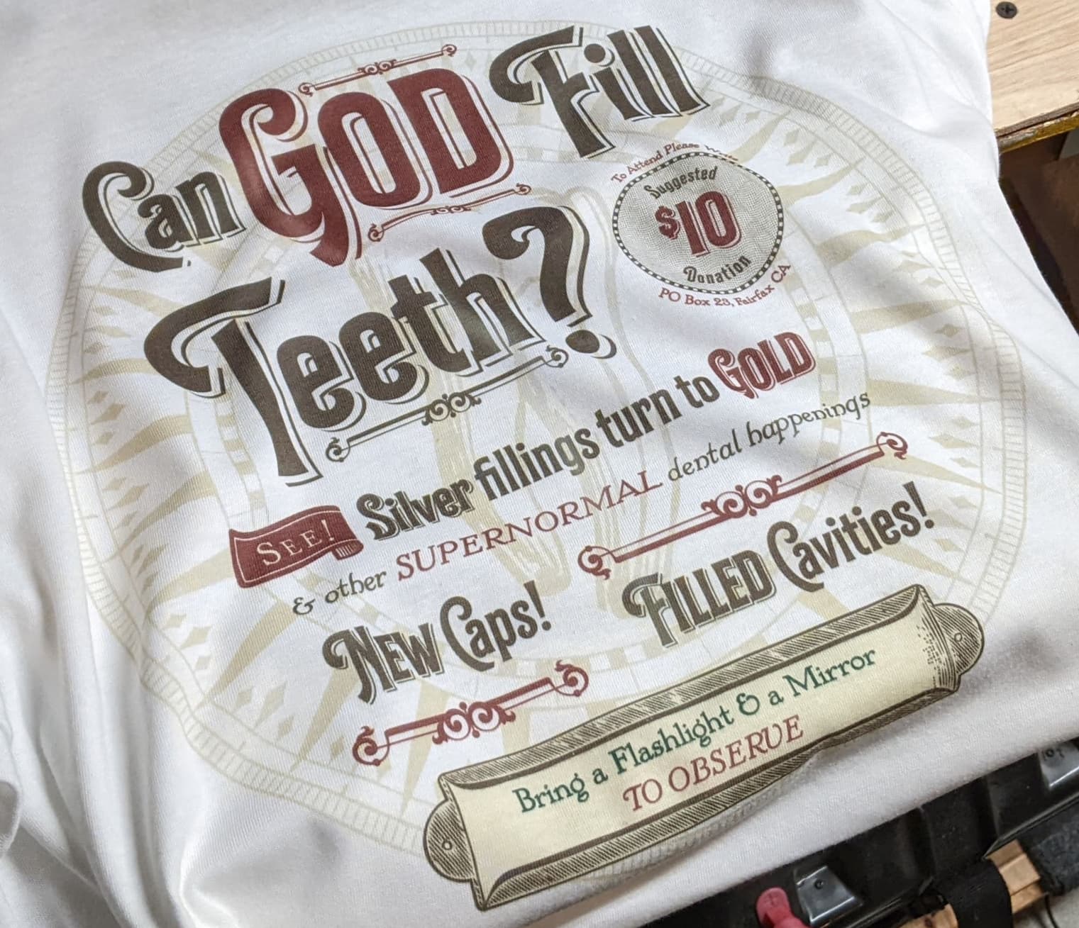

  • Sublimation, where you use an inkjet printer and special inks to make a sharp, full color transfer – but it only works on polyester/poly blends. You can decorate STUFF not just garments this way, search “sublimation blanks.”

This is one of my sublimation designs.
This is a black glitter design on a stack of aprons that I created for a burlesque show. This was done with my vinyl cutter, not laser.

Wow, I love your designs; but this is a rabbit hole I should stay out of.
