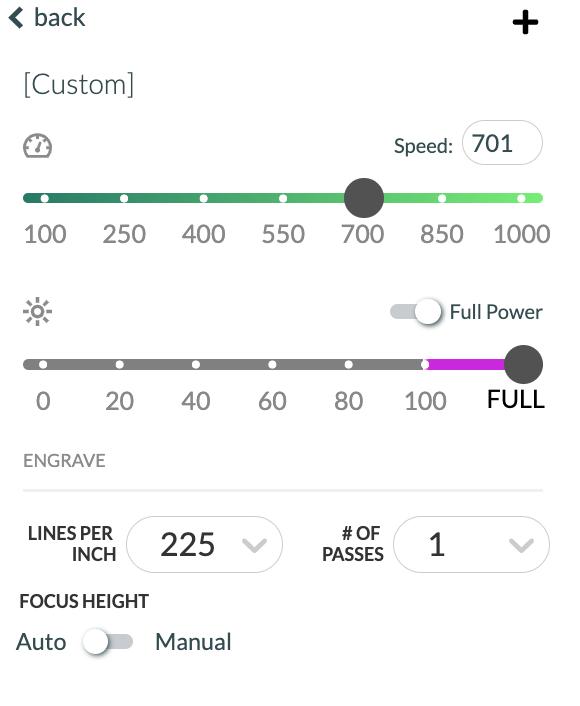

I have a Pro. Fastest for vector engrave is 1000. Only bitmaps/raster allows higher.
Vector:

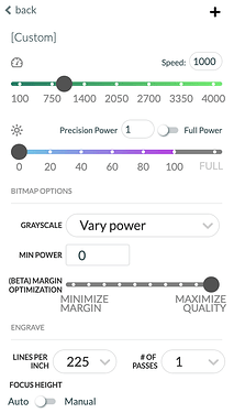

Bitmap:

It’s non-linear. You have to go to 4000 to get 2x 1000.

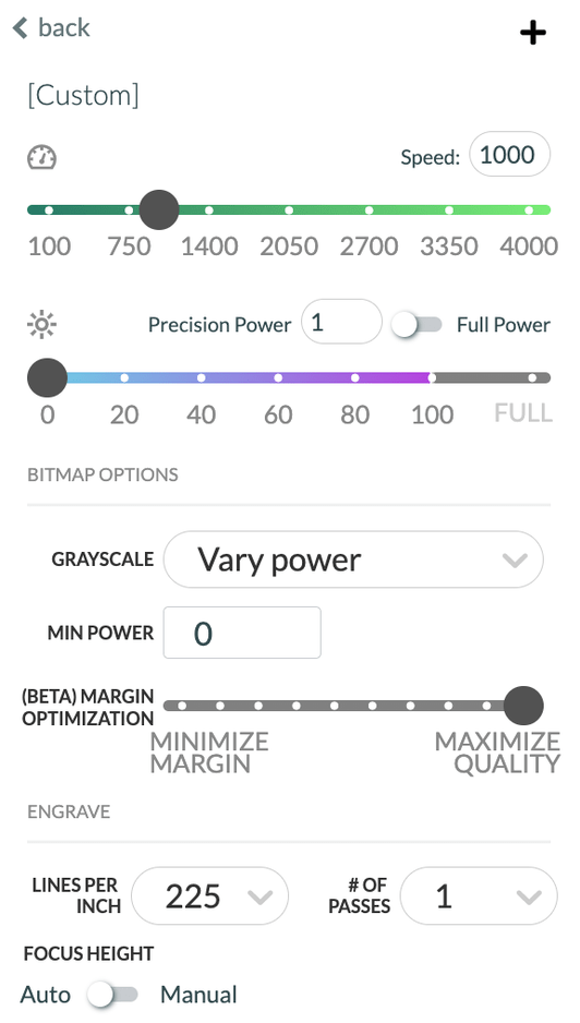

But with what you have, make sure you try out the “MARGIN OPTIMIZATION” slider you see on that raster engrave settings screen. It defaults to maximum quality, which is slowest. By engraving while the print head is slowing down or speeding up, you can capture a bit more benefit from that enhanced top speed you now have. Slide it towards “minimize margin” and – again, depending on your artwork – you may see the job time go down even further.
I appreciate the detailed response. I understand that technically it’s 2x faster, but I guess with the small 12x20" bed there isn’t much room to see that. I’ll have to mess around with that Margin setting, but slowing down the print isn’t an option for me time wise. Right now I’m looking at a 7 hour engrave time at 1000 speed, so slowing that down isn’t attractive to me with that design. At least having a second laser cuts time in half. Definitely disappointed though. And unless this type of detailed explanation is given in the description on the website, I do think they are deceiving the general public. Definitely did it to me. Glad I didn’t go for a Pro.
