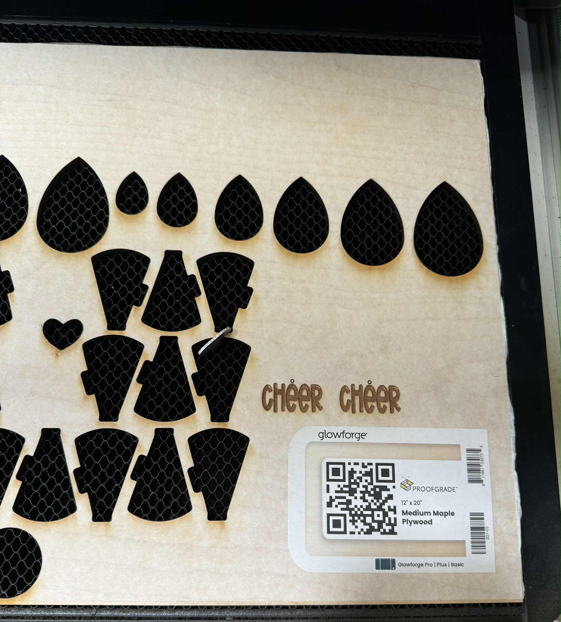

So, went through the entire diagnostic thing with Glowforge customer service. They say to come here as it is the material I am using, that I must only use Glowforge Proofgrade at the designated speed. It will print some of the design on the screen and then stop. NO WARNING LIGHT. Timer keeps ticking. Machine does not send head back. Opening the lid does not send the head back. ALL lenses are clean. ALL fans are clean. I run it a AC Infinity. I use regular/glitter acrylics, printed acrylics, as well as printed mdf from companies such as CMB, Smokey Hill, and Houston Acrylics.
For clarity, I run three Glowforges and have for 5 years now. I have run all sorts of Glowforgable acrylics and woods at all sorts of speeds in all of my machines these past 5 years. Doesn’t mean I know everything, but it means I’ve been there, done that, so to speak.
**It is not the Wi-Fi as it receives all the information. It is, in fact, the machine closest to the router.
**It is not the fans or the tube. What it manages to cut before stopping, it cuts perfectly. There are no flames.
**It is not the temp in the office. I have a mini-split running at a constant 70 degrees.

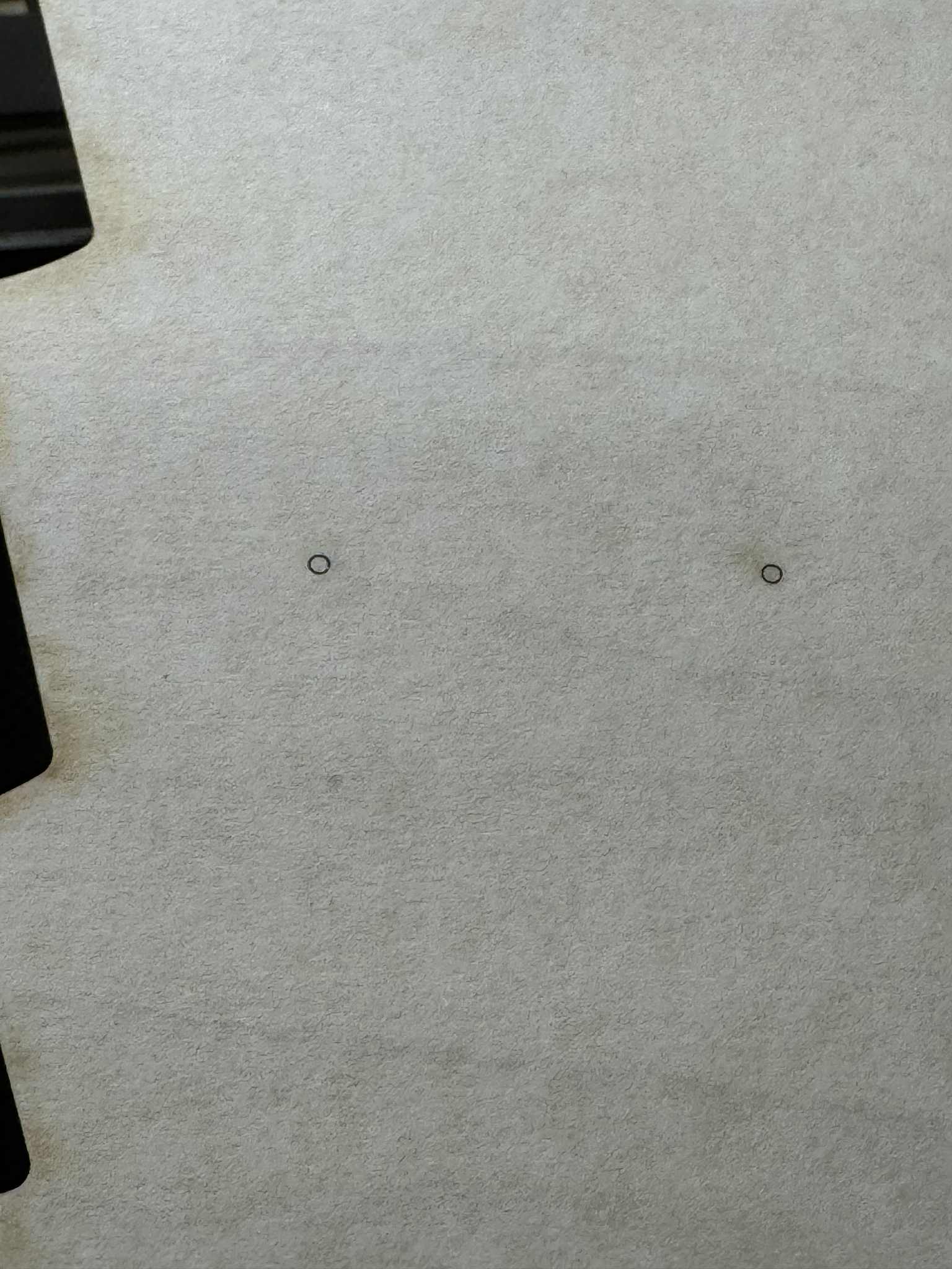

So, for good measure, I cleaned the pins on the head this morning and fired her back up. Still the same. The kicker is that you can get engraves all day apparently. Just no cutting. See Cheer pic in next comment.
For reference. Today’s attempt on the Cheer pieces on Proofgrade. Also attaching yesterday morning’s video taken while on the phone with Glowforge Support.
