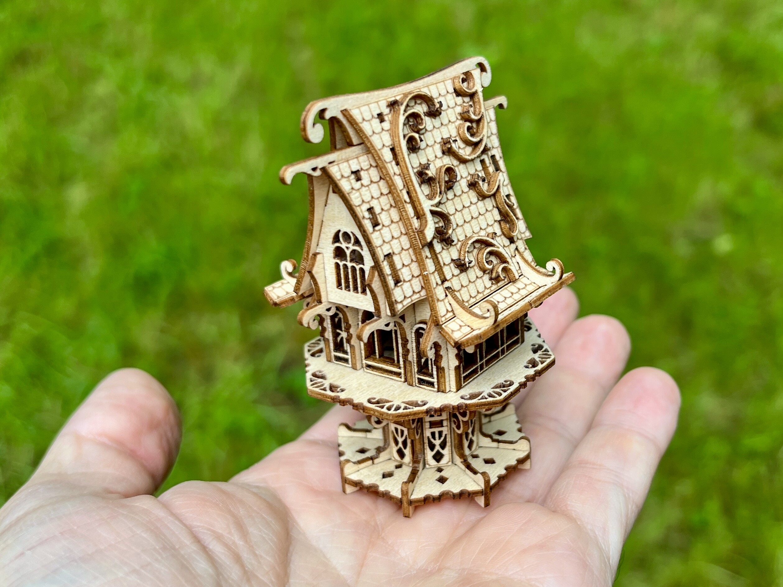

I made a catalog design! I pretty much never do catalog designs, but I was interested to see if I could scale it down to use the 1/16" plywood we talked about a while back.
Short version, yup!
Longer version:
We have talked about scaling design theory in the past but I thought this was a good time to give a practical example.

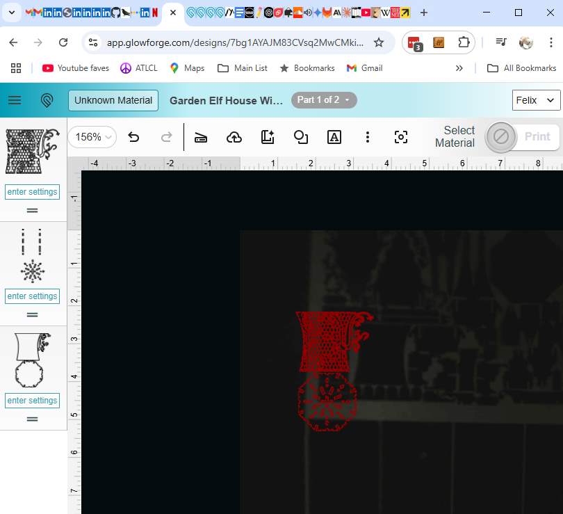

I know this was designed for PG medium plywood, but that isn’t precise enough to work with, I need to know exactly what the slot thickness is so I can convert it to the desired slot width of 0.057". To do that:

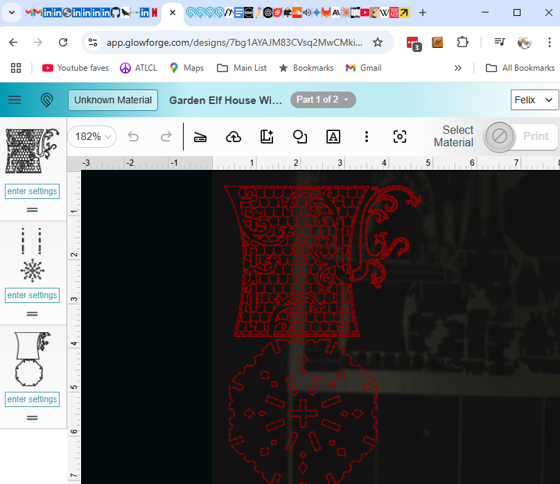

  • Load the design

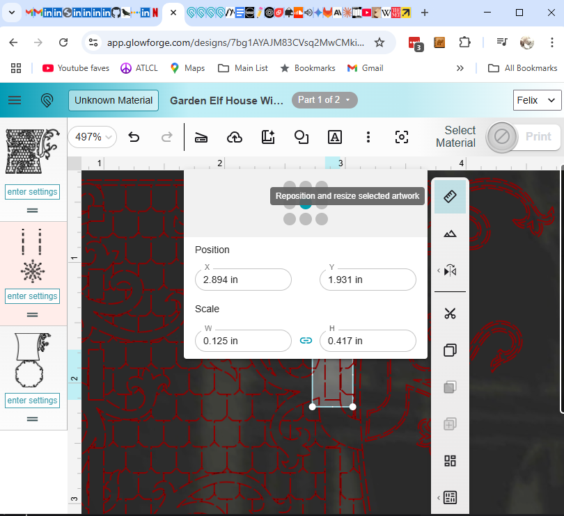

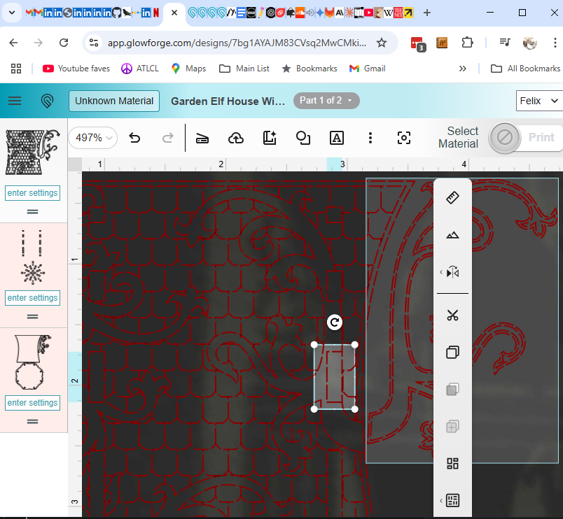

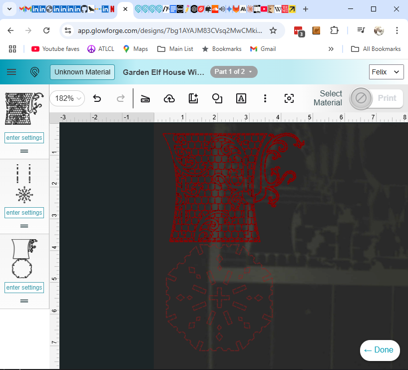

  • Find a nice horizontal or vertical slot [choosing horizontal or vertical will make measurement easier]. There’s a good one in the roof (top part of this page of the design), to get to it I need to enter that group. Double-click on the roof part, it’ll let you work with individual parts of the group. You’ll know you’re in the right place when you see the “done” button
  • Now carefully select the slot you want and then use the ruler tool to get its precise size. We need to know the width.
  • Got it… Ruler…
  • You can see the original slot width is 0.125". Great. Jot that down. (If using a horizontal slot, then you’d want to know its height)

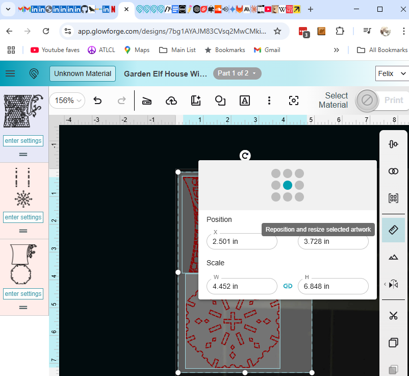

  • Now click done to leave the group and select the entire design. Check its width:
The original total width of the design is 4.425". OK so now, we use the formula

  • Set the width in the ruler tool to 2.03" and you’re done.

Thank you @evansd2 for the very clear explanation of the process of scaling down (or up) a design. Also I am impressed with your patience and skill assembling the resulting tiny house. :slightly_smiling_face:

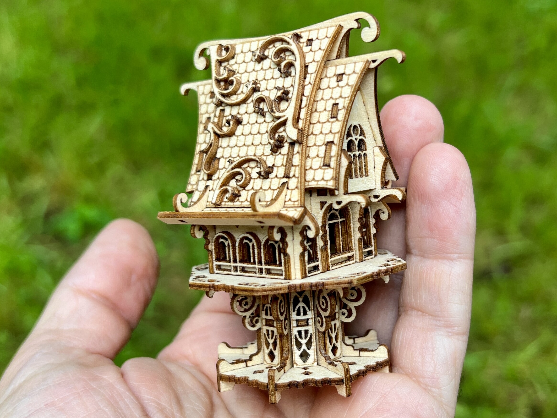

It was a little tricky, mostly because you have to use tiny amounts of glue on some parts. I use a needle bottle (previously discussed here) and it went pretty smoothly. It’s a clever design.
It was also a bit fiddly because I chose to go with a fairly good friction fit on the slots. Not much margin for error and you have to align some slots semi-blind due to the way it’s assembled. I’ll admit to a bit of grumbling, but it all came together. If you’re committed to gluing every part then you could go with a wider slot and make assembly simpler, but I was trying to avoid glue where possible.
Irony: I ended up gluing almost everything. :slight_smile:

The good news is that I wanted the house to be smaller, so it all worked out! :slight_smile:

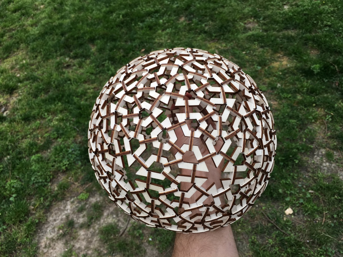

Some of my designs have hundreds of parts and over a thousand slots.
That’s end of the world. Here’s one with 1800 slots.
Manually replacing them would be a disaster.
