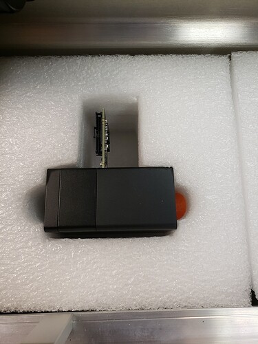

oh, no sorry its domestic order Glowforge Pro. So got unit today, notice plastic is torn up after opening box. take unit out follow setup and that is 1st thing i notice i am missing power cable. then laser was completely turn around, forcefully place in place.
So i am not sure because i can’t even test unit to find what and if anything is wrong.

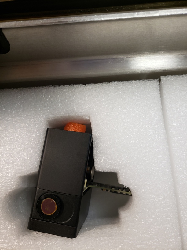

There is only one way laser should fit in housing for shipping prior installation, well its turn 180
So you are saying that the tube is on the front side of the gantry? Any pictures?
I take pic how i find unit and the way it should , at list the way i think it should be place during shipping
I mean ultimately, I don’t know that it really matters. I guess you are saying the machine was turned around inside the packaging. If it broke in transit, then it will be replaced. If it didn’t, then… it didn’t. Only way to know is to fire it up. As far as the cord, not sure where they are packaging them now. Mine was inside the machine, in styrofoam, under a styrofoam lid. Have you taken the machine out? Have you removed the styrofoam from inside the machine?
So 1st pic is the way i found laser, 2nd is the way i think it should be.
This is when i stop and contact support , 3 h. ago.

I was confused. When you said the laser was put in wrong, I assumed that you were talking about the whole machine.
That mechanism you are seeing is the lens housing head. There is a window on the side that allows the beam to pass through. It contains a mirror to turn the beam 90 degrees and a lens and motor that allows it to focus. It also has measurement lights and sensors in it, plus a small fan for keeping debris from coming up on the lens.
The laser tube is the long glass pipe with other pipes in it that goes along the left right axis on what is called the gantry.
That’s too bad it was not put in correctly. Check to make sure that the top mirror is seated correctly. Just firmly take off the lid that is attached with magnets, the top plate that has the Glowforge logo on it. It should be ok since it is put in position with a pusher and foam.
More important is insuring the lens is placed correctly. Look down under the head and into the tube. Does it seem evenly placed and not skewed at an angle? The foam plug looks ok, but it could have shifted.
Go ahead and set it up and see if it works.
