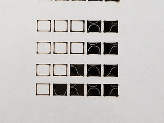

I currently engrave all my paper as the cut function burns holes in corners at these low settings.
20170723_201415
Here are the settings I currently use, adjusting lines per inch depending on detail size. This gives minimal char, decent speed, and clean edges.
All the paper art I cut is 100% black so the gray level doesn’t matter, but it’s something to keep in mind. We are trying to destroy all the paper in order to cut it, we don’t want shades of grey changing our power.

How do you hold the paper down?
I use magnets in the corners of the paper, this does the job when combined with engrave destroying small detail to minimize paper flying around. Magnets!

Does it char the paper?
It depends on your art, the closer the detail is to other detail the more char you can expect though i’ve never seen the paper actually burn with these settings. Sometimes the char adds a nice touch, sometimes I flip the paper over and the backside is usually nearly perfectly white.

this seems to imply that flipping your art and, essentially, engraving on the back will help minimize char on the front.
i have a handful of press sheets (28"x40") of neenah duplex black/white paper, so i’m thinking i could engrave with the black side up and get even less visible char. need to make sure i squirrel that stuff away at work.

So it seems like you’re not cutting all those shapes, but evaporating the paper via engrave. Correct?
Cool, thanks for sharing your process. This is on my list of cools things to try. I just need to dig up the right art for it.
If you’re designing in vector you don’t need to worry about color as the engrave power will only follow what’s specified in the settings, ie: vector artwork does not give you the dithering options nor map power to gray levels so it’s always the same power level.
Yes that is what he’s doing. I did some testing last night on 110lb card stock and engraving is nice because you dont have little bits of paper cutting loose and flying in the laser path, nor the overburn in corners like he already mentioned. It does take a while though even at max speed.

Mostly correct, though somewhat depends on the design. This had the added benefit of keeping most everything attached to the page until it’s done as well. If you look at the time lapse you can actually see a large chunk fly off.
