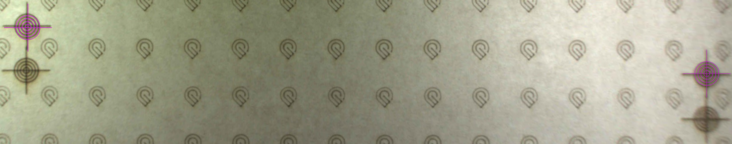

Ran the test (as per the instructions) and check the accuracy in the upper left hand corner with the target.svg. WOW!!! Look at this at 1000% magnification:
But as with any MythBusters groupie, I just had to push Koptis to his limit.
This required putting 2 targets at nearly opposite ends of the material and set the focus on the left target. Pushed the magic button and UH-OH!???!? The left target looked good
but the right target looked like this (1000 Zoom):
Crap! It must not of worked.
After the initial let down, I realized that the Set Focus was on the left target. Hmmmm :face_with_raised_eyebrow: So I decided to do the Set Focus on the right target which did bring the pink image in better alignment, but moved the left target off a bit.
I grouped the 2 targets together and with the Set Focus still on the right target, moved them up (trying to stack the right target on top of the tip of the previous print). Pressed the magic button and got this:
The good news is that the actual print looks like this:
Details (Left)
Details (Right - the tilt is my camera not the GF :glowforge: )
So over all, make sure to use the Set Focus and you will get incredible accuracy.
Yeah, set focus is pretty critical and you can set it multiple times to position different objects.

A word of warning on this: the actual focus is going to be for the last set focus you used. So, if your material is warped, things will be located correctly, but the laser focus will likely be off.
