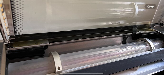

I decided to buy the bracket on eBay. Since the machine is from the first batches produced, it’s a bit of an antique and the bracket seems lower maintenance and I’m less worried about messing with the unit. My concern with the bracket is the possibility of torquing the lid and breaking the glass. The glue is a convenient give way point before the glass breaks.
The reason that my glue broke in the first place is that I had my holding pins container top (a Talenti Gelato lid) on the side glass and it slid under the top as I was closing it. The leverage was enough to break the glue adhesion without much extra pressure from me.
NOTE: Don’t put things on the side glass.

My original unit from the crowdfunding era has also just snapped from the hinge as several people above. I was able to get the ribbon back in place so it is functioning but oh my word how scary. Now off to find some PC-7 adhesive…
okay a little in the game here as my machine has begun to do the same starting from the right side. The left is still intact, however it concerns me as it seems that the glass itself is taking the load stress when we open and close the lid. I hope the glass portion of the lid will stay intact. Gonna look into that pc-7. I’m glad I found it now before I go full production again for the holidays.
Well, here I am again, about 18 months since the first(right-hand) hinge failed.
All has been well, but now the left-hand one has parted company with the glass lid.
Ho hum - at least I’ve been here, done that !
But I’d like to raise a new(?) idea. While the lid is off, I tried moving the hinges. They are incredibly stiff, probably to help keep the lid in a raised position when open, but it occurred to me that a modicum of lubrication might not come amiss.
Any thoughts, good people ? I thought a little wd40 via a cotton bud might do the trick.
What thinkest thou ?

I gave this much consideration in the past.
I relate it to a hood on a car, for example. The hinge is free to move, the support is provided either by a fixed post, or pneumatic cylinder.
The hinge itself would be a horrible way to support that weight - but that’s what we’ve got. So any time I need my lid to stay open, I use a support - a ruler, a scrap of material, whatever is handy. I’ve never lubed the hinges, but I’d choose a graphie spray myself. Anything else would attract/hold on to vaporized material.
I’ve just completed the repair, and so far perfect. I did wipe some wd40 onto both the metal pin and the sides of the plastic part, that is rubbing on a metal plate below each hinge.
It does seem to have reduced the ‘starting friction’ when lifting the lid, so I think it’s a definite improvement. Certainly makes me less nervous when opening Goldfinger !
