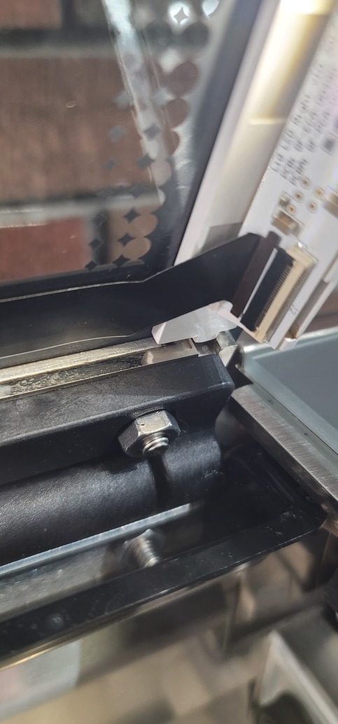

Hey received my refurbished glowforge less than 2 weeks ago and now im getting a lid open error. Ive read through all the threads removed crumb tray cleaned lower door check cable lids on glass and even replaced the black lid cable. Nothing works! ive rebooted wifi refreshed brower ive taken pictures and email support no response no answer. Any one else have suggestions clearly its not the black lid cable. Also magnents on door are secured and i do have contact. Please help. I was out of a machine for 3 weeks during christmas and now this happen

If you are able to post a picture of the circuit board on the left of the machine then that would be good. That way we can see if your ribbon cable carrying info from the lid is correctly plugged in. With the machine off, you can pull the arm to the front of the machine and then use your phone to get a picture of the board. Mainly looking to see that this cable is connected:
Here’s is an image of the cable looks attached to me?
And yes I here clicking when starting up
What machine is it again? you have some lonely molex connectors there. I am assuming it is not a pro.
Do you have a picture of the circuit board along the lid (what the black cable goes into). How comfortable are you with troubleshooting? I think waiting to head back from glowforge via email might be best. If they leave you high and dry then you can post back and let us know what the found on their end.
