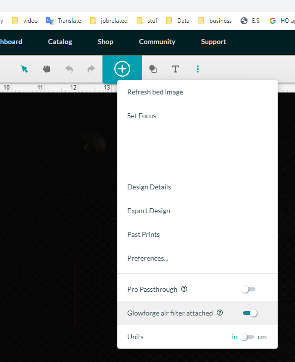

I did a simple puzzle cut on my Glowforge with proof grade material and smoke was everywhere. The filter and the inline didn’t seem to pull it out even the fan from the laser printer didn’t seem to be working. I ordered or shall I say I tried to order a replacement filter more than 3 months ago and still out of stock. I can’t vent out of the window where I am so that was the reason for both apparatus. What can be done I have my very 1st real order and am planning for a wedding for this July with orders attached to that. I don’t need the fire department at my house.

You do want to turn the fan off by picking on the grayed area…
That says you are using the filter.

I have the switch just how it is in the picture
