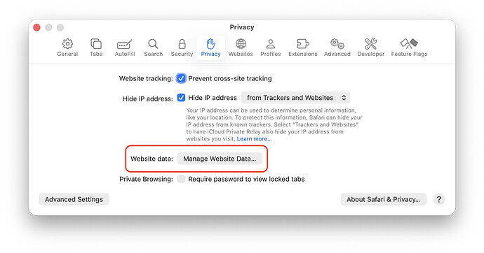

Usually when the Glowforge app stops working in a particular browser it’s because the cookies or other saved data for the site is messed up. This can be remedied by deleting the relevant data. Exactly how you do this depends on the browser, but here’s how it works in Safari:
  1. Open Safari’s Settings window and click on the Privacy tab at the top. Then click the “Manage Website Data…” button:

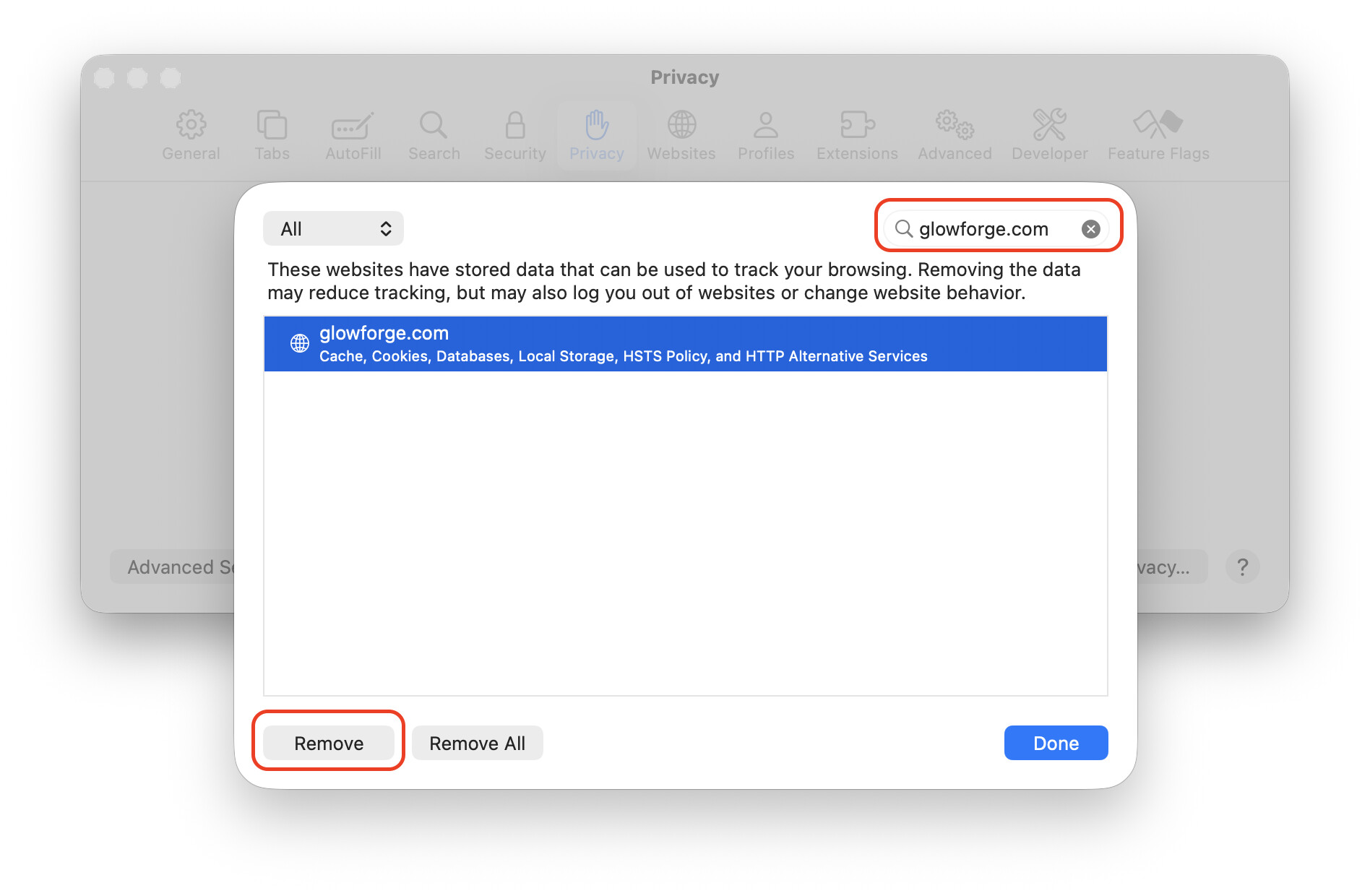

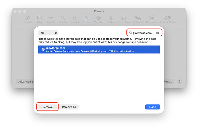

  2. Search for glowforge and click on it in the search results
  3. Click the “Remove” button to delete the cookies and other saved data for the site.
You’ll need to re-login to Glowforge afterwards (since you’ve just deleted your login cookie) but this often fixes these sorts of problems.

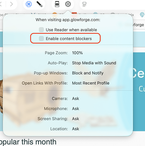

Problems can also arise from certain content blockers. I’d recommend turning off content blockers for the site:
