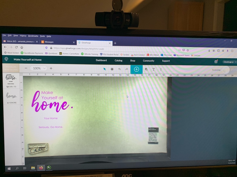

We are stuck on scanning, the head won’t move and the camera won’t show what is on the bed.
I am SO FRUSTRATED. I’ve got a $6000 paperweight and 10 orders waiting to go out. Does anyone have suggestions on what to try next?

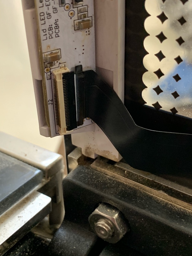

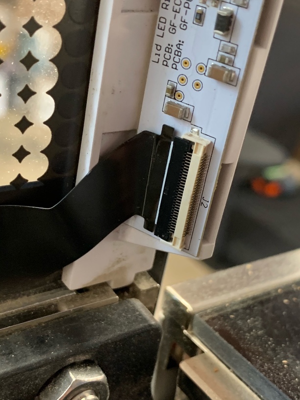

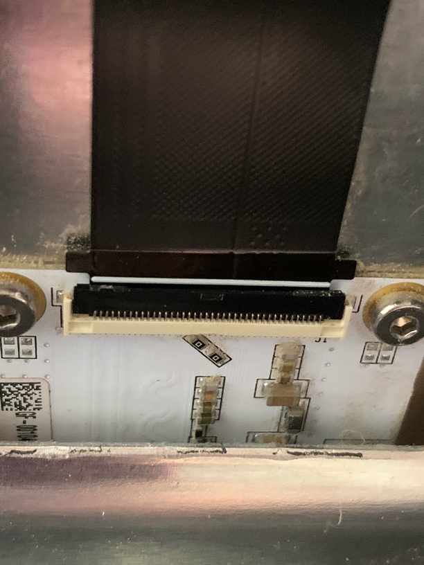

Hello @CustomHouse - I’ve just come across your email ticket and saw this was open as well. I’ve just sent along a response to your email, but I’d like to recommend trying to reconnect the center and left connections on that lid cable. It could just be the angle of the photograph, but it’s possible they’re a bit loose.
