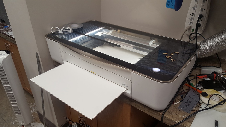

I am working on setting up a process for turning the airplane plans from FliteTest into something i can laser cut. I used to make these airplanes for my kids, but have run out of time lately to cut these out by hand. I decided to try and make the FT-MiniArrow. These are the plans they provide. the problem in a single wing side is bigger than the cut area of the glowforge. so I had to find a way to match up 2 separate cuts. First i converted the plans to something the glowforge can understand

I placed a piece of foam-board through the pass-through slot.

then i turned the foam-board around and put it back in the slot, looking through the marker holes I cut earlier and matching them both up.
(Image F)
I ran the second part and it matched up perfectly.
(Image G)
you can not even really tell where the cuts connected. The score cuts worked out great as well and i was simply able to bend the wing into its shape. I will finish this up next week and post pictures of the finished airplane.
