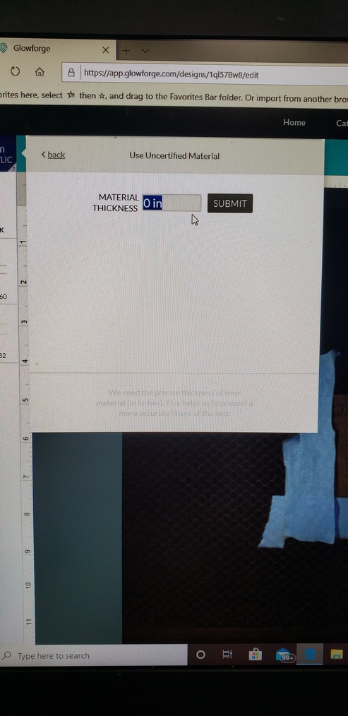

Shoot! I had Hope’s that this would solve it but nothing! I tried using some cork this time directly on the tray and same result. You know what is strange? Up on the top left where you select the material that you are using, you can choose to use uncertified material and then enter your material thickness. In that box, I can not adjust the size. Its locked for some reason. I think this has a correlation to my errors. It may be a software error on my glowforge app? I dont know but its strange that this would be locked and all of a sudden I’m experiencing these issues when just the prior night I had used it.
If you used the Set Focus Tool, that number does get locked. Try closing the file and you should be able to reopen it and set the thickness if you want to.
Okay, went back, did that. It did unlock it but the glowforge wants the acrylic piece in there to be able to cut any material.
