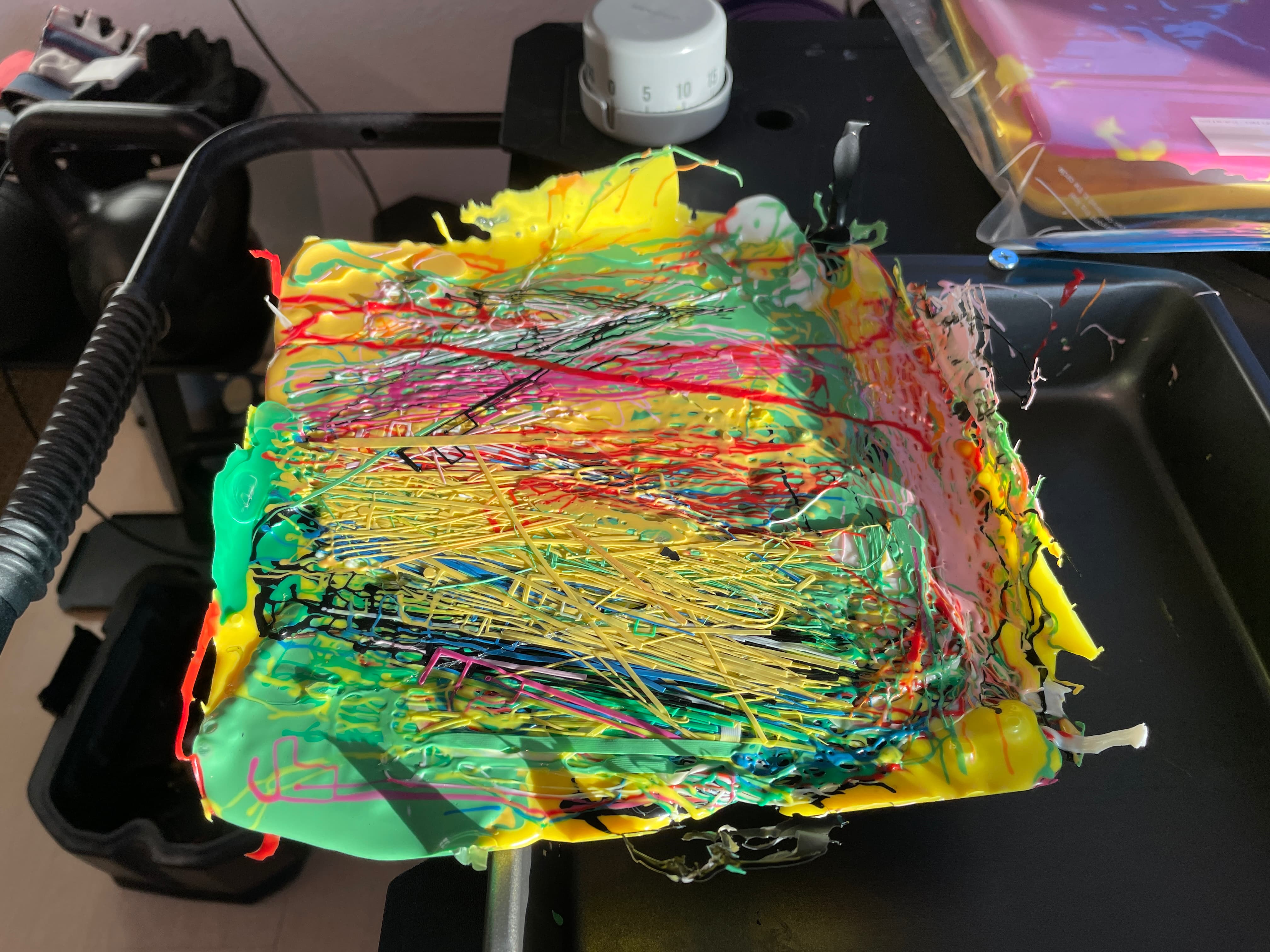

After the Aquarium and fire builds, I decided to work on mesh editing and do a large dodecahedron planter pot for my kid. With symbols from their favorite band, multicolor printed into it. Pretty fun, but I didn’t write it up as it was a ‘learning experience’, and personalized, so I didn’t want to show it. The pot came out pretty good though -
It had a large number of filament changes between white, green and black. So the poop begins…

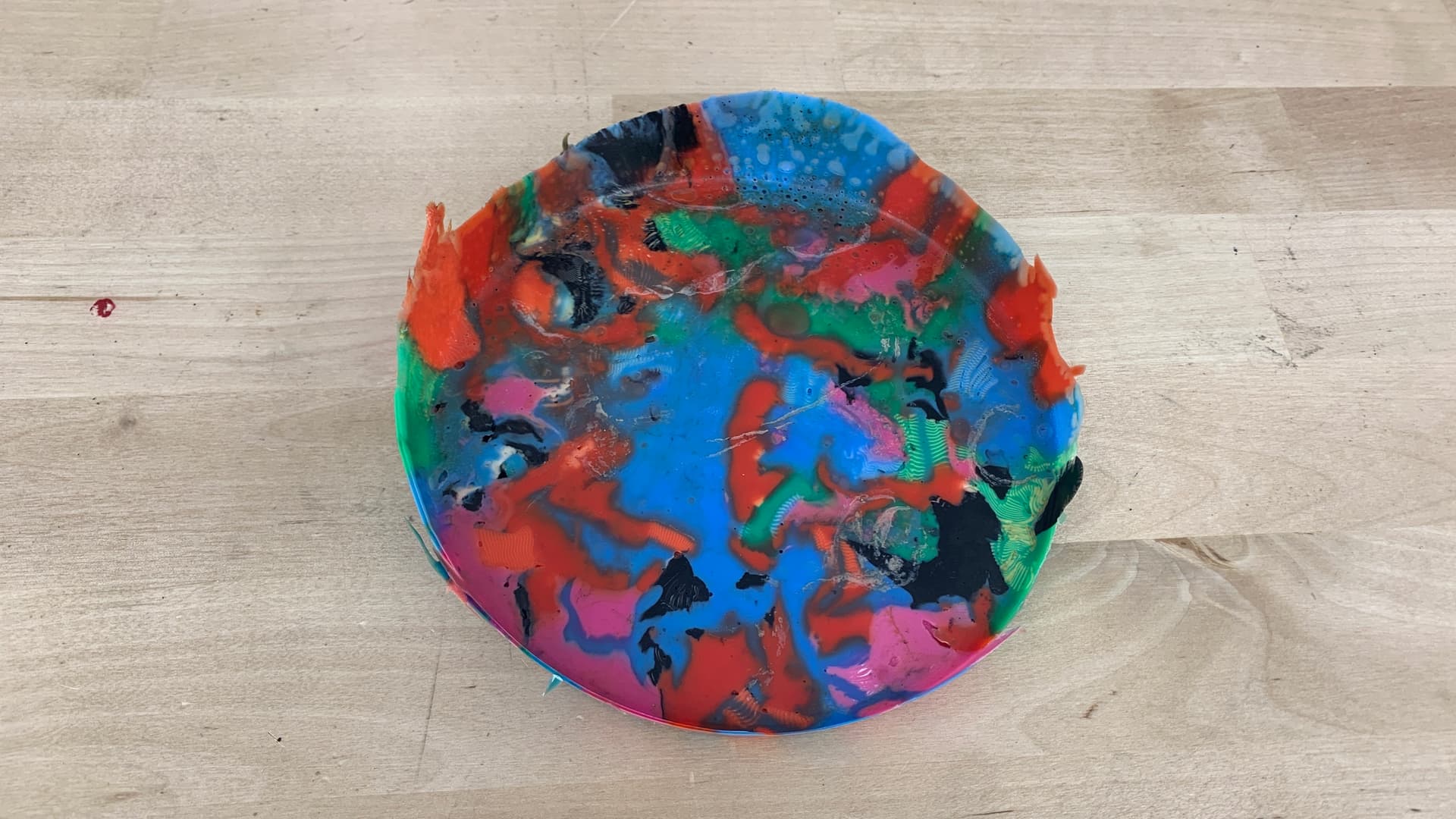

‘First’ melt at 176 grams 400f for 15 minutes.
Since it took 30 hours to print, ya, it had a lot of poop. ‘Second’ melt - Add in the rest

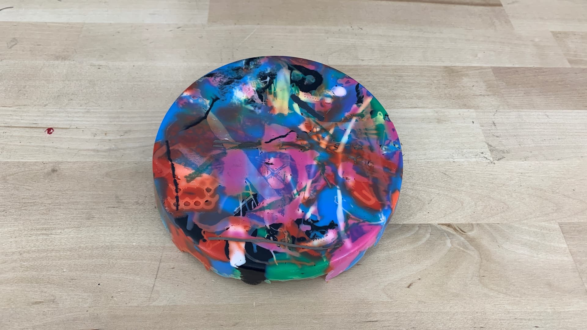

At this weight, and 7" x 7", that’s about 9+mil thick. So it might be too much, but I’ll figure that out later. Put back into oven at 400f for 15min. Remove and nest marble filled pan on top. Put back in oven for 45 minutes.
Let cool. Wow, this thing is definately hefty -
This is way nicer than I expected -

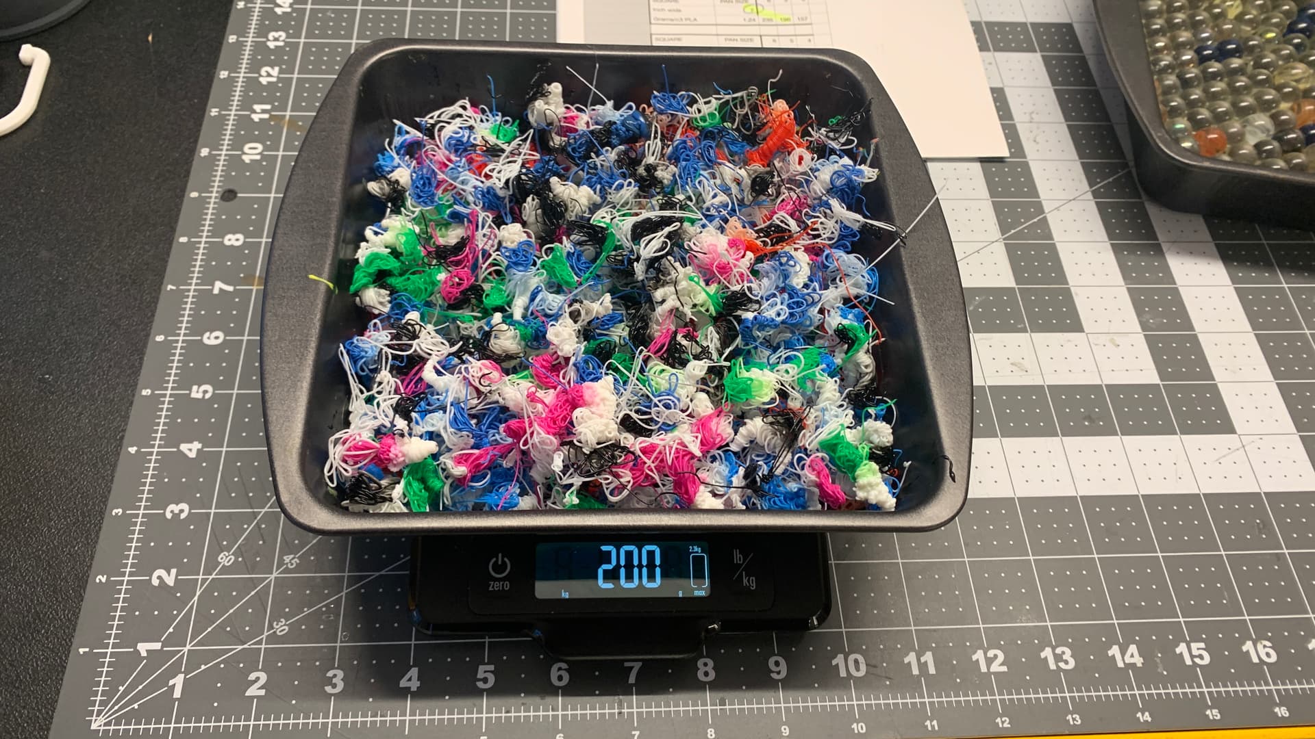

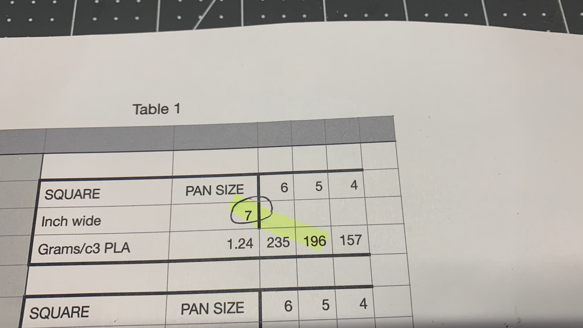

Choose your pan by weight, I ended up with 190gm, so 7" x 7" at 1.24gm per c3, equals roughly 6mm. Perfect.
And prepare your dish. It’s like plastic Lasagna.
Sprinkle with more southwest colored goodness.
And fill with, well you know, poop.

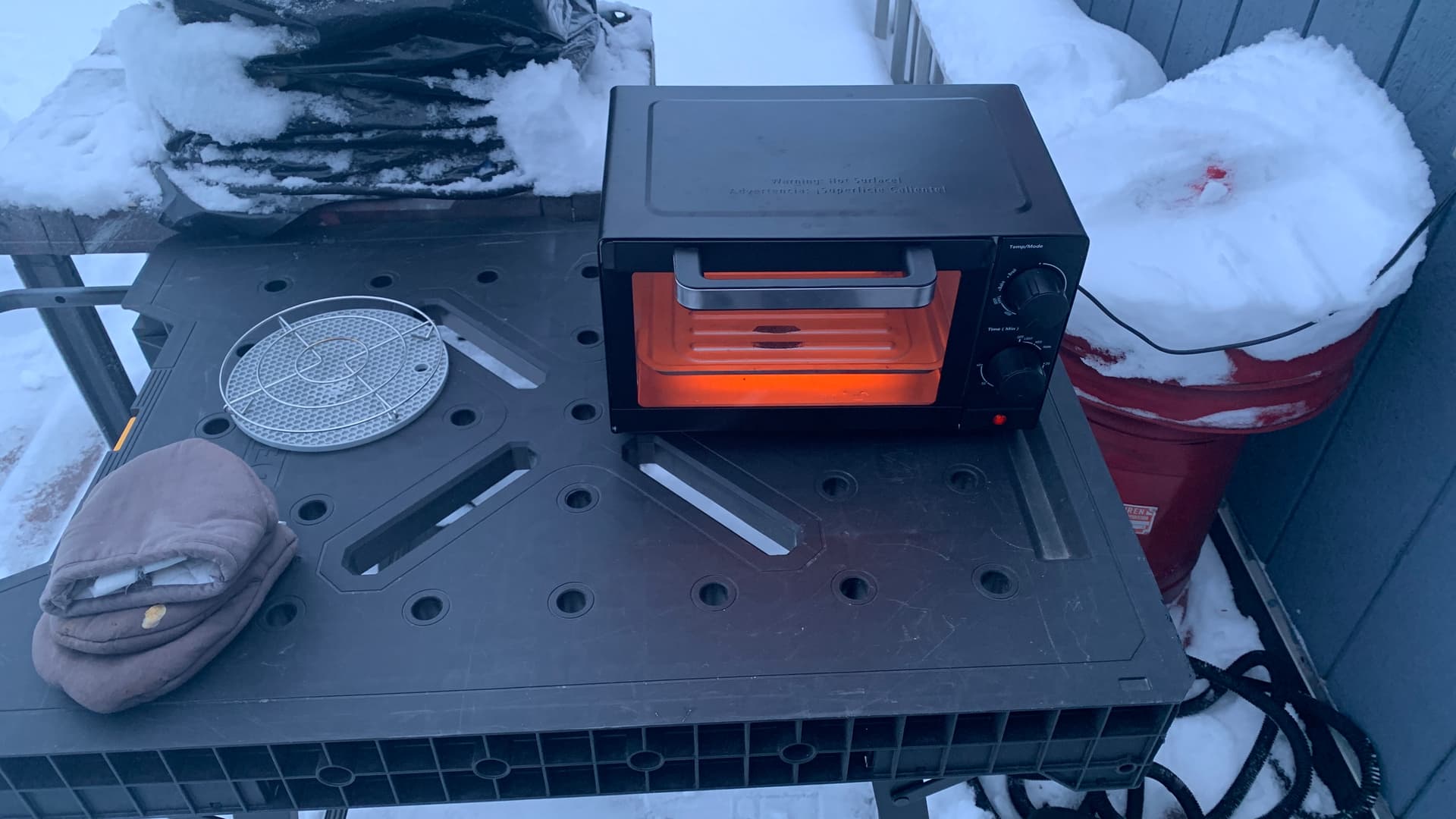

In case anyone is still interested in where this ended up, so far, here’s an update. I wanted to get all the old PLA melted into plates, and then cut into medallions, for future use. I’m also slowly working on a plan for a heated stamping mill of sorts. Anyway, here we go -
Melting station set up - with hose just in case. :wink:

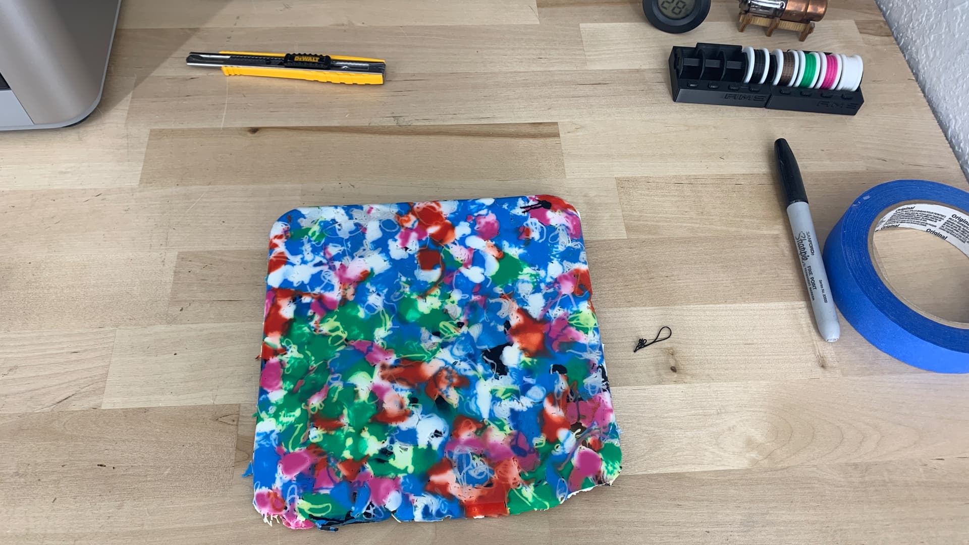

I then figured out, the left over ‘Square’ can be broken into pieces and remelted into the small circle mold, to yield 7 more 5-6mm (thick) coins. So (re)melt - Round two - cutting the square remnants into smaller circles.
After the PLA has melted twice, it’s starting to get brittle and the white in the ghost poop is getting brunt a little. So that going to be it for remelting. Final Total - 196 Coins.
Cool. Some were sticky and had PLA residue and such. So I washed them really well in soapy water and set out in the sun to dry. And here we are -
Some fun and usable base for another project, and another day.

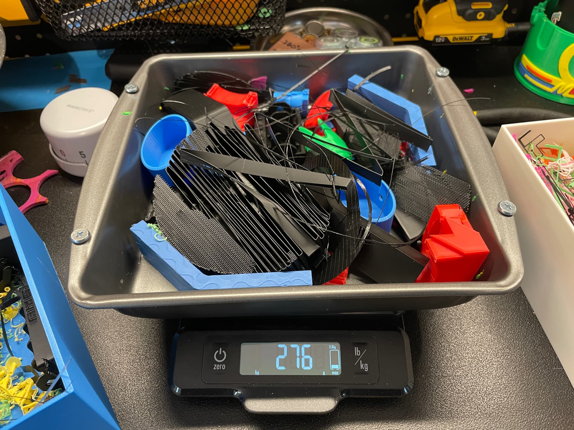

Chunky waste 3d batch - too lazy to chop
Bling -

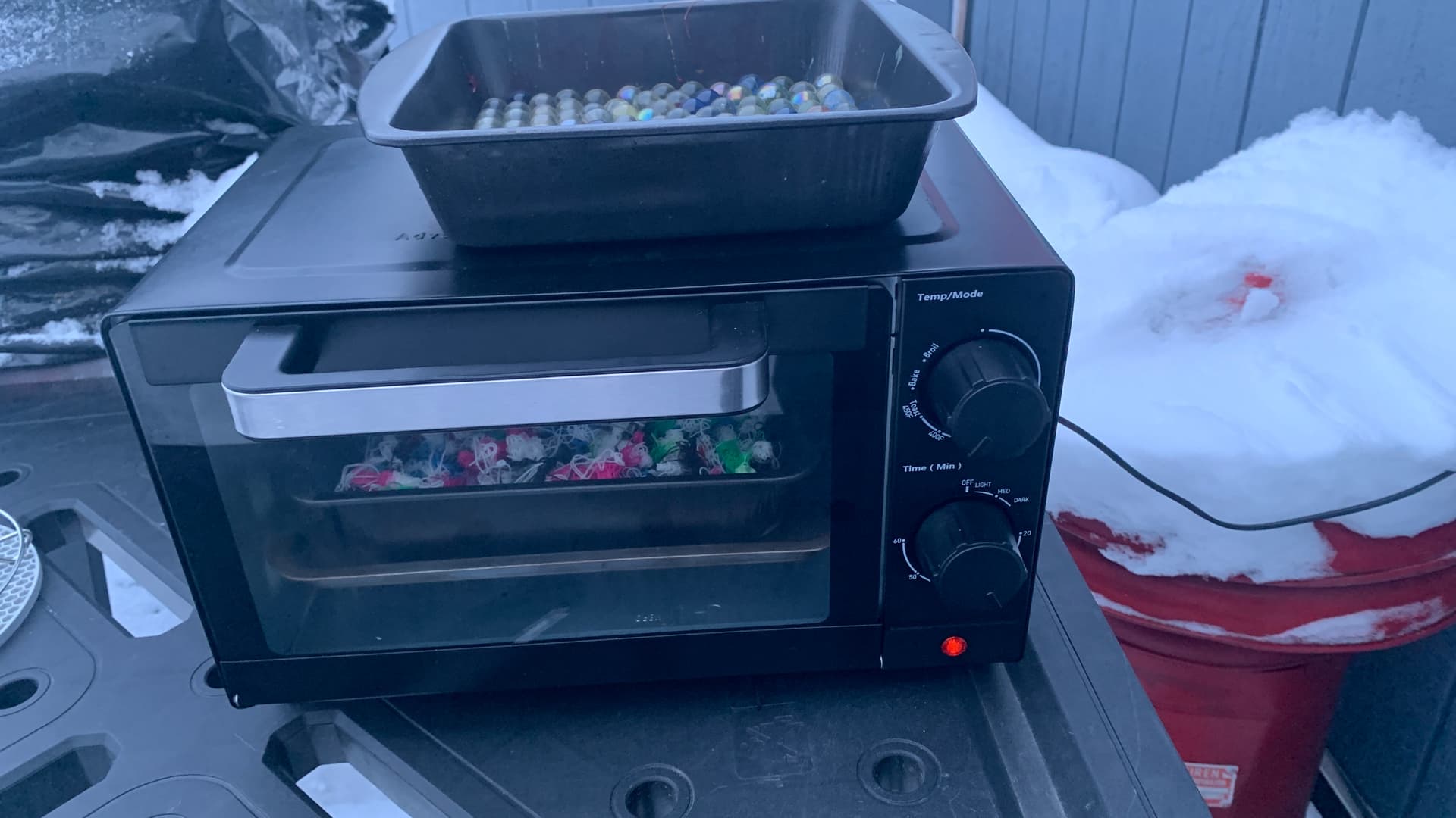

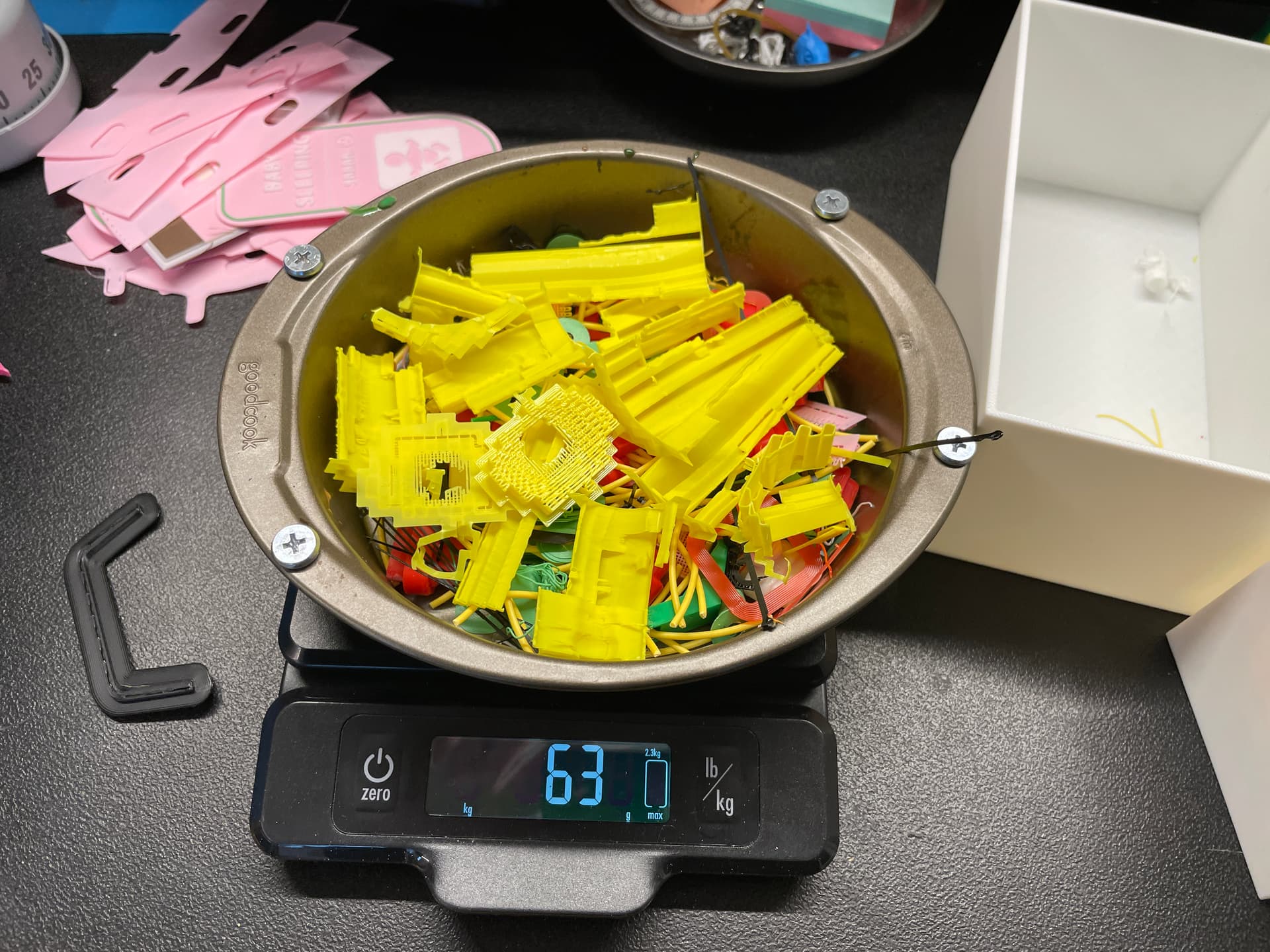

Thought I’d do a quick update to this thread since this last weekend I ‘splurged’ on a new oven and pans to speed up PLA recycling. I had been using the old $20 standby oven, and it did great for small, one at a time, batches.
But I’ve been 3d printing more and got some waste to melt down, so time to upgrade. Now we’re talking.

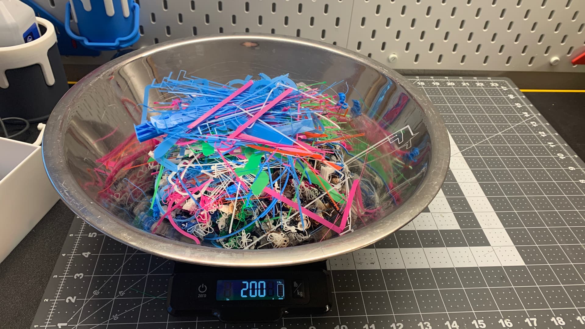

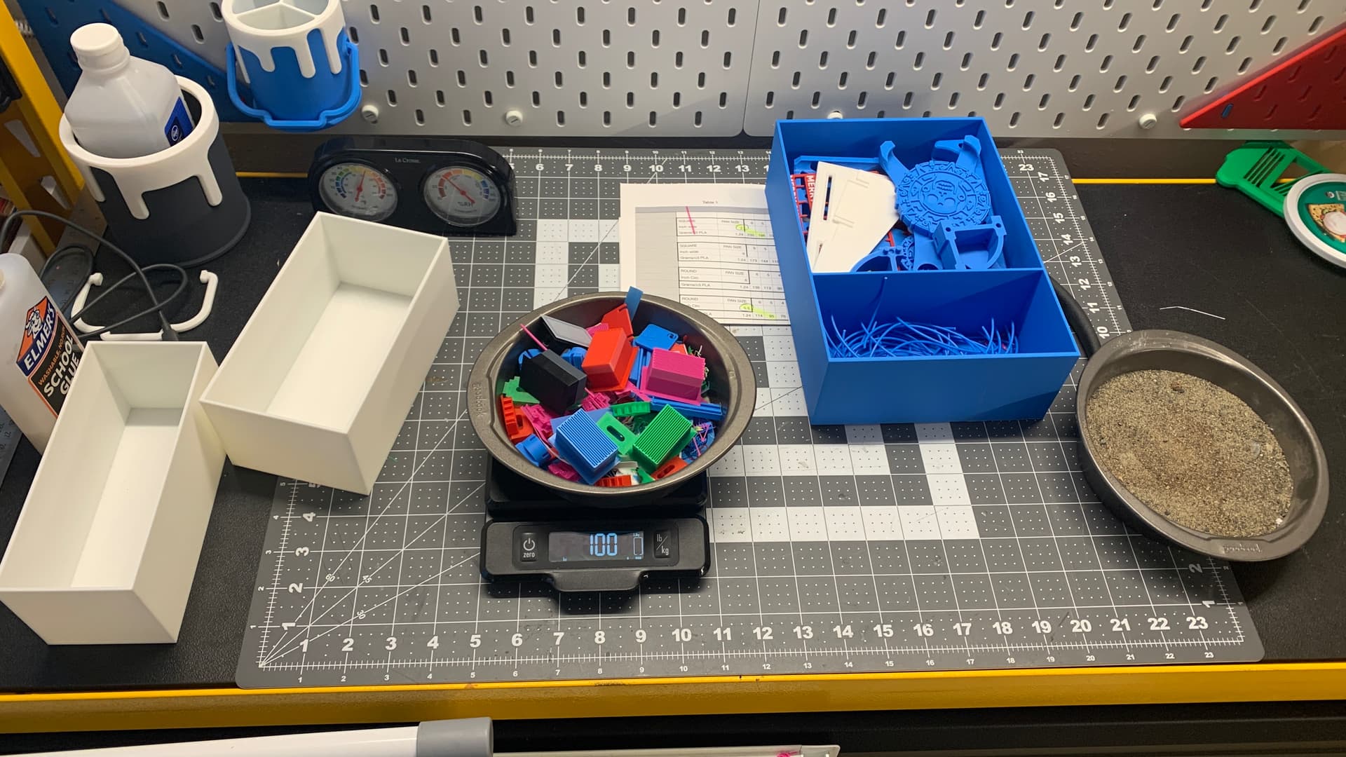

The old oven held one pan at a time, of either 5.5" round, or 7" square, for 100 grams or 200 grams respectively. Then new oven will do two 8.25" pans at a time, each holding 270 grams. So let’s see what we’ve got to start with.

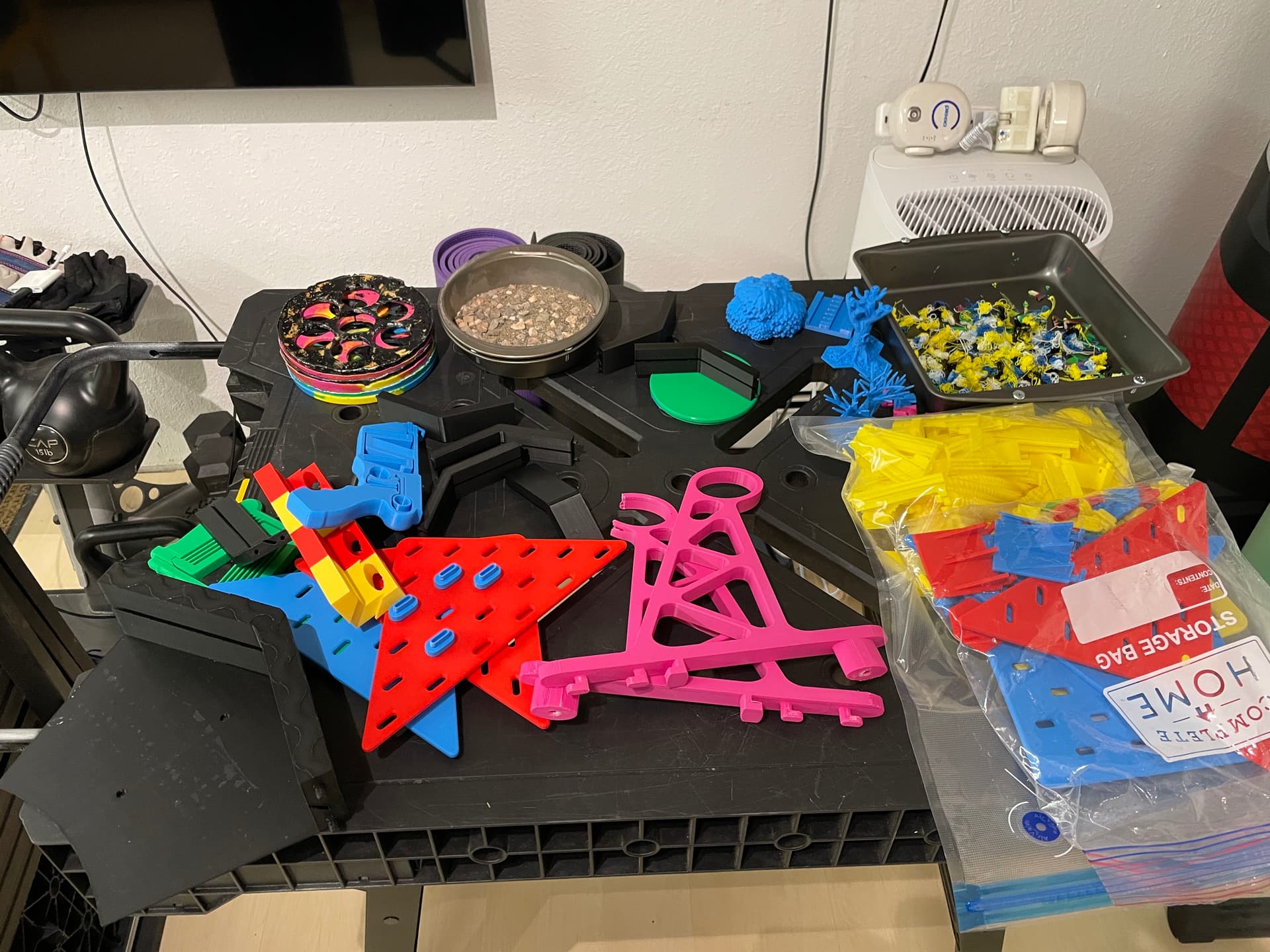

Ok, normal stuff. And I’ve got a couple bags of ‘poop’. So let’s lay out the first few batches -
To quickly recap, the melted ‘slabs’ need to be apx 5mm thick, as that is easy to laser cut into round coin blanks. So I did the math based on density of PLA and a given pan size, and this is a pretty good guideline -

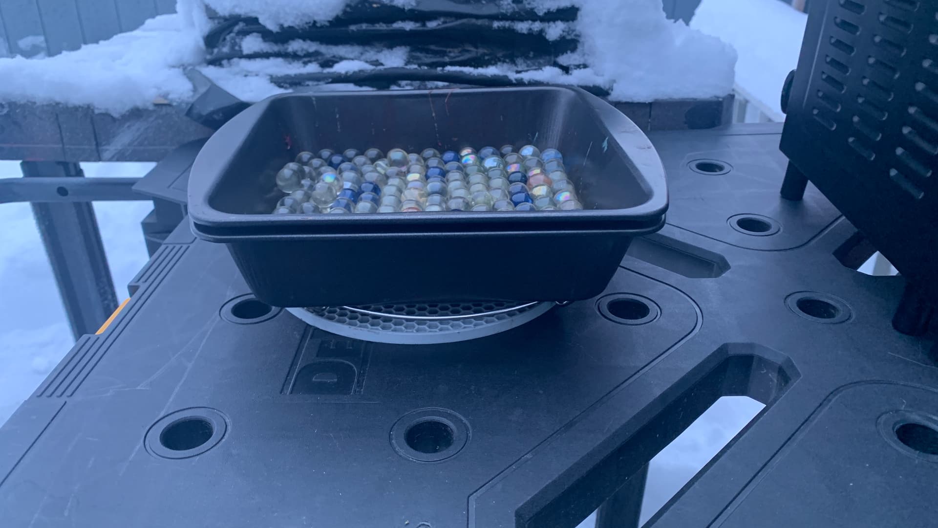

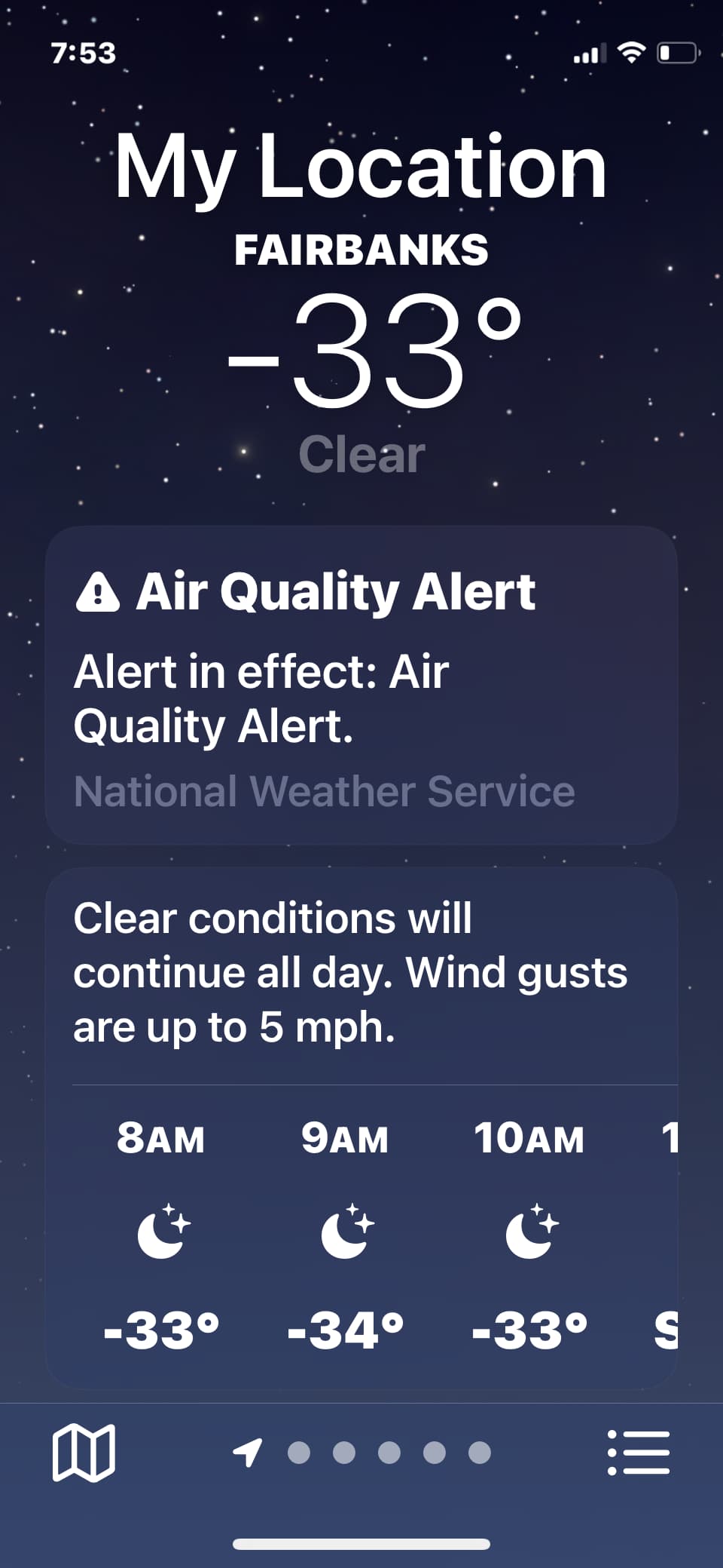

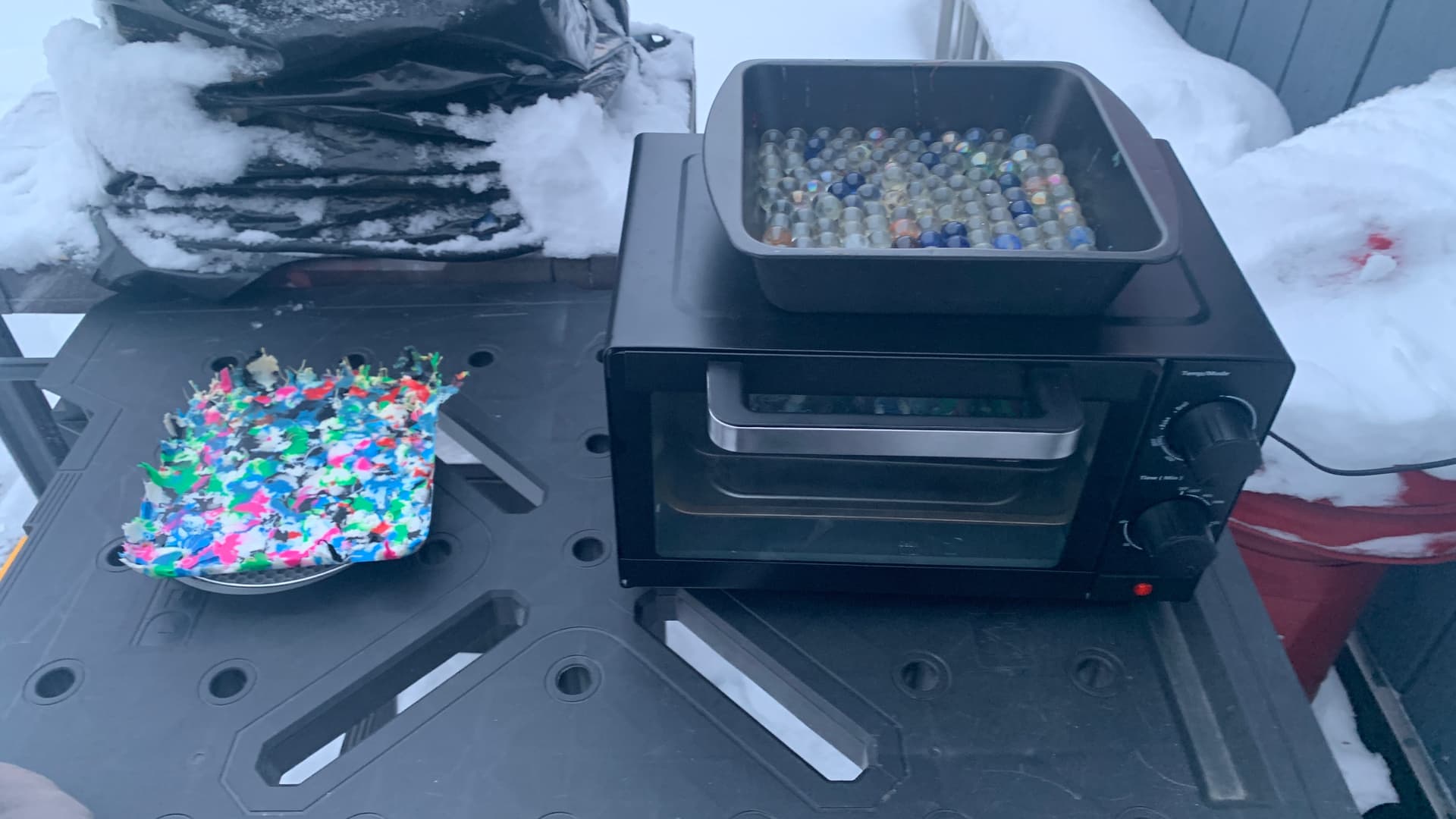

Weather check - Not bad. Suppose to get cold in a couple days, so better do this now. -10f is a decent temp for still working outside with just a pull over, and no gloves, for short periods while tending the oven.
Preheat - And new cooling rack on top. Pretty fancy! :slight_smile:
Let’s do this - Bam, two at a time! And, I can just load the melting pan with the weighted pan at the same time. So no need to open the oven door half way through.

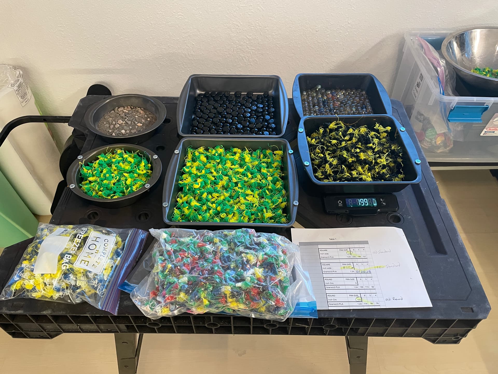

First few batches I’d call a success!

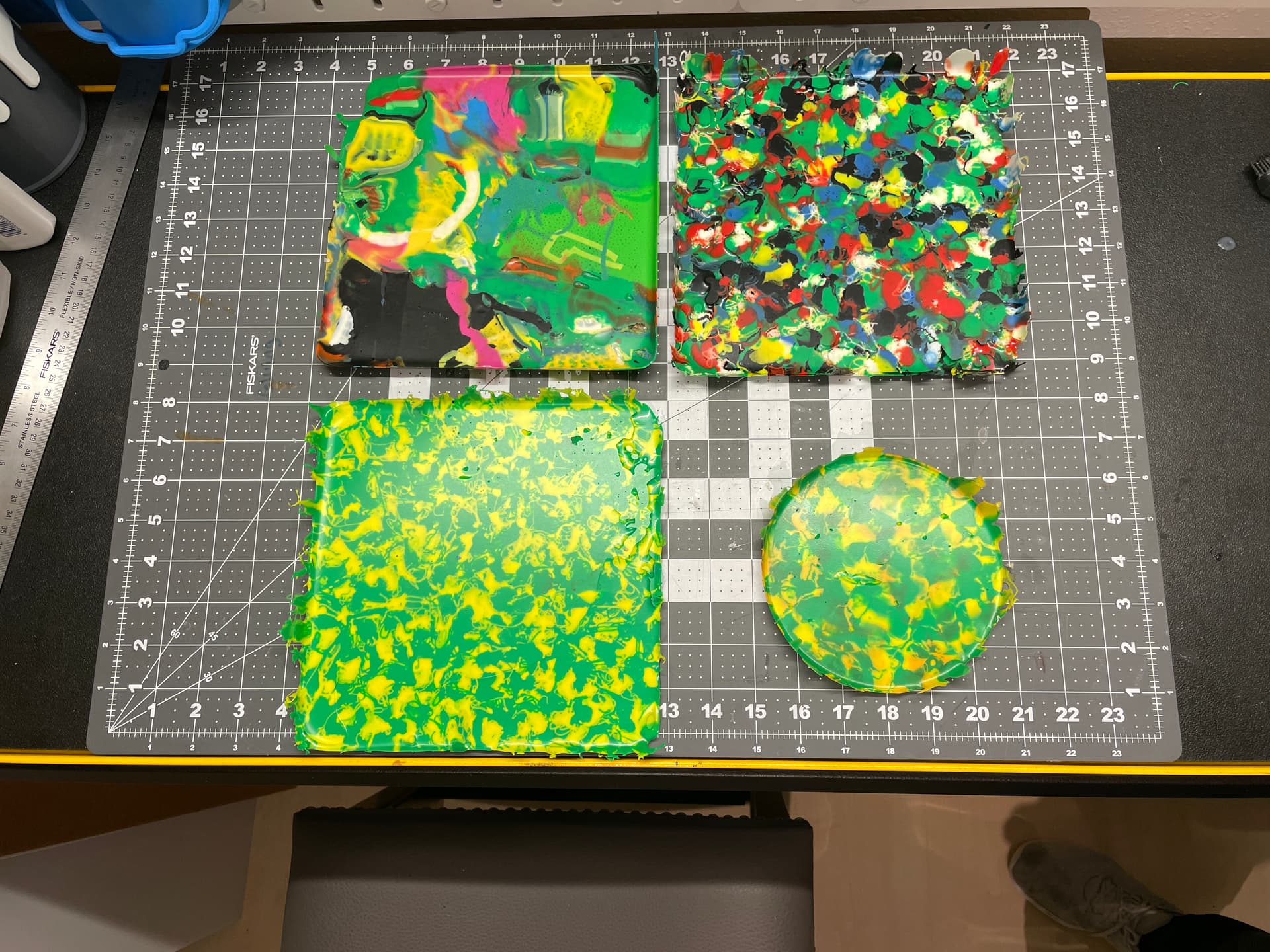

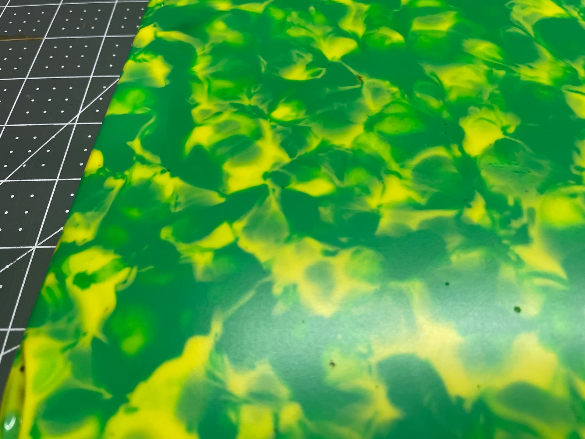

The green and yellow, Corn Poop, definitely came out fantastic. Front side -
Back Side - This will make beautiful coins -

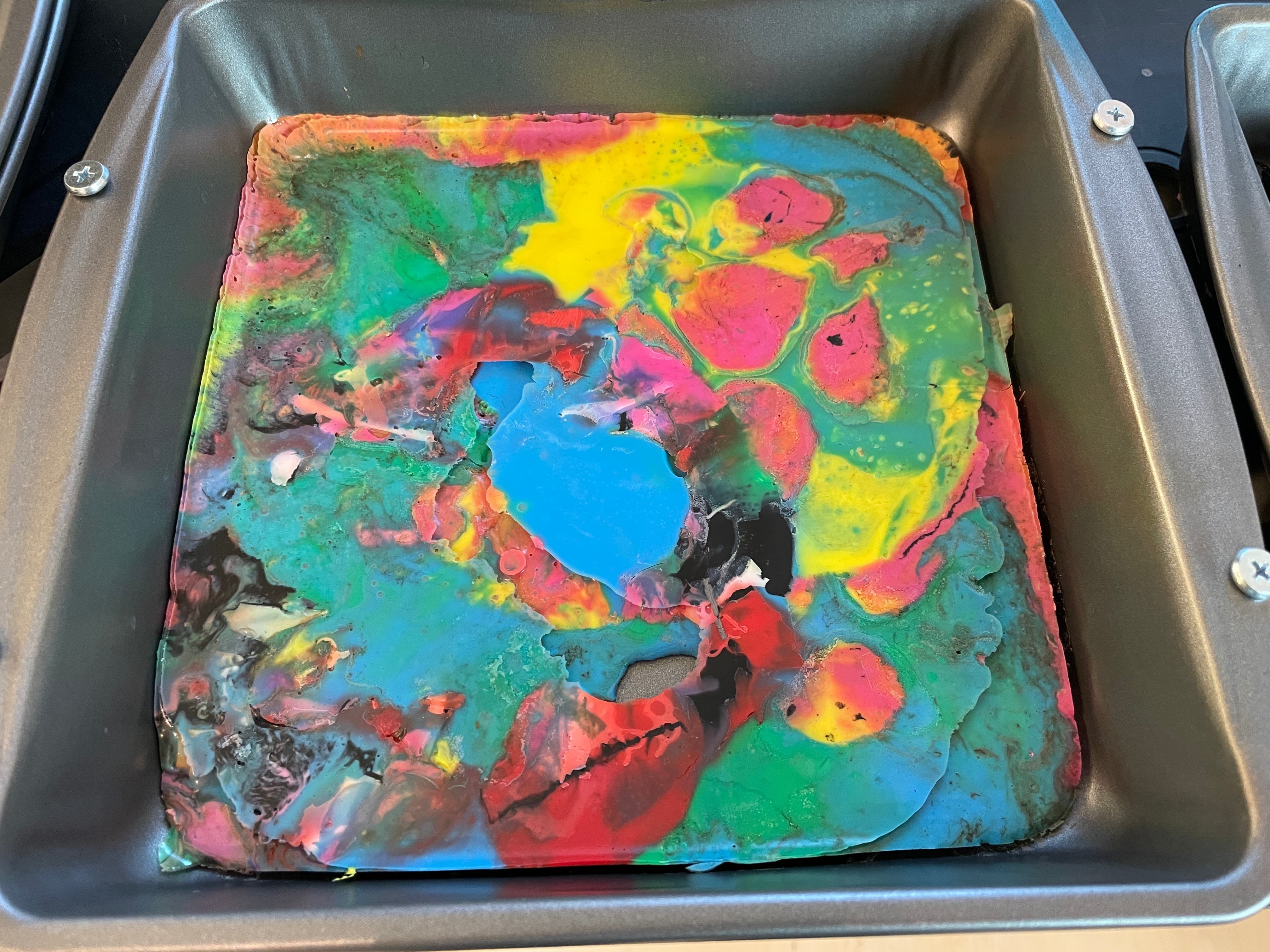

Even the ‘Confetti Poop’ full mix of colors came out great -

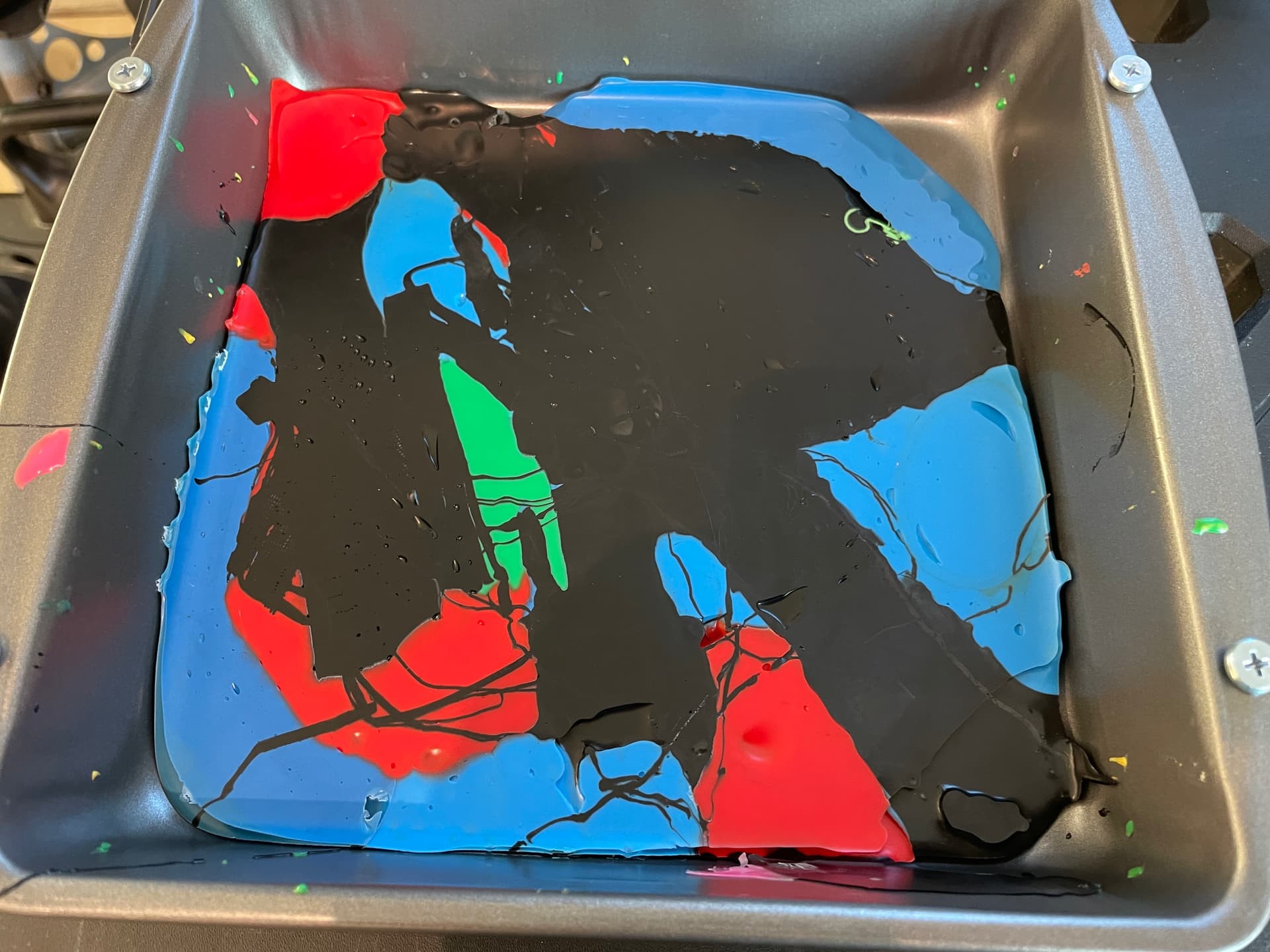

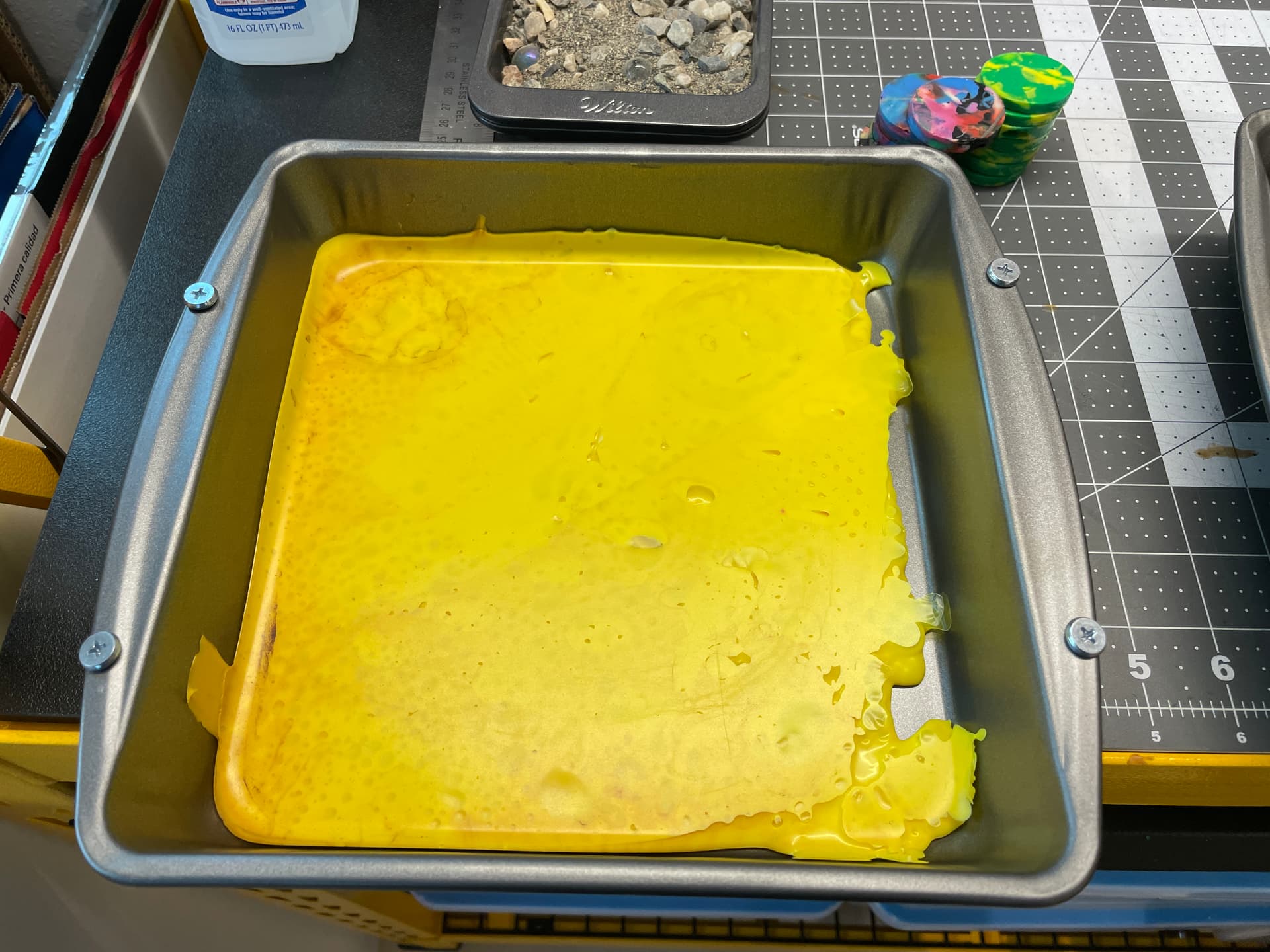

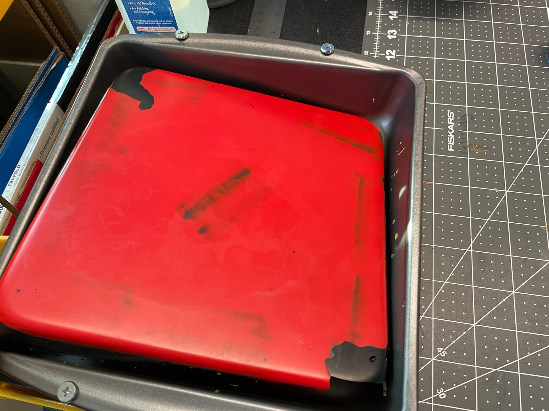

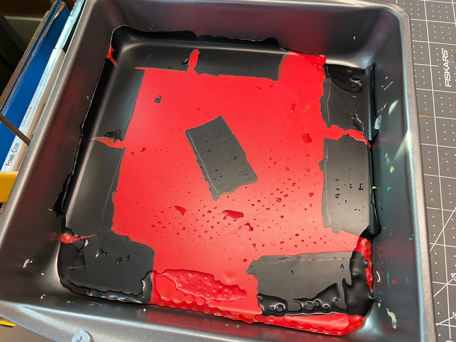

Alas, I had trouble dialing in the heat with the smaller, old square pan, and burned that batch. So disappointing, that was going to be my bumblebee coins. Alas, was not to be.

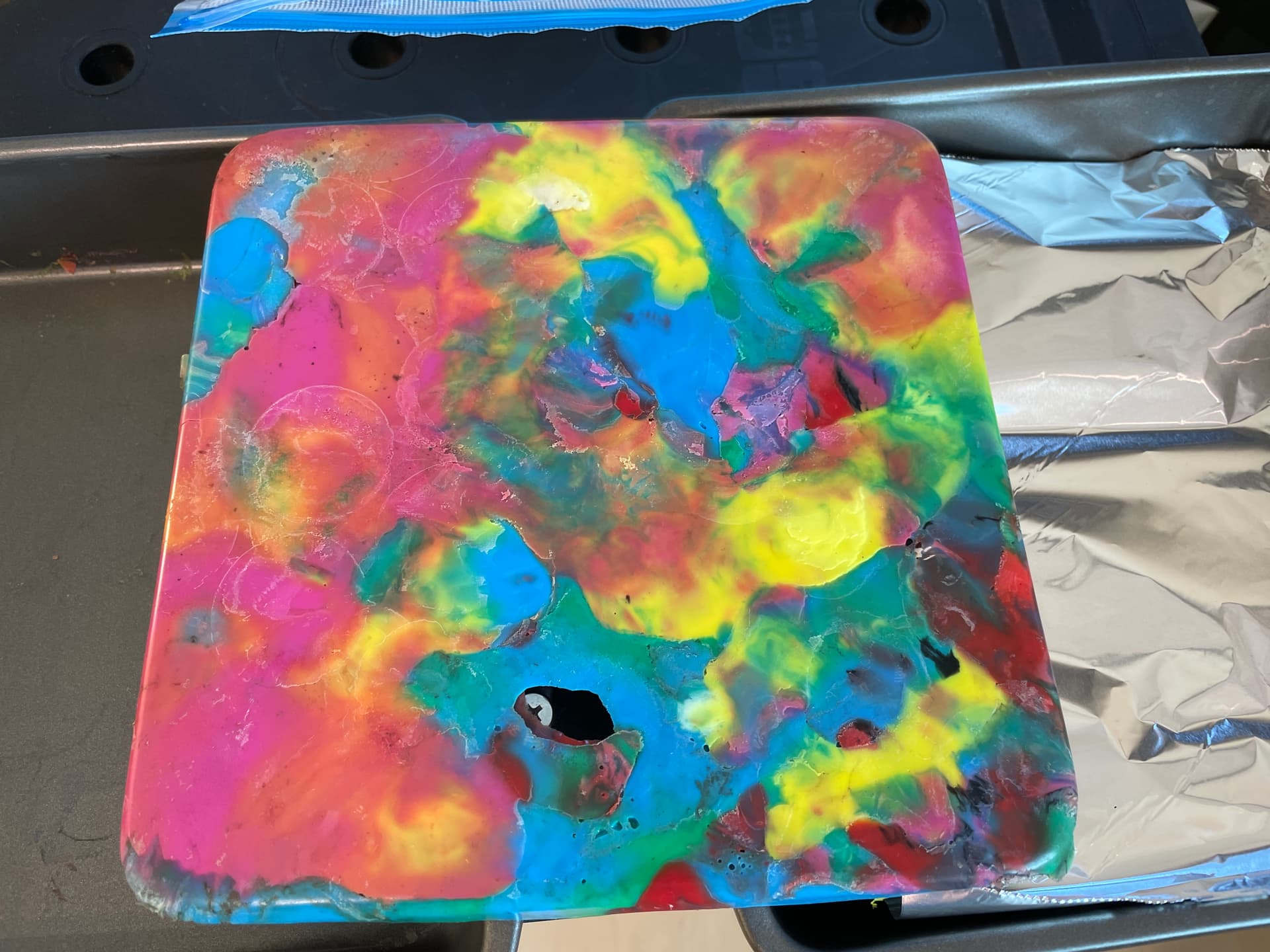

Nice! I feel like this one:
is so dramatic at the full scale. I wonder if there’s anything larger you can come up with to use it for and preserve the abstract/impressionist look of it!

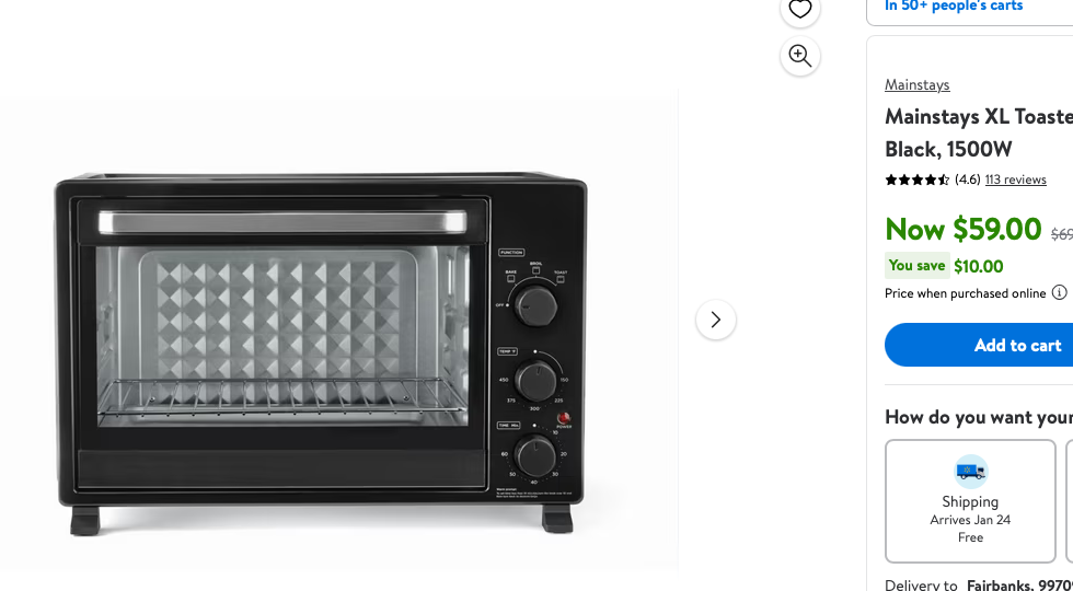

I too got a new toaster - after suffering along with whatever I had for so many years. I had no idea how much of a difference it makes! Better insulation, better temperature regulation, bigger on the inside, and on sale I think it was $40. My only regret is not coming to that realization way earlier!

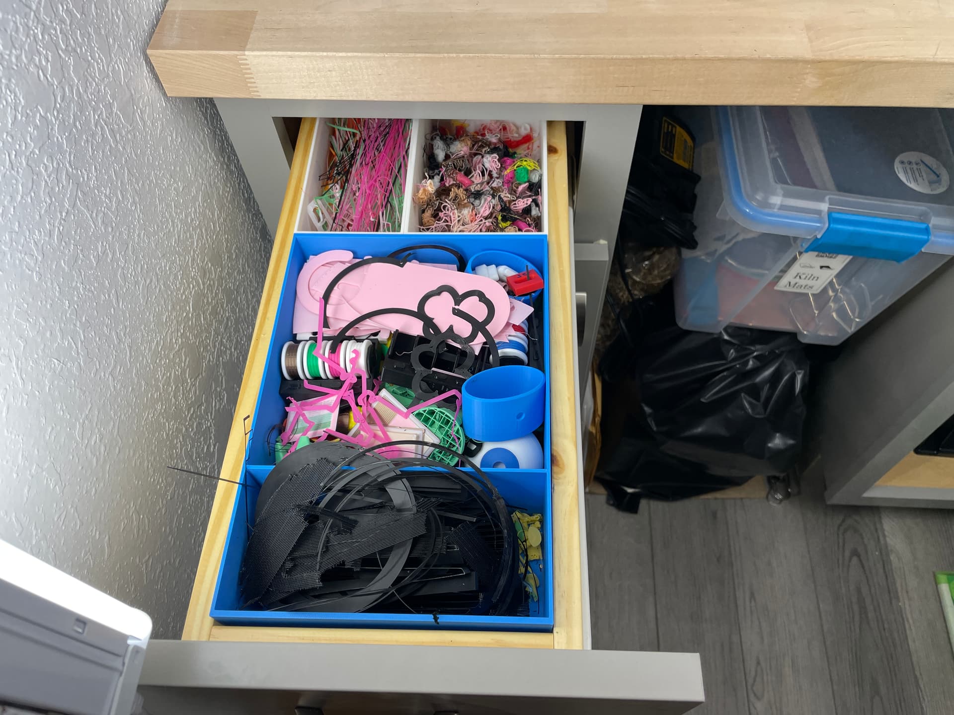

Your organization skills of even your waste leave me feeling a little sheepish. lol

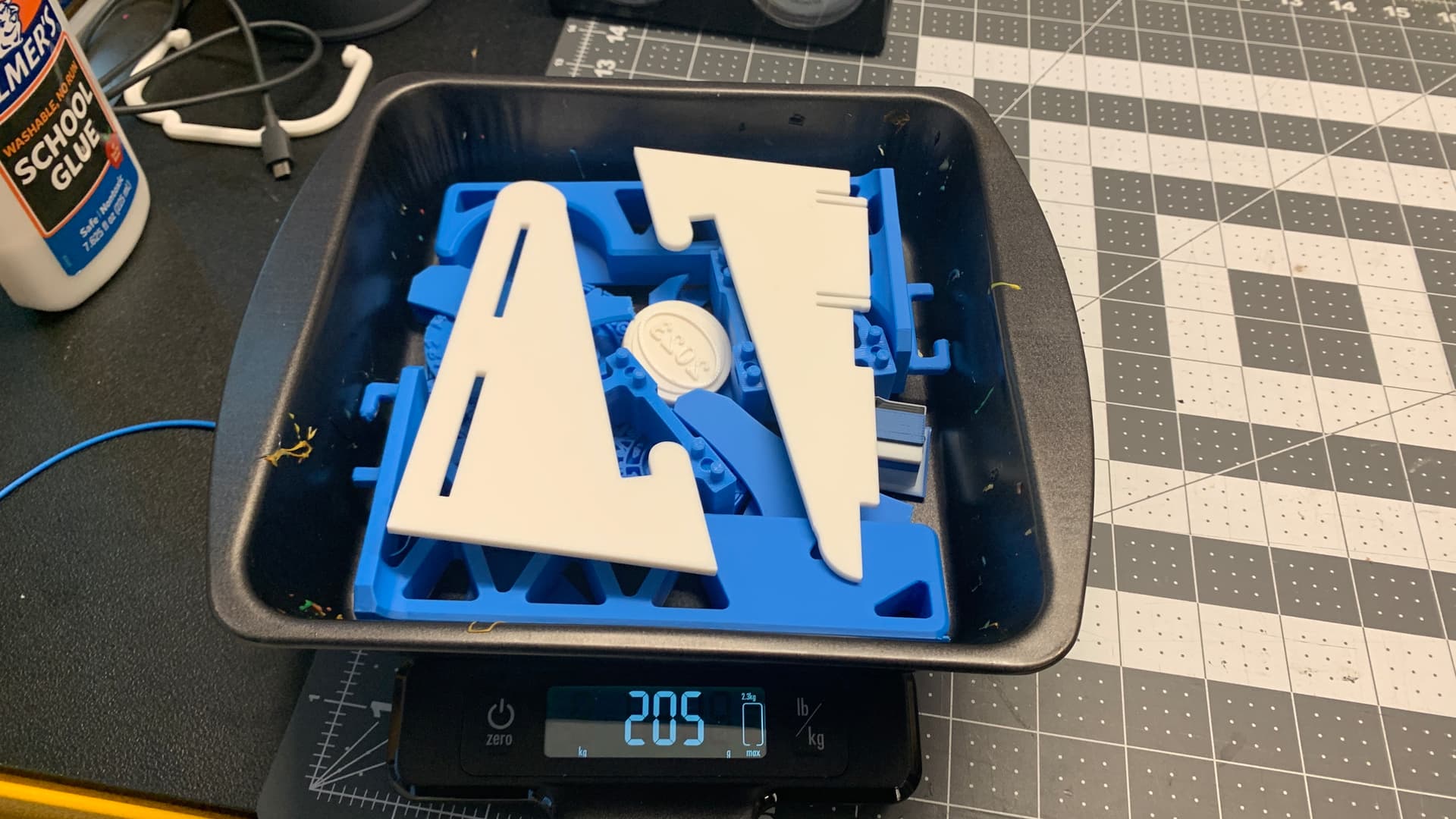

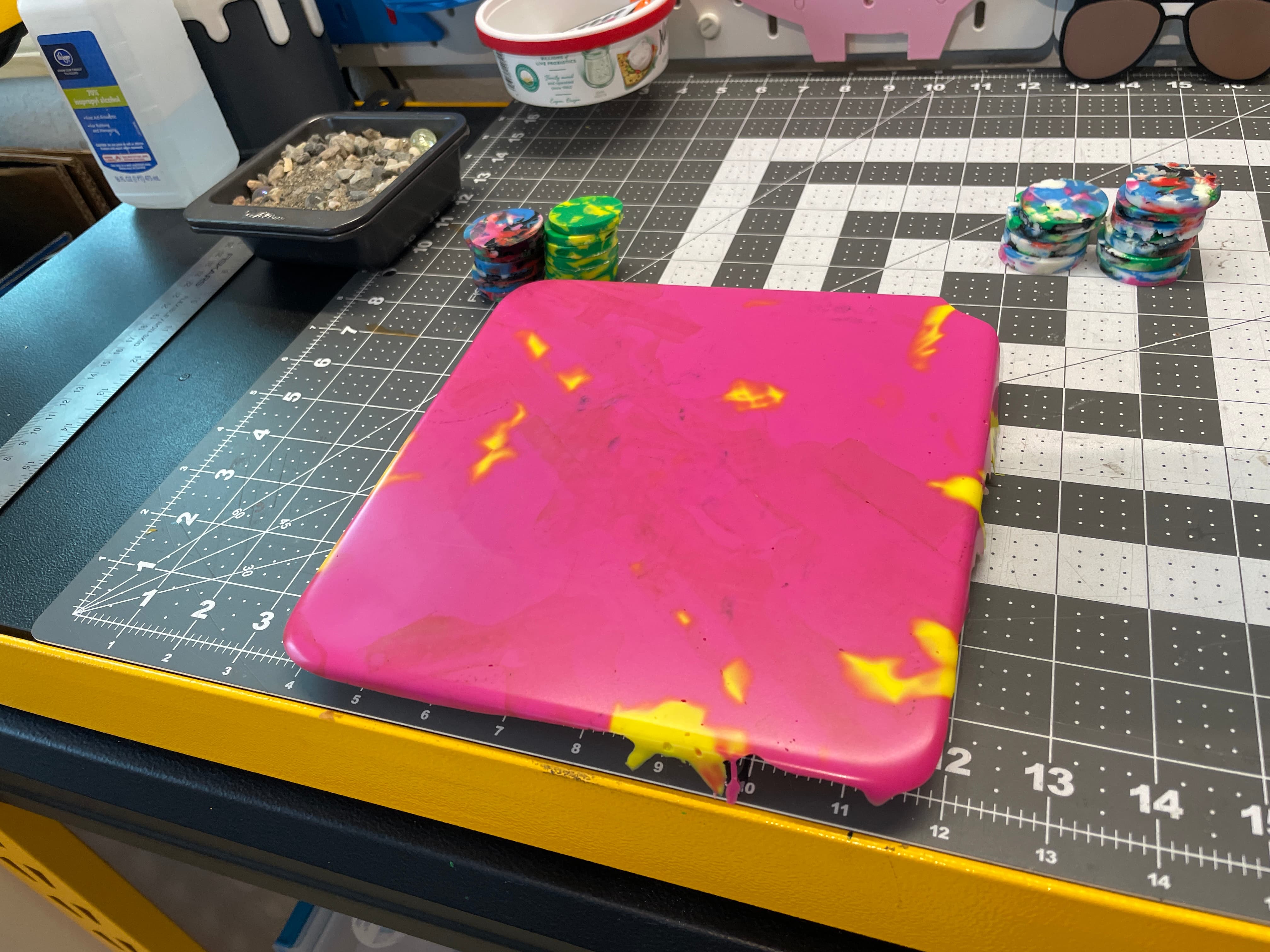

You know the process - Grab a piece

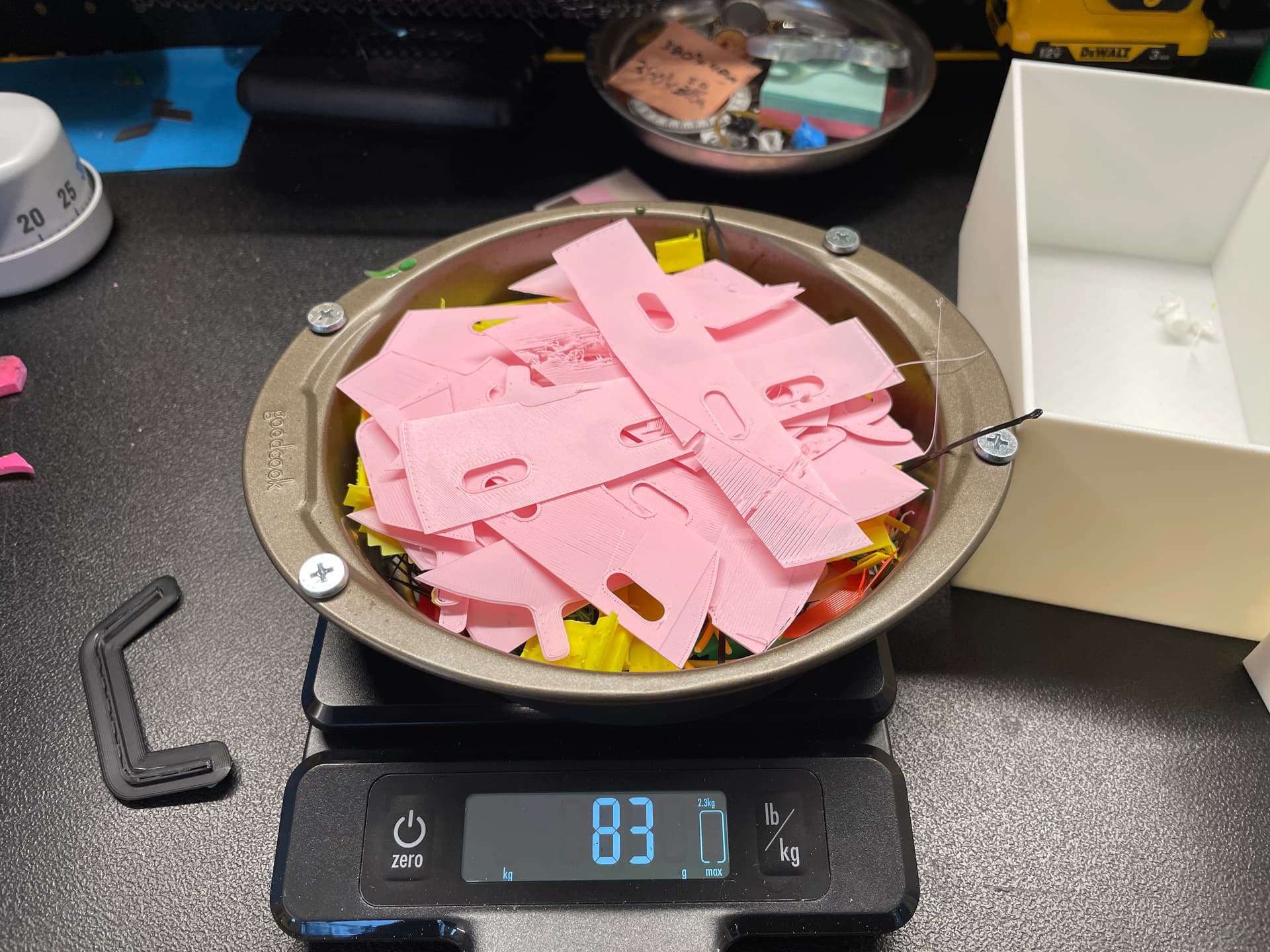

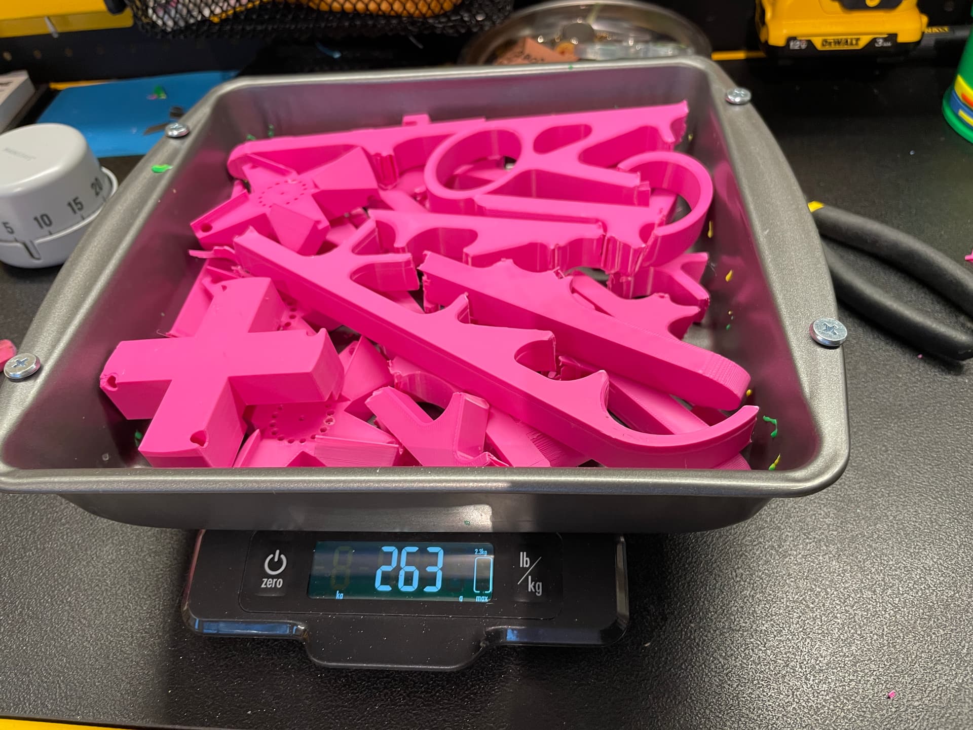

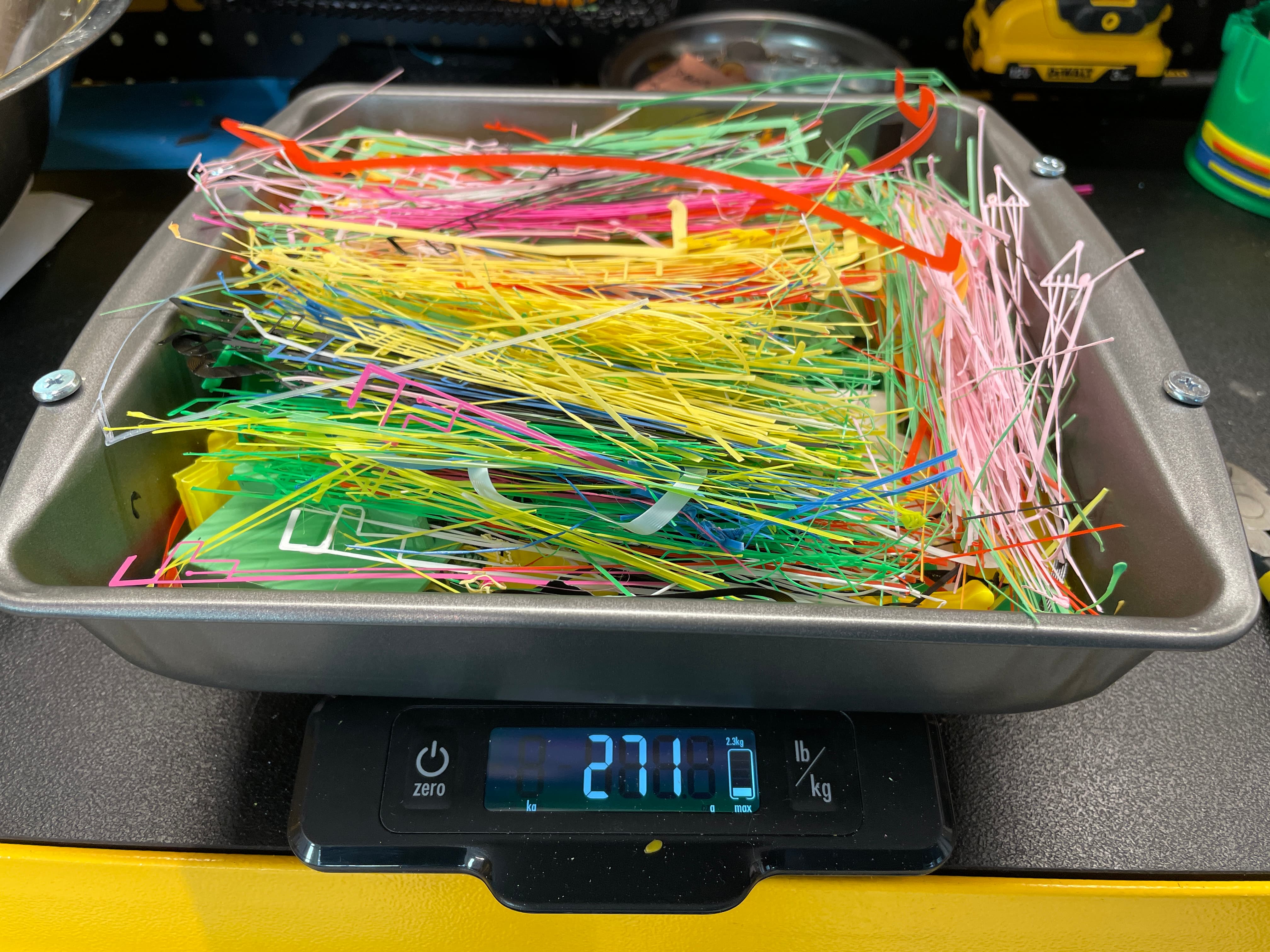

Break it down a little, grab some more Magenta and load a pan to 272 grams
A little short, so sprinkle in some yellow love -
That’ll do -
Into the oven, and when done - Meh

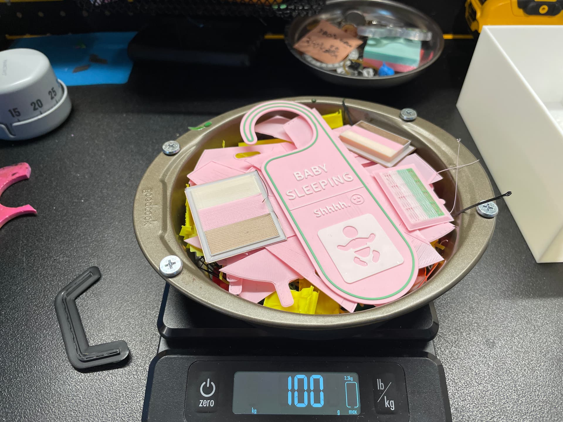

I’ve got more interesting things - Like a 100 gram small mixed batch -
Add a yellow layer -
Some pink -

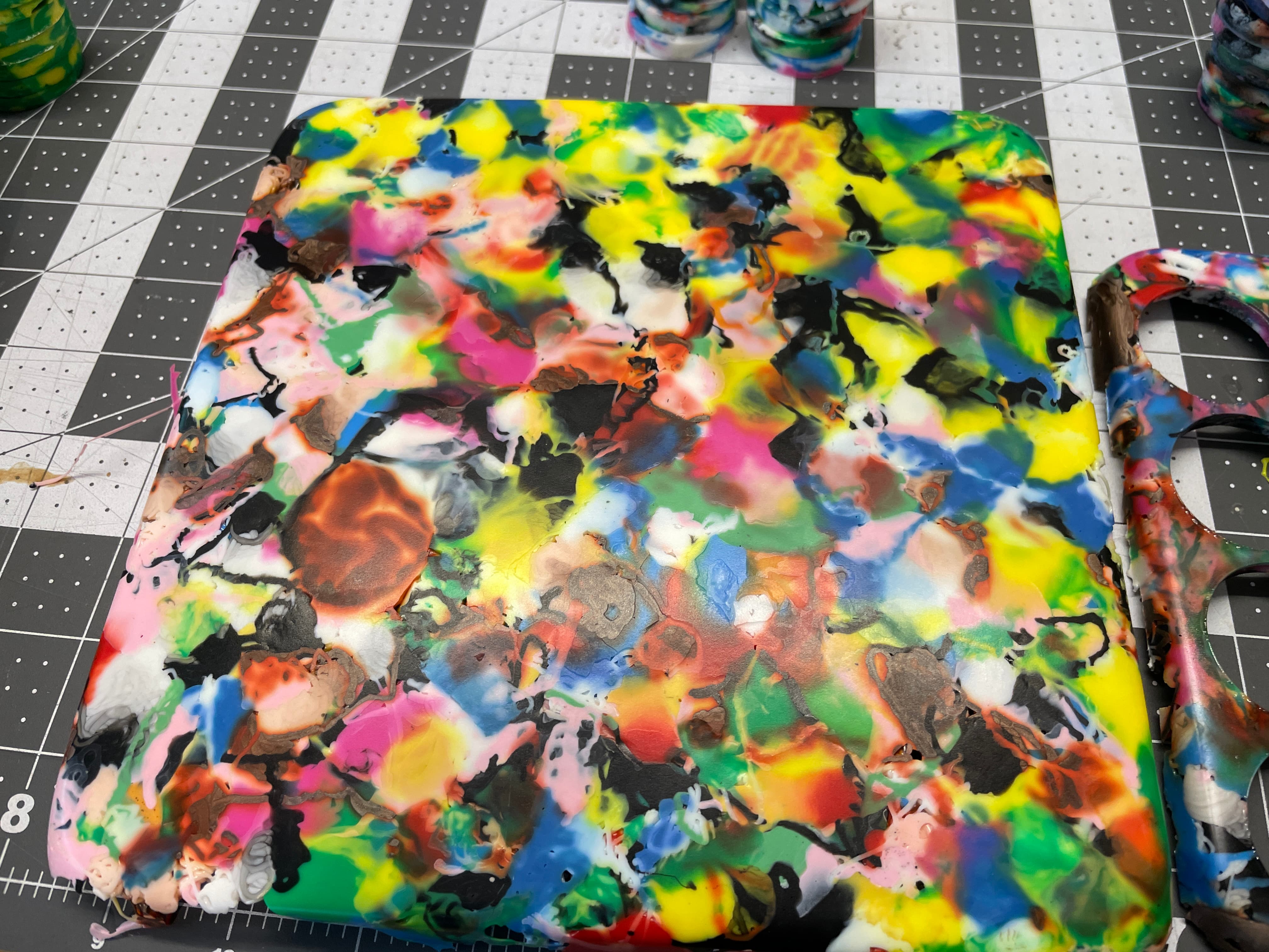

Kind like melted galaxy
And who doesn’t like a party -

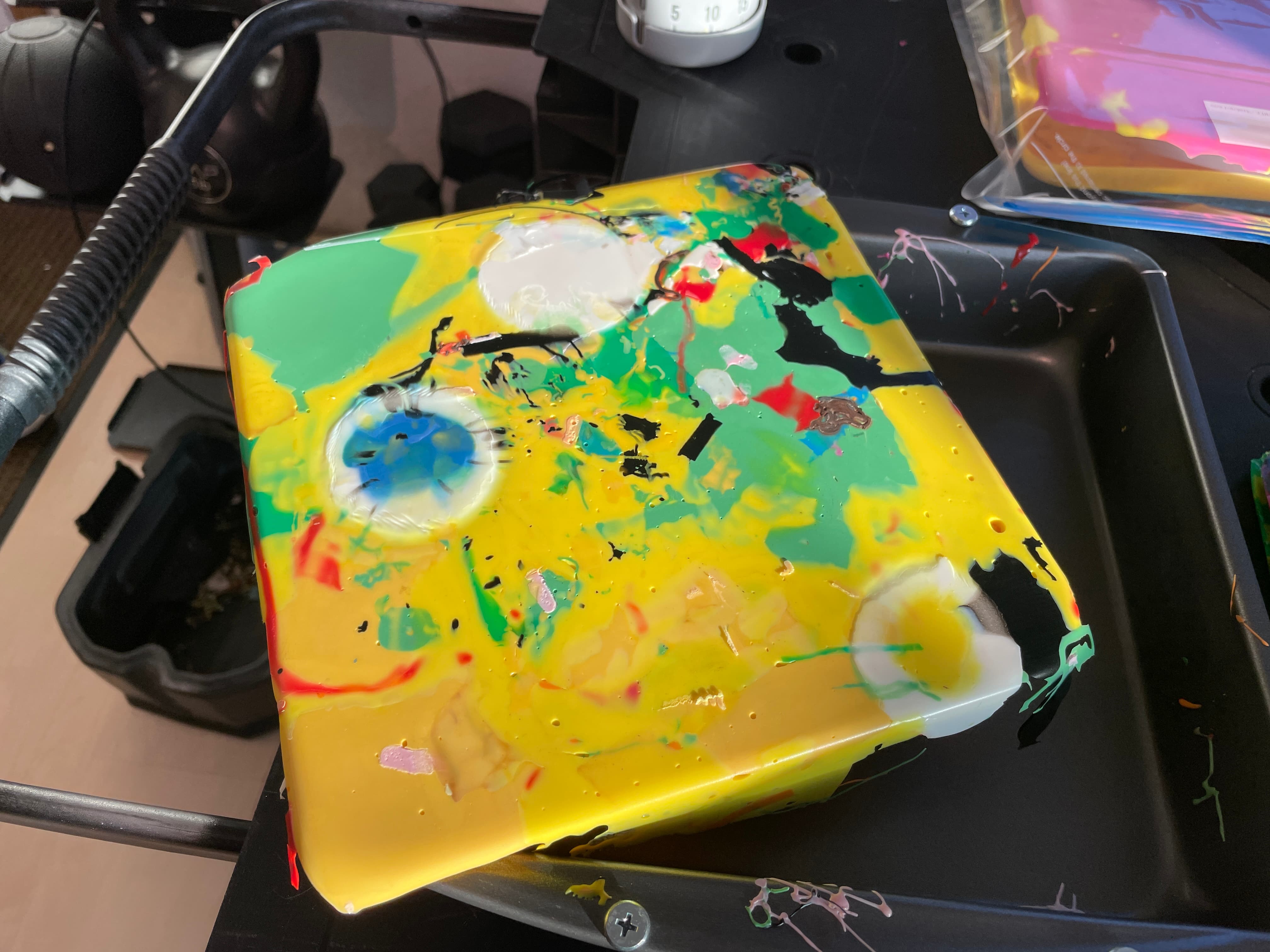

Whoa. This could have melted a touch more, but it’s my favorite of the day.
I’ll call it - SpongeBob roadkill. :slight_smile:
