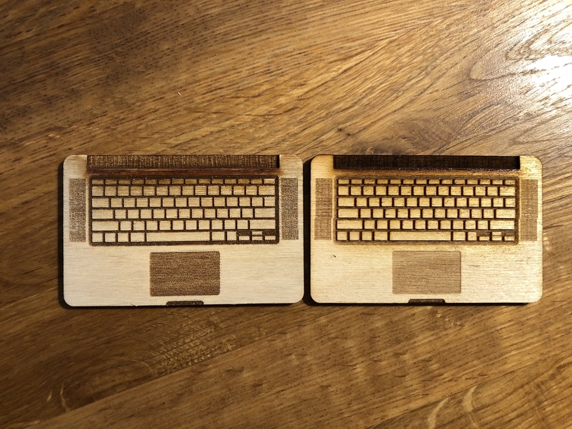

We’ve had an issue where there’s a shift about halfway through an engrave. Moving material in the bed makes it seem like it’s in the same spot on the bed. This made me concerned about my hardware. However, there’s a circle in the engrave, and there’s a cut that follows that circle and the cut seems to have no shift, so it seems it’s in the software. This is a graphic a friend is engraving. The file has a .png in an svg. I’ve done a few engraves on my machine in the past in the same location without a shift, so maybe this came about through an update?
If you are seeing something unusual in just one file, that’s the first place to look. But if you see it happen in other engraved files in the same area of the bed, then it’s probably mechanical.

In the first image you can see the shift. My friend had the cut setting too low because he accidentally set the power to one. So in the second two you can see how the faint cut line continues the circle how it should be cut. Luckily he had the circle on there so we could actually see the cut line would have been correct. The subsequent engrave had the same error at about the same position on the bed, but the final version that worked almost perfectly had it in a different spot, but one that might have made sense with what the file does, which is what leads me to believe it’s an issue in parsing the file or at least something in the SVG that produced this.

OK, so I just started doing a different file with an engrave. I thought it came out a bit spotty on the first one. It turns out this time, the UI set my engrave to draft photo. OK, so I set it to SD Graphic and set it to go again and the shift happened again. Now I’m doing an HD graphic and it’s past the same point without an issue. Is there something going on with SD graphic engraves?
HD Graphic is fine, although strangely the depth of the curved sections of the background of the keyboard is better in the SD engrave so I guess I’ll be experimenting with manual settings.

@chris1 @Tom_A I respectfully disagree. For one thing, the graphic starts off offset, then corrects itself. I know this because the cut lines have no skips and the part after the skip is correct. So somehow every time it would have to get messed up again after it would be seemingly correct on the last step. For another thing, it only affects SD engraves set to Medium Maple Ply. I too have only used SD until this issue cropped up—though I may have only ever used it on Medium Maple Hardwood in the past.
However, the final thing that leads me to believe this is software related is that it seems to happen in a similar position on the engrave, scaled by the size of the final file. So I compared their ratios. They’re not exactly the same, but I found something even more peculiar.
If you take the height to the error in whatever units you want, and divide it by the total height in the same units you’ll get a ratio. The larger cut’s ratio is .314285714286 the smaller cut is .285714285714. Obviously, the 6 would match too but it’s rounded in the first one. I would find it rather odd that an intermittent hardware error would result in cuts that have an error, not exactly spaced apart, but that are somehow offset from the same number. This is a calculated error. And I’m not saying it’s just on my machine. I’m asking if anyone else has had this issue. I don’t think every single owner is on this forum. It can be a combo of things, sure, but the fact that this occurs in this way seems software related.
I have changed the SD settings to 340 lpi instead of 270 and that error is gone. However, a second cut in the process—the screen of the laptop—set to 270 but 49% power instead of the default full worked. I am running just the screen now at basically the default settings and it’s fine. I’m going to make one more of these from the base file, and try just setting everything to manual vs leaving it on proofgrade.

So I set the file to run with SD Graphic changed to manual settings but left alone. It printed perfectly fine. So then I ran the same file and left the SD Graphic set as-is and it’s shifted over already.
The shifts are too perfect for something physical to be causing it (unless it happened every single time). That said, this shift is in a different spot. But this file is an iteration so I’m not sure if the ratio is bound to overall size, or if it’s slightly positional or related to order of cuts. Either way, getting that number is quite strange. When this one is done, I’ll try to calculate a ratio and see if another part of the sequence is produced.
Something to remember about skipped steps is that once you lose them there’s nothing to get them back except “calibration” (that is, finding the head logo at startup). This is because it is an “open loop” control system.
One of the things that makes this confusing is that everything is “correct” in a relative to itself after losing the steps and we’re apt to decide that the “correct” bit is the majority portion, but in actually a very common difficulty with engraved designs near the right edge is to lose steps very early in the process. So the actually correct bit is the stuff at the bottom that looks shifted right, but really it is the rest that is shifted left.

What this means, I have no idea. But on the plus side, I’ve at least found a way to fix it. So if anyone comes across this issue with an SD Graphic engrave, just set it to manual and leave it alone. So far that seems to work. I will report back if that changes.
