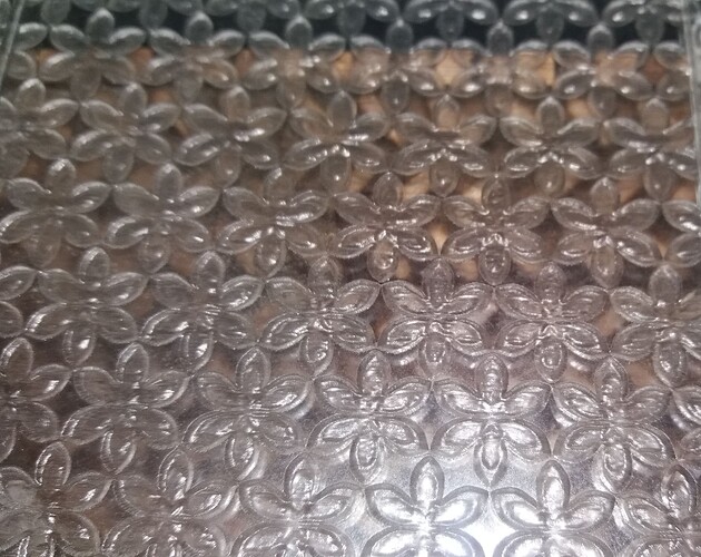

I have certainly found that using the highest LPI on acrylic can give a polished finish with this piece as a blow up of just such a result…
With this as the final result…
