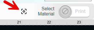

Now 3 is pretty easy. Simply find a scoring setting that will visibly mark the paper covering without going through. I see no need, though, on my machines, as after I set the focus* the laser fires exactly where it is predicted to.
focus button.

I find if I don’t use a jig, it is hard to align consecutive jobs. I will look at that button you drew an arrow to. I don’t think I have used it.
