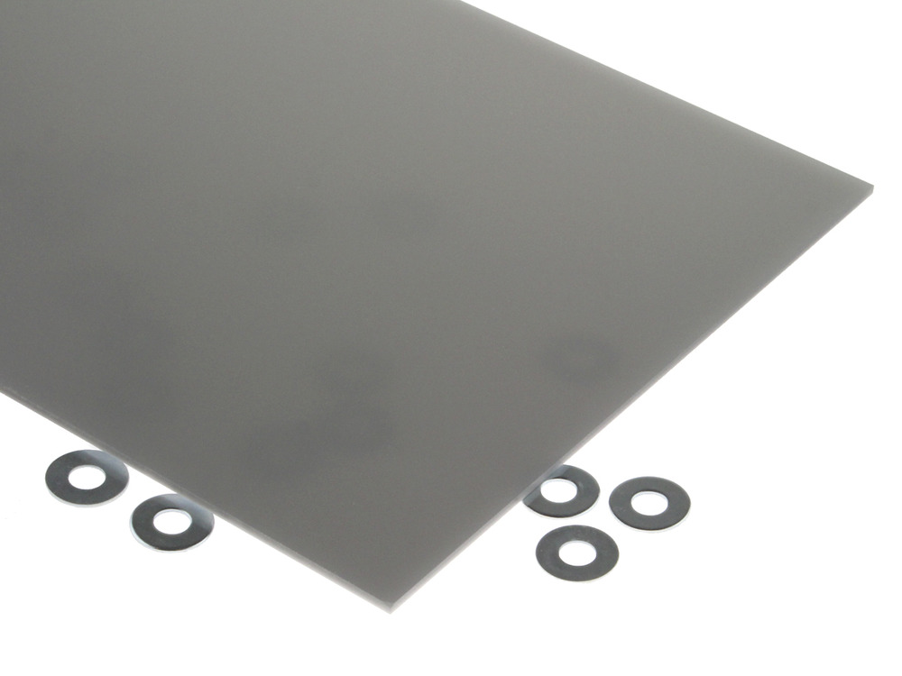

I’ll have a project where I need to engrave something and have it have a silvery metallic look to it when I’m done. It’ll likely be 1/4" thick. Haven’t decided on a material yet. Mostly because of this issue. My thinking is, and correct me if I’m wrong, if I engrave, then paint, say, wood, I’ll loose the fine detail that I just engraved. Alternatively I can’t really paint first because then I’ll be removing my paint (unless the paint’s really thick).

-Painting an engrave retains all (or nearly all) the detail.
-Use a silvery acrylic.
-Paint one color, apply mask, engrave, paint a second color through the mask, remove mask.

It appears like inventables has a laserable silver acrylic. And we will have that gift certificate.

Nifty. It’s 1/8", too. That may be my answer. I’m gonna buy some and see what I can do with it.
