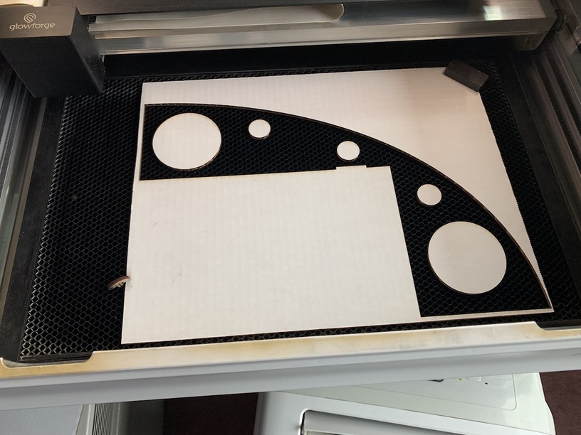

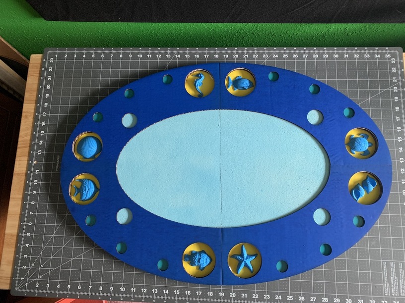

Plan B - Go for an oval with a 16:9 ratio, and give it some circle cut outs for the 3d objects, smaller ones for effect, include the measurements from the TV screen and frame, and split it into 4 pieces. This was a good exercise for using Lightburn.
Now on to the Prototype. Cut layers and repeat. Now I really want a ‘copies’ feature in GF…
There’s a couple different ‘layers’, one for the top which has an oval cut out, the next are notched for the TV frame, represented by the black foam board.

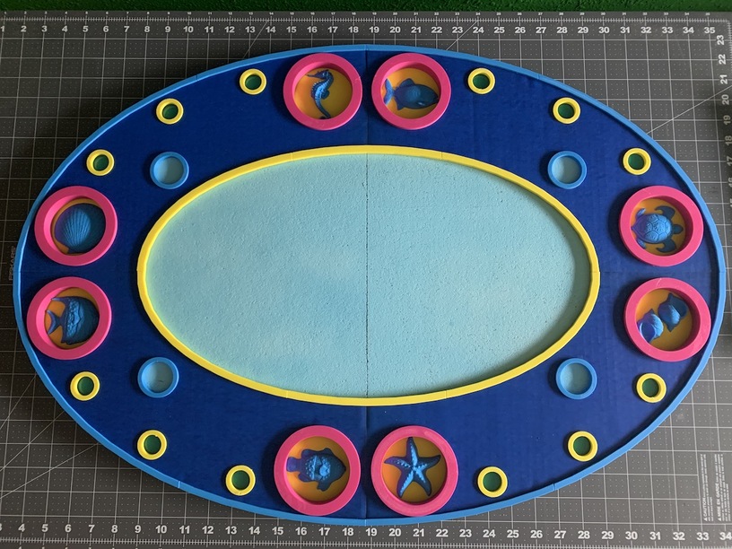

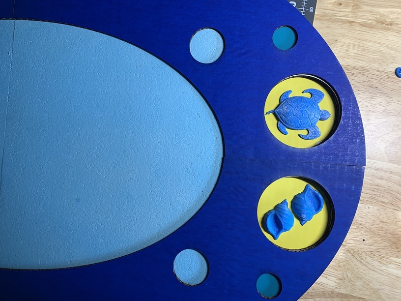

I mentioned this project was a twofer - This prototype I made into a cork board - so here’s how that went real quick, before we march on to the TV version. I taped the layers together to aid in aligning them during glue up.
Spray painted some cork panels, cut some medium teal circles for the small holes, Elmers, Elmers, and more Elmers… :slight_smile:
I outline traced and cut the back from one piece of cardboard, squashed it all together, and let it dry.
Experimented with a few different 3d ‘sealife’ objects and glued them in - Bling!
Close up -

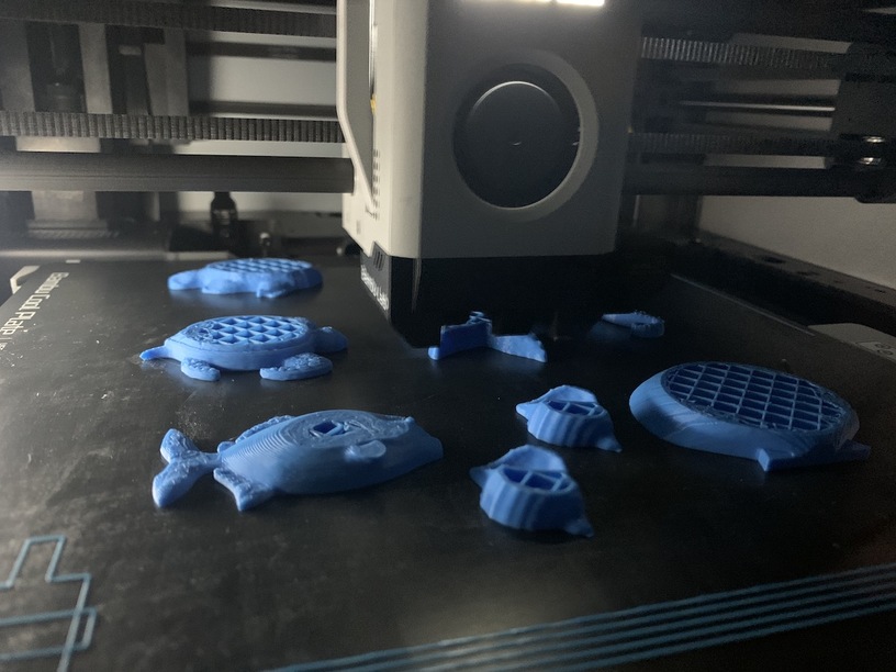

Since this version is a lot more layers, I made the Sealife taller - just waiting for the final print.
The ‘display holes’ need some grommets to make them more finished looking. I learned just enough about 3d modeling to use the Bambu Studio to make these -

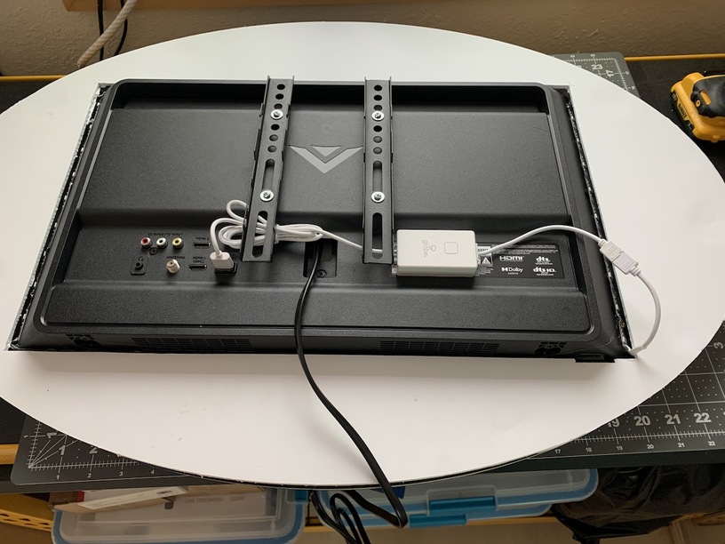

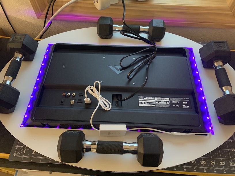

The layer just above the ‘bottom’ (black) that the sealife items glue to, I did a layer of Medium clear acrylic. I’m hoping that light from the led tape around the edge of the TV will cast through that layer and light those pockets. Fingers crossed -

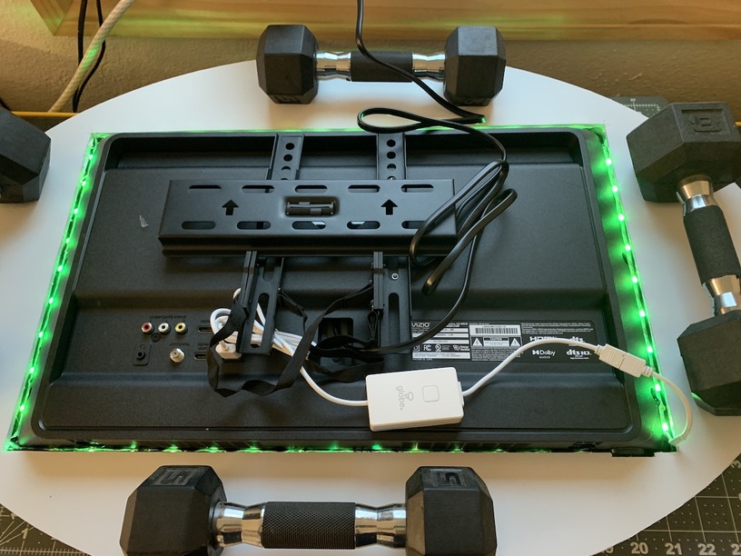

FYI - I had no idea if the USB socket on the TV would power the LED strip, or how it’s triggered. Worst case, I would just run the USB cord with the power down to a wall wart. But turns out the USB is always powered on if the TV is plugged in, even if the TV is technically ‘off’. Perfect…
Got the wall bracket mounted and the LED wiring cleaned up and done.

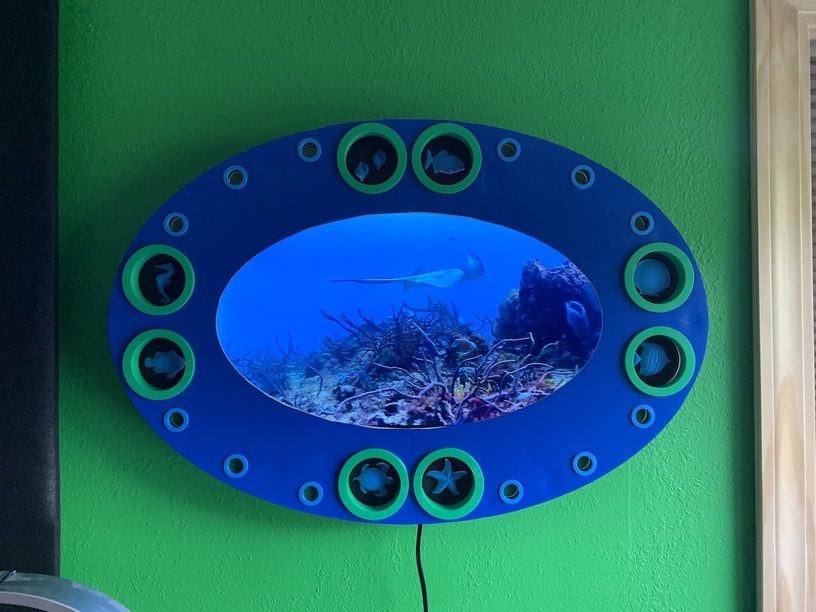

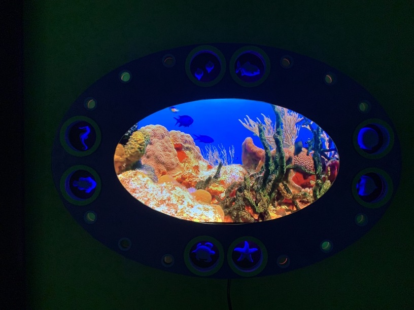

Ready to mount this thing and light it up? That is redonculous! The display hole lighting worked absolutely perfect.
Used Medium Fluorescent Green Acrylic for the small holes just for depth effect, and to look good when not lit. And final step, get the ‘Aquarium’ YouTube video going. When the room is lit, this is very pleasant to look at and pretty cool.

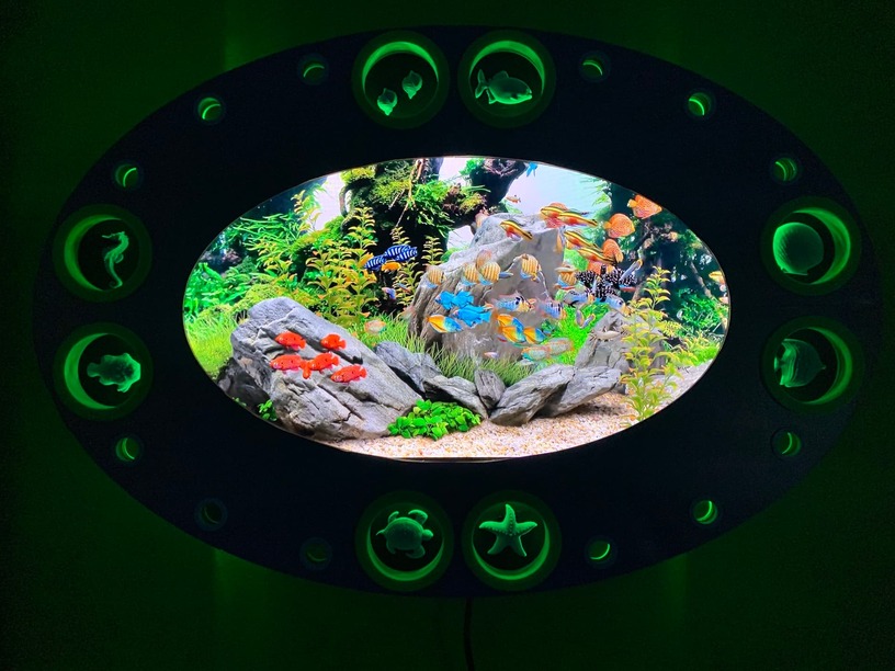

When it’s dark - This completely exceeds my expectations -

I mentioned that I did a clear acrylic layer just above the base layer the 3d items are mounted to. When I designed the hole grommets, I was sure to not go all the way to the bottom, and left them shallow by the thickness of the acrylic - Nailed it -

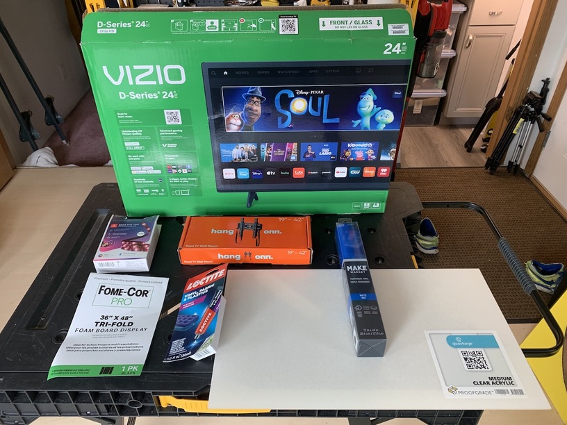

$13 1ea LED Strip light
$54 3ea 36 x 48 Foam Board
$108 1ea Vizio 24D TV
$18 2ea 12"x48" Vinyl
$68 4ea PG Medium Clear Acrylic
$14 1ea TV Wall Bracket
$10 PLA Filament
$10 Template cardboard & Elmer’s
Ok, I could have saved a ton by getting a cheap garage sale TV, and some HD Acrylic. But this is 100% worth it to me… :slight_smile:

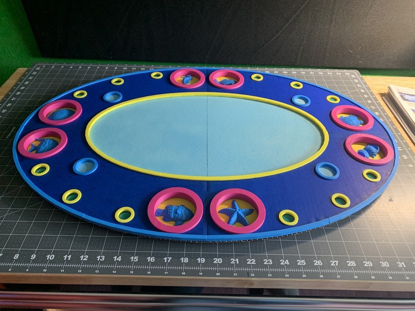

Lastly, I did an edge band trim on the inner and outer oval - to the best of my limited software & ability. :slight_smile: This is probably the cutest learning exercise I’ve done to date. I’ll resize the edges a little and reprint in different colors for the Aquarium Monitor version.
I’d call this project a (double) success. It’s still a basically ‘flat’ and layered project. But as my 3d modeling skill improves, I look forward to more projects incorporating both 3d printed and GF cut parts.
HL
Now they feel complete…
And what’s a cork board without pushpins…
