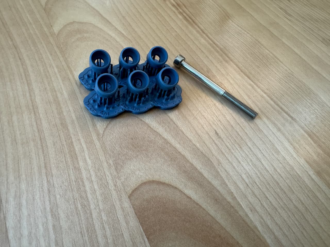

Yeah, except those panels are sheet metal (not sure if they are aluminum or steel). He said he’s seen maintenance open the panels before and there is a rail that hinges down to lock the buttons square. I have heat inserts on the project (for the case on the back) and 3D printed fake DZUS connectors for the screws in the corners (little 3D printed cups that make them look like real DZUS screws without spending $15/screw) While most DZUS screws are slot-headed, the good news when my son has sent me pictures of various panels from his jets, they must lose screws when they take it apart and replace and often the replacements are black-coated instead of zinc coated and might be phillips or hex, so my hex heads don’t look too weird.
